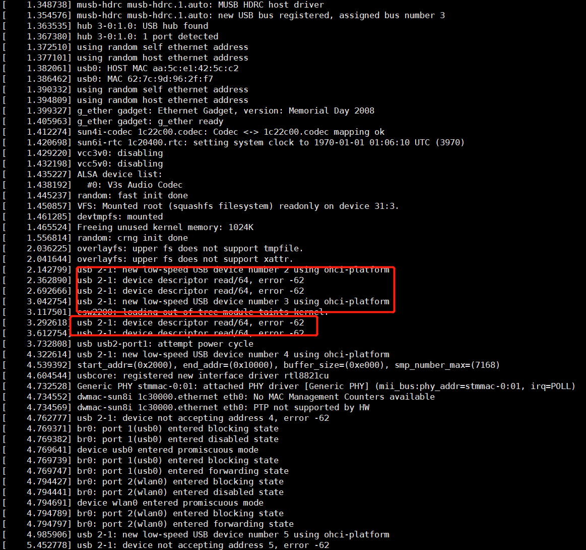

V3S USB口挂载硬盘,OTG,开启了,CLK也有开启,USB设备描述符错误
dts 有开启OTG功能, PF6也硬件上下拉了,
但是插入U盘,是设备描述符错误,这是什么原因呢?

root@ferry:/# lsusb
Bus 003 Device 001: ID 1d6b:0002
Bus 001 Device 001: ID 1d6b:0002
Bus 002 Device 001: ID 1d6b:0001
有显示的。插入U盘描述符错误。
root@ferry:/# [ 51.062591] usb 2-1: device descriptor read/64, error -62
[ 51.392592] usb 2-1: device descriptor read/64, error -62
[ 51.932597] usb 2-1: device descriptor read/64, error -62
[ 52.262605] usb 2-1: device descriptor read/64, error -62
[ 53.372606] usb 2-1: device not accepting address 4, error -62
[ 54.022587] usb 2-1: device not accepting address 5, error -62
[ 54.028526] usb usb2-port1: unable to enumerate USB device

root@ferry:/# cat /sys/module/usbcore/parameters/initial_descriptor_timeout
5000000
root@ferry:/# cat /sys/module/usbcore/parameters/old_scheme_first
Y
root@ferry:/# cat /sys/module/usbcore/parameters/use_both_schemes
N
root@ferry:/# [  341.272643] usb 2-1: device not accepting address 8, error -62
[  342.262594] usb 2-1: device not accepting address 9, error -62
[  342.268528] usb usb2-port1: unable to enumerate USB device
怀疑是硬件问题

不用怀疑, 就是硬件的问题, 可以试着在V3s的 D+/D- 旁边用导线飞一个USB座子,尽量短一点.

有一个U盘给识别到了,有点懵逼,~~ 应该是硬件走线问题

usb的D+和D-用的是等长差分走线吗?
