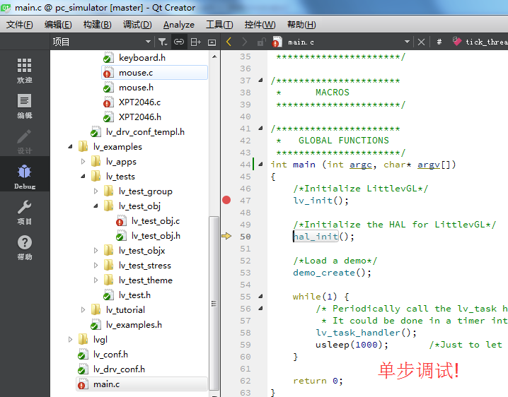

一步一步分享在Windows QtCreator/Mingw平台编译运行调试LittleVGL

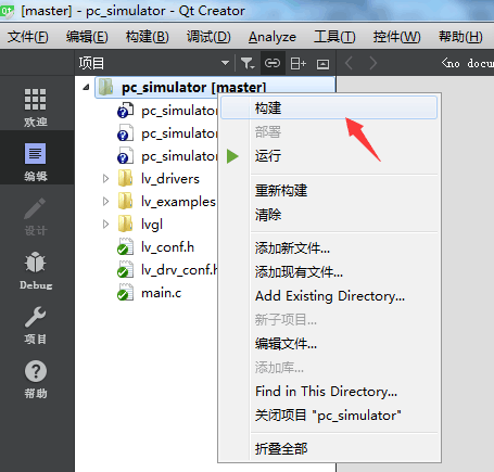

  1. 打开工程,编译。

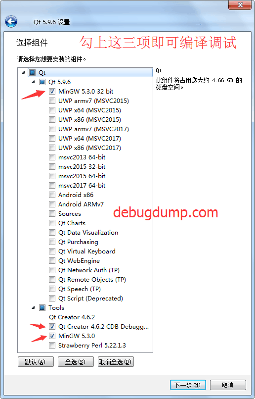

2018-08-11:
第1, 3步可以合并: 下载并安装 qt-opensource-windows-x86-5.9.6.exe, 选择 MinGW 5.3.0 32bit 即可!

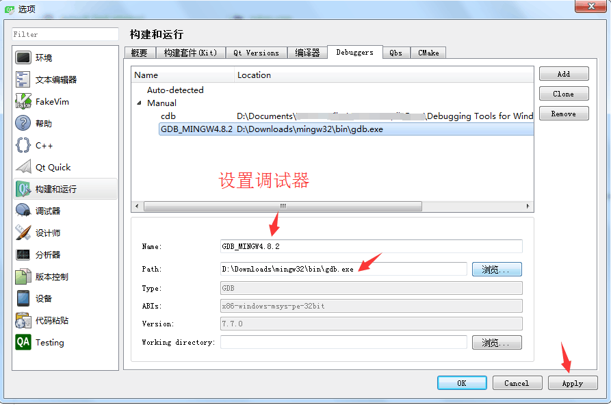

楼主 #2 2018-01-24 08:43:58
已发帖子: 9,522
Re: 一步一步分享在Windows QtCreator/Mingw平台编译运行调试LittleVGL

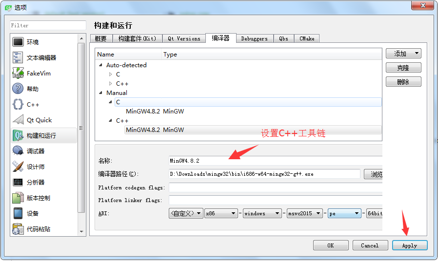

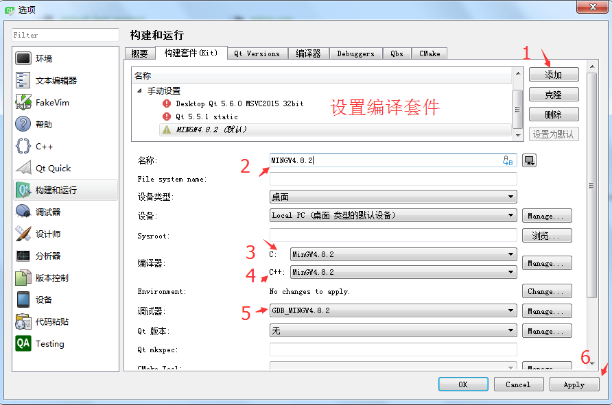

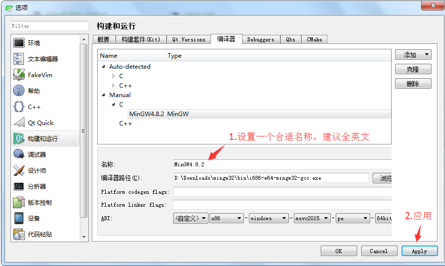

  1. 配置QtCreator mingw编译环境.
1) 设置编译工具链:
打开 【工具】->【选项】->【构建和运行】-> 【编译器】-> 【添加】->【MINGW】->【C】
打开 【工具】->【选项】->【构建和运行】-> 【编译器】-> 【添加】->【MINGW】->【C++】
2) 设置调试工具:
打开 【工具】->【选项】->【构建和运行】-> 【Debuggers】
3) 设置构建套件(Kit)
打开 【工具】->【选项】->【构建和运行】-> 【构建套件(Kit)】

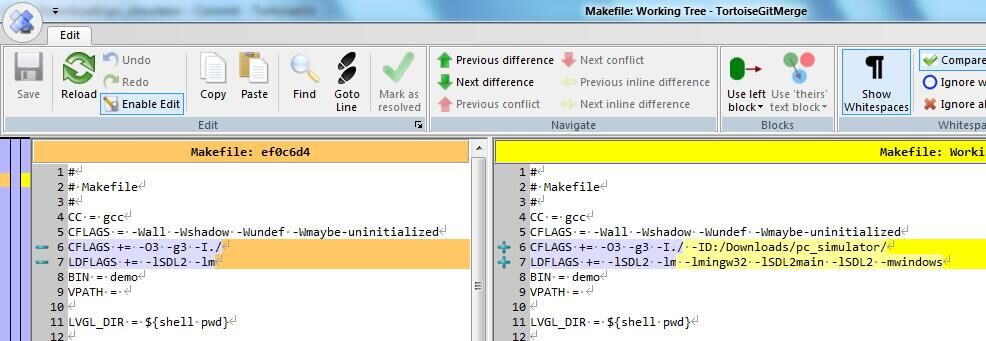

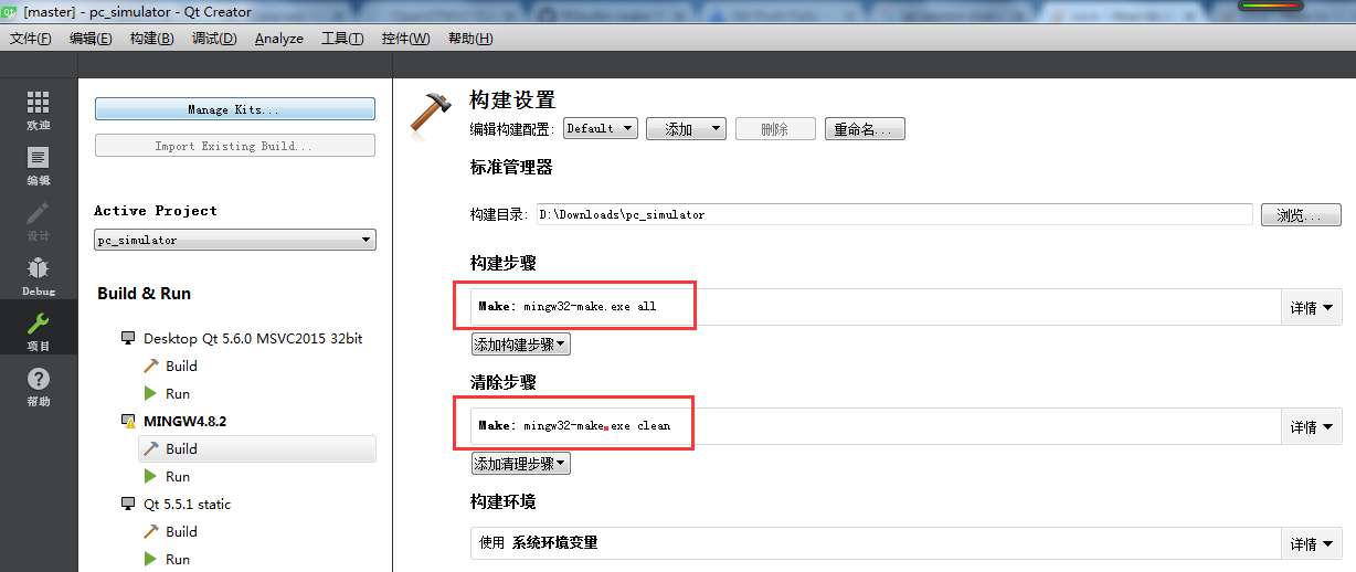

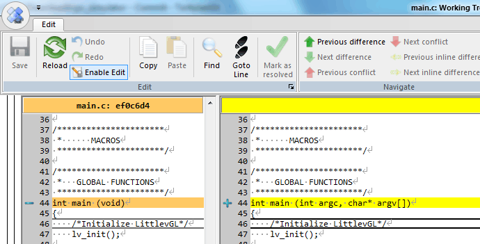

  1. 修改Makefile, 删除clean:
MAINOBJ -> OBJFILES
all: clean default
%.o: %.c
@$(CC) $(CFLAGS) -c $< -o $@
@echo "CC $<"
default: $(AOBJS) $(COBJS) $(MAINOBJ)
$(CC) -o $(BIN) $(MAINOBJ) $(AOBJS) $(COBJS) $(LDFLAGS)
clean:
rm -f $(BIN) $(AOBJS) $(COBJS) $(MAINOBJ)
  1. 修改Makefile:
CFLAGS += -O3 -g3 -I./
LDFLAGS += -lSDL2 -lm
改为
CFLAGS += -O3 -g3 -I./ -ID:/Downloads/pc_simulator/
LDFLAGS += -lSDL2 -lm -lmingw32 -lSDL2main -lSDL2 -mwindows
3.修改main.c:
int main (void)
int main (int argc, char* argv[])
楼主 #4 2018-01-24 10:13:37

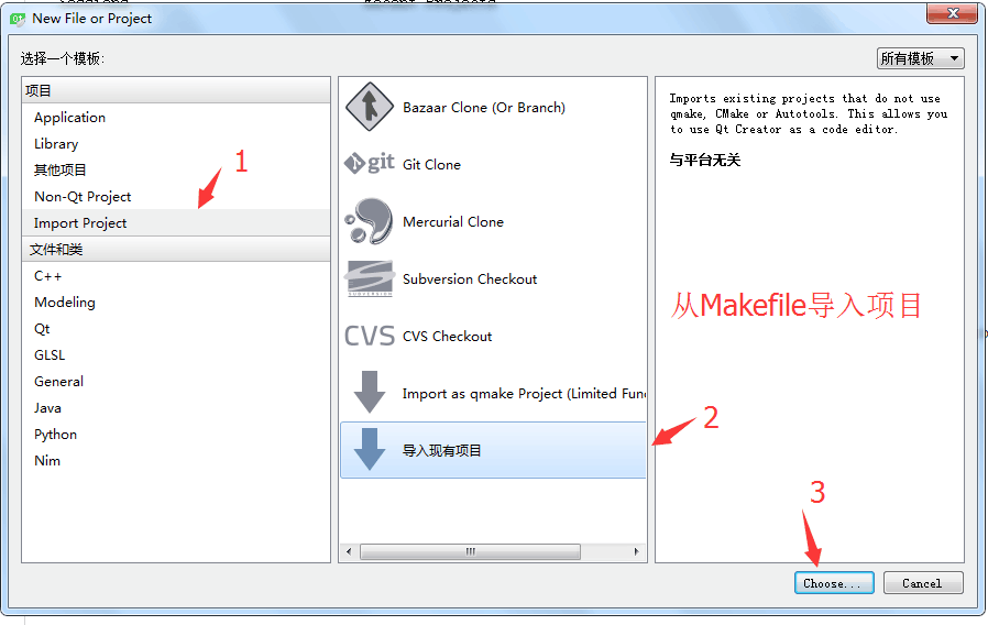

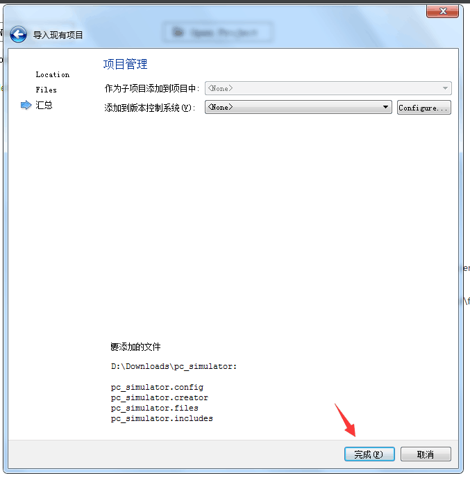

从Makefile导入工程:

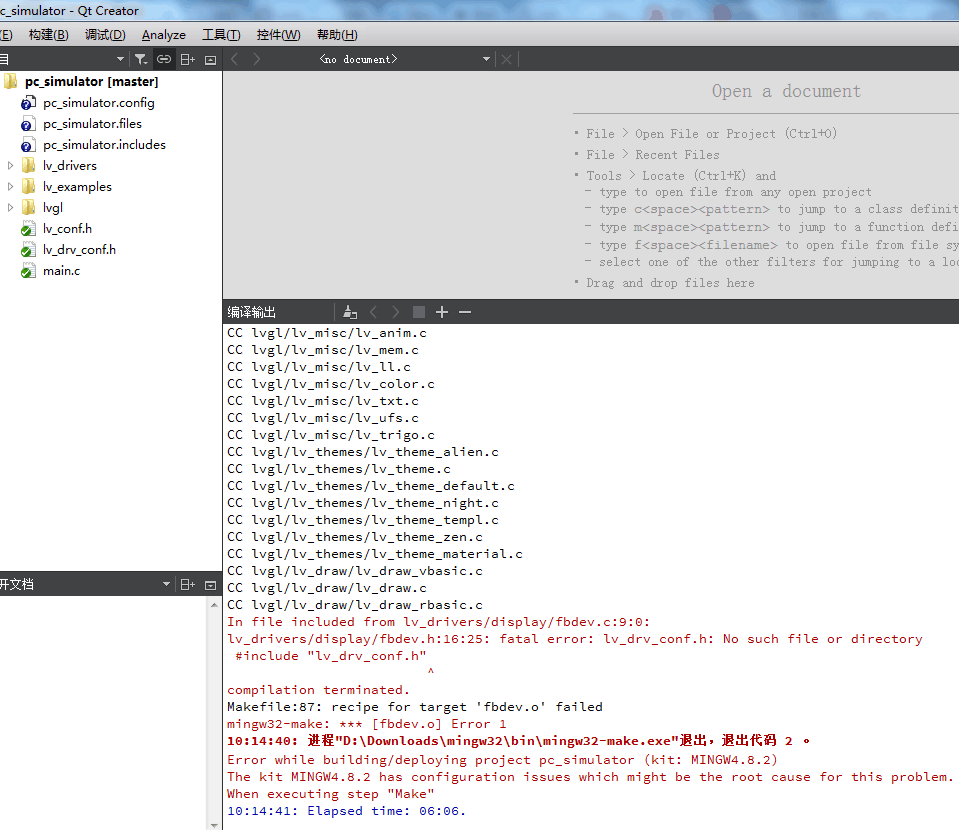

CC lvgl/lv_misc/lv_ll.c
CC lvgl/lv_misc/lv_color.c
CC lvgl/lv_misc/lv_txt.c
CC lvgl/lv_misc/lv_ufs.c
CC lvgl/lv_misc/lv_trigo.c
CC lvgl/lv_themes/lv_theme_alien.c
CC lvgl/lv_themes/lv_theme.c
CC lvgl/lv_themes/lv_theme_default.c
CC lvgl/lv_themes/lv_theme_night.c
CC lvgl/lv_themes/lv_theme_templ.c
CC lvgl/lv_themes/lv_theme_zen.c
CC lvgl/lv_themes/lv_theme_material.c
CC lvgl/lv_draw/lv_draw_vbasic.c
CC lvgl/lv_draw/lv_draw.c
CC lvgl/lv_draw/lv_draw_rbasic.c
In file included from lv_drivers/display/fbdev.c:9:0:
lv_drivers/display/fbdev.h:16:25: fatal error: lv_drv_conf.h: No such file or directory
#include "lv_drv_conf.h"
compilation terminated.
Makefile:87: recipe for target 'fbdev.o' failed
mingw32-make: *** [fbdev.o] Error 1
10:14:40: 进程"D:\Downloads\mingw32\bin\mingw32-make.exe"退出,退出代码 2 。
Error while building/deploying project pc_simulator (kit: MINGW4.8.2)
The kit MINGW4.8.2 has configuration issues which might be the root cause for this problem.
When executing step "Make"
10:14:41: Elapsed time: 06:06.
如果不修改Makefile和main.c, 编译或链接会出错,解决方案在3楼。

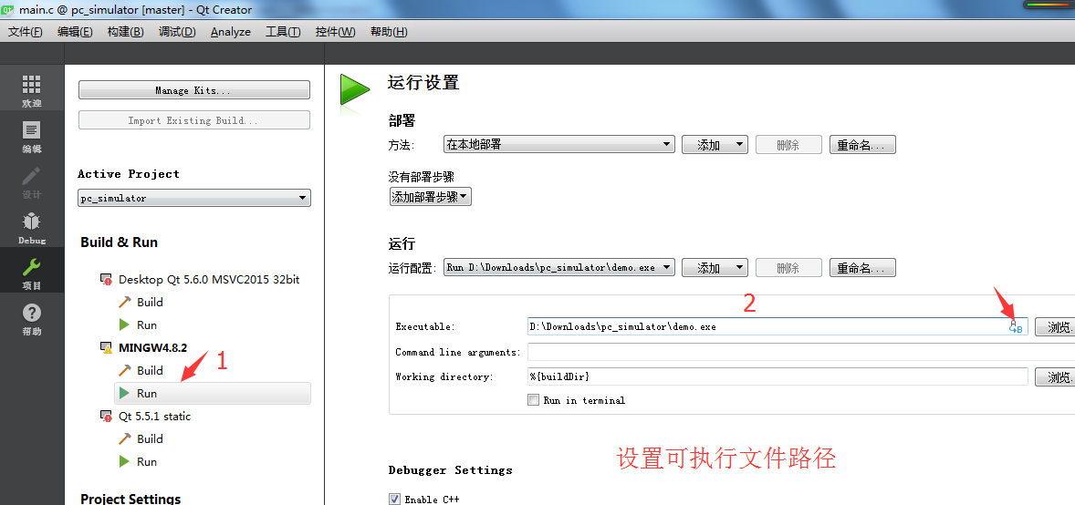

楼主 #15 2018-01-24 13:58:04
已发帖子: 9,522

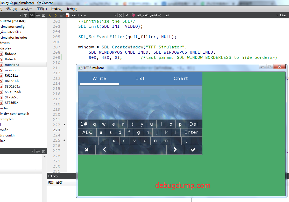

#16 2018-01-24 15:27:17
qwert1213131
注册时间: 2018-01-08
已发帖子: 57
积分: 50.5
第一次的编译速度实在是折磨人啊,太慢了,嘿嘿
终究是编译成功了,可喜可贺,感谢楼主大大
运行的时候提示出错,说找不到sdl2.dll
把i686-w64-mingw32/bin文件夹下的SDL2.dll拷贝到最外层的bin文件夹里发现成功运行了

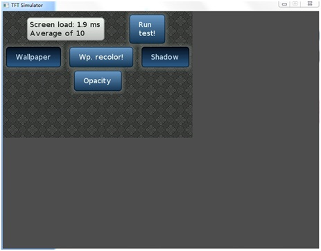

#18 2018-01-24 15:36:26
qwert1213131
注册时间: 2018-01-08
已发帖子: 57
积分: 50.5
换个有颜色的,工程里面的例程比较详细
最近编辑记录 qwert1213131 (2018-01-24 15:51:48)

:-1: error: Makefile:87: pipe: No such file or directory请问这种错误怎么搞定?
楼主 #34 2018-03-02 06:50:47
已发帖子: 9,522
你看下24楼,应该是你的路径或者软件版本不对。

哇 感谢分享 之前照官网想装eclipse的 但是mingw一直没下下来 第一次弄也不是太熟悉 还有想问一下,如果想重新全部编译呢?又要到makefile里面加上那条clean语句吗 谢谢!
楼主 #43 2018-04-12 22:39:54
已发帖子: 9,522
  1. 你按照上面的步骤删除 all 后面的 clean, 否则每次 make 的时候都要先clean, 在windows下忍受不了那个编译速度。
  2. 如果真想clean, 右击 Qt工程文件, 选择清除即可。
他的Makefile写的不好, 上面是曲线解决办法。

楼主 #50 2018-07-14 15:49:40
已发帖子: 9,522
可以直接修改 SDL_CreateWindow 这个函数的参数,
或者修改 lv_conf.h:

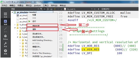

/ Horizontal and vertical resolution of the library./
#define LV_HOR_RES (800)
#define LV_VER_RES (480)
清除(clean)后再重新编译即可。

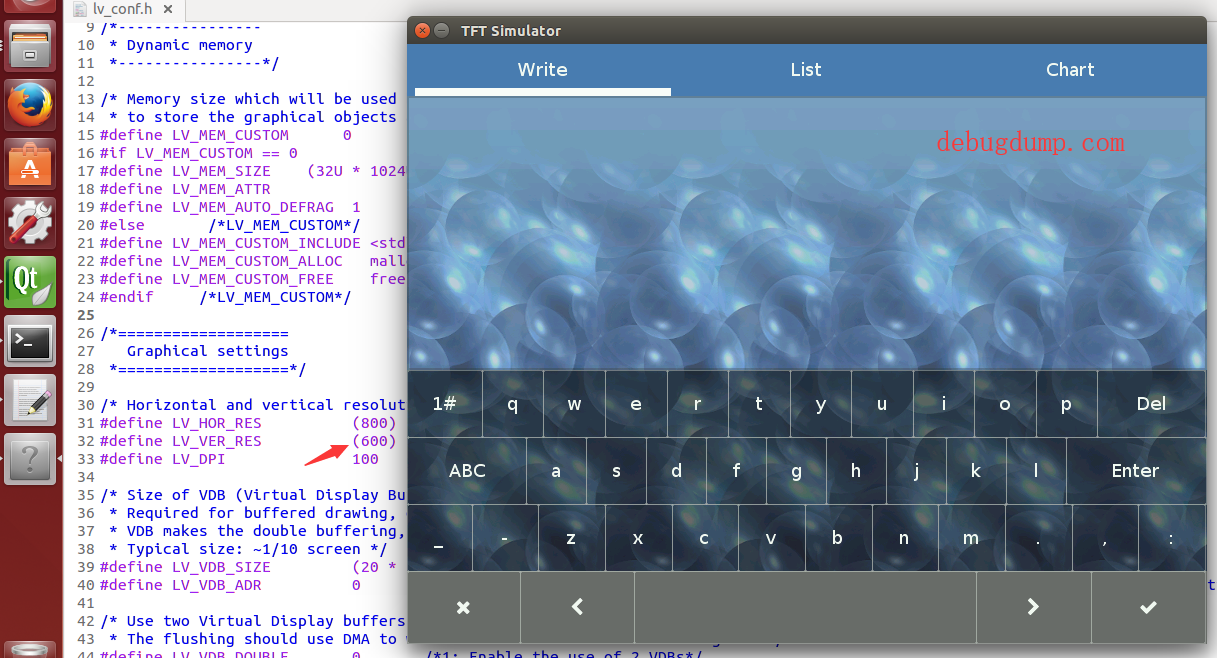

问题一:直接修改 SDL_CreateWindow 这个函数的参数,长宽设置为800X600,没有修改 lv_conf.h文件的情况下,程序运行。
窗体和程序显示的控件按比例一同变大了,显示开始有些模糊,鼠标按上面的几个按钮,基本失效。
问题二、修改 lv_conf.h文件的情况下,程序运行。修改lv_conf.h文件后,第一步清除,第二步重新构建。
窗体变大了,但显示的内容没有按比较变大。
请晕哥能不能解释一下,这两点的不同之处。
是的,你当时问我怎么改模拟器大小,我直接找创建窗口的地方,试了一下 SDL_CreateWindow 确实直接可以改模拟器窗口大小,
但是只改这里是不行的,会带来其它后遗症, 这不触摸屏就乱套了.
至于为什么要 clean再编译才能起作用晚点公布答案
因为Makefile 写得不够严谨, 比如修改了 lv_conf.h 里面的长、宽之后,应该重新编译 monitor.c, 也就是说monitor.o 应该依赖 lv_conf.h, 实际上Makefile并没有这么做。
楼主 #58 2018-07-14 23:09:56
已发帖子: 9,522
windows下gcc编译速度太慢,我在虚拟机ubuntu里面5分钟可以全部来过一次,windows半小时以上。
我试了一下修改lv_conf.h, 偷懒只删除 monitor.o, 确实和你上面的表现一致。
git clone https://github.com/littlevgl/pc_simulator.git
cd pc_simulator
git submodule update --init
make ###运行正常
./demo
make ###改 lv_config.h
./demo ###窗口放大正常
从上说明修改
#define LV_VER_RES (600)
肯定是可以的,至于为什么有问题,肯定是我们操作有问题。
