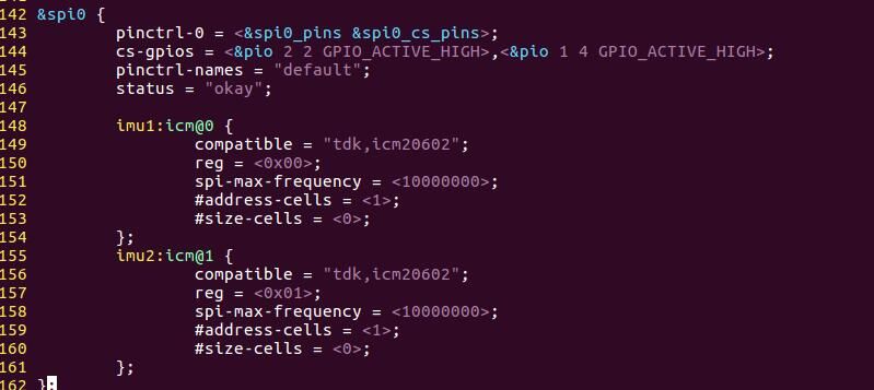

Re: H5的spi控制器驱动, 可以通过 gpio 控制 spi 片选 (转载)
在设备树的文件 arch/arm64/boot/dts/allwinner/sunxi-h3-h5.dtsi里,厂家已写好两个spi控制器相关的设备节点:
    spi0_pins: spi0 {
        function = "spi0";
    spi1_pins: spi1 {
        pins = "PA15", "PA16", "PA14", "PA13";
        function = "spi1";
spi0: spi@01c68000 {
    compatible = "allwinner,sun8i-h3-spi";
    reg = <0x01c68000 0x1000>;
    interrupts = <GIC_SPI 65 IRQ_TYPE_LEVEL_HIGH>;
    clock-names = "ahb", "mod";
    dmas = <&dma 23>, <&dma 23>;
    dma-names = "rx", "tx";
    pinctrl-names = "default";
    pinctrl-0 = <&spi0_pins>;
    resets = <&ccu RST_BUS_SPI0>;
    status = "disabled";
    #address-cells = <1>;
    #size-cells = <0>;
spi1: spi@01c69000 {
    reg = <0x01c69000 0x1000>;
    interrupts = <GIC_SPI 66 IRQ_TYPE_LEVEL_HIGH>;
    clocks = <&ccu CLK_BUS_SPI1>, <&ccu CLK_SPI1>;
    dmas = <&dma 24>, <&dma 24>;
    pinctrl-0 = <&spi1_pins>;
    resets = <&ccu RST_BUS_SPI1>;
    #size-cells = <0>;
在板级主要的设备树文件 arch/arm64/boot/dts/allwinner/sun50i-h5-nanopi-neo2.dts:
&pio {
    spi0_cs_pins: spi0_cs_pins {
        pins = "PC3", "PA6";
        function = "gpio_out";
&spi0 {
    /* needed to avoid dtc warning */
    #size-cells = <0>;
    pinctrl-0 = <&spi0_pins &spi0_cs_pins>;
    cs-gpios = <&pio 2 3 GPIO_ACTIVE_HIGH>, <&pio 0 6 GPIO_ACTIVE_HIGH>;

也就说,理论上V3s也 可以通过配置设备树, 使用 gpio 完成片选, 实现 SPI 复用。
未测试
未测试
未测试
楼主 #4 2019-07-09 17:34:38
已发帖子: 9,436
手动 up,路过有闲钱有闲心的大神可以测试一下
楼主 #5 2019-07-12 13:45:35
已发帖子: 9,436
感谢QQ群的 @龙涎香 网友, ta 在 2019/07/09 18:27:40
验证过了,是可以的,多路复用.

也就是说,我现在用SPI FLASH作为S3/V3s的存储器, 还能挂一个ST7789这种SPI LCD吗?
#9 2020-07-02 16:46:05
已发帖子: 3,394
歌以咏志 说:
可以, 亲测可用。
https://whycan.cn/t_4774.html#p48764
&pio {
                pins = "PC3", "PH6";
&spi0 {
        status ="okay";
        cs-gpios = <&pio 2 3 GPIO_ACTIVE_HIGH>, <&pio 7 6 GPIO_ACTIVE_HIGH>;
        mx25l25635e:mx25l25635e@0 {
                compatible = "jedec,spi-nor";
                reg = <0x0>;
                #size-cells = <1>;
    panel@0 {
            reg = <1>;
            reset-gpios = <&pio 2 4 GPIO_ACTIVE_HIGH>;//PC4
            dc-gpios = <&pio 2 7 GPIO_ACTIVE_LOW>;//PC7
            /*backlight = <&pwm_bl>;*/
            led-gpios = <&pio 7 0 GPIO_ACTIVE_LOW>;//PH0
            spi-cpol;
            spi-cpha;
            buswidth = <8>;
            rotate = <270>;
            rgb;
            fps = <30>;
            debug = <1>;
