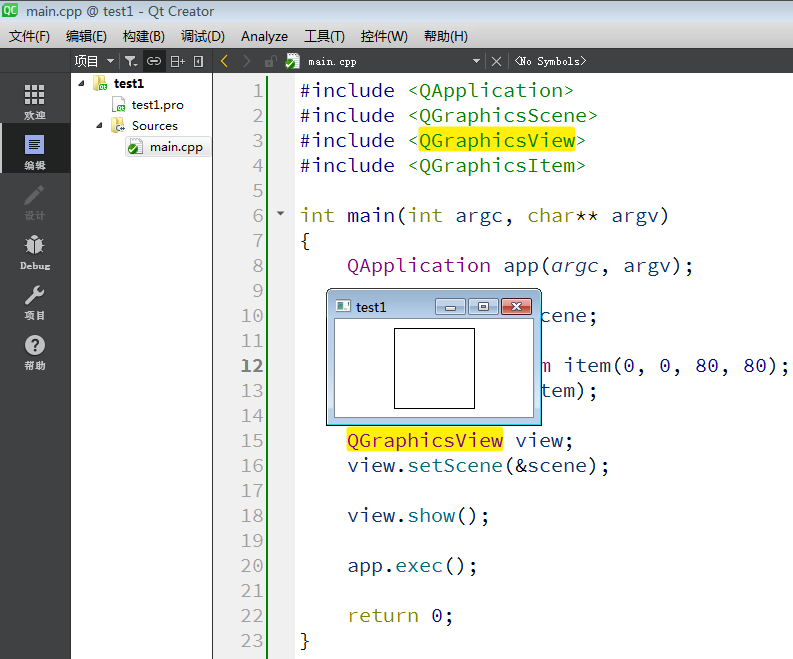

工程文件 test.pro :
TEMPLATE = app
QT += widgets
SOURCES += main.cppmain.cpp :
#include <QApplication>
#include <QGraphicsScene>
#include <QGraphicsView>
#include <QGraphicsItem>
int main(int argc, char** argv)
QApplication app(argc, argv);
QGraphicsScene scene;
QGraphicsRectItem item(0, 0, 80, 80);
scene.addItem(&item);
QGraphicsView view;
view.setScene(&scene);
view.show();
app.exec();

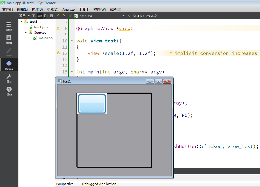

main.cpp 添加按键处理槽函数进行缩放:
#include <QPushButton>
#include <QDebug>
QGraphicsView *view;
void view_test()
view->scale(1.2f, 1.2f);
scene.setBackgroundBrush(Qt::gray);
QPushButton button;
scene.addWidget(&button);
QObject::connect(&button, &QPushButton::clicked, view_test);
view = new QGraphicsView();
view->setScene(&scene);
view->show();
app.exec();
Qt5槽函数花样比Qt4丰富:
https://wiki.qt.io/New_Signal_Slot_Syntax
