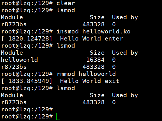

编译内核驱动,生成KO文件
简单的内核驱动
helloworld.c
#include <linux/init.h>
#include <linux/module.h>
MODULE_LICENSE("GPL");
static int hello_init(void)
	printk(KERN_INFO " Hello World enter\n");//打印级别+打印信息
static void hello_exit(void)
	printk(KERN_INFO " Hello World exit\n");//打印级别+打印信息
//安装模块做什么
module_init(hello_init);
//卸载模块做什么
module_exit(hello_exit);
//模块信息
MODULE_AUTHOR("ephraim");
MODULE_DESCRIPTION("A simple Hello World Module");
MODULE_ALIAS("a simplest module");
Makefile
ifneq ($(KERNELRELEASE),)
#kbuild syntax. dependency relationshsip of files and target modules are listed here.
obj-m := helloworld.o
else
PWD:= $(shell pwd)
KDIR := /home/lzq/desktop/linux-5.10
all:
        $(MAKE) -C $(KDIR) M=$(PWD) modules
clean:
        rm -rf .*.cmd *.o *.mod.c *.ko .tmp_versions
endif
make一下生成helloworld.ko
结果
