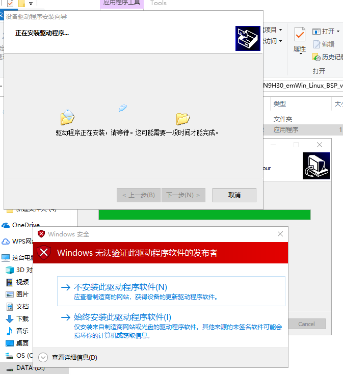

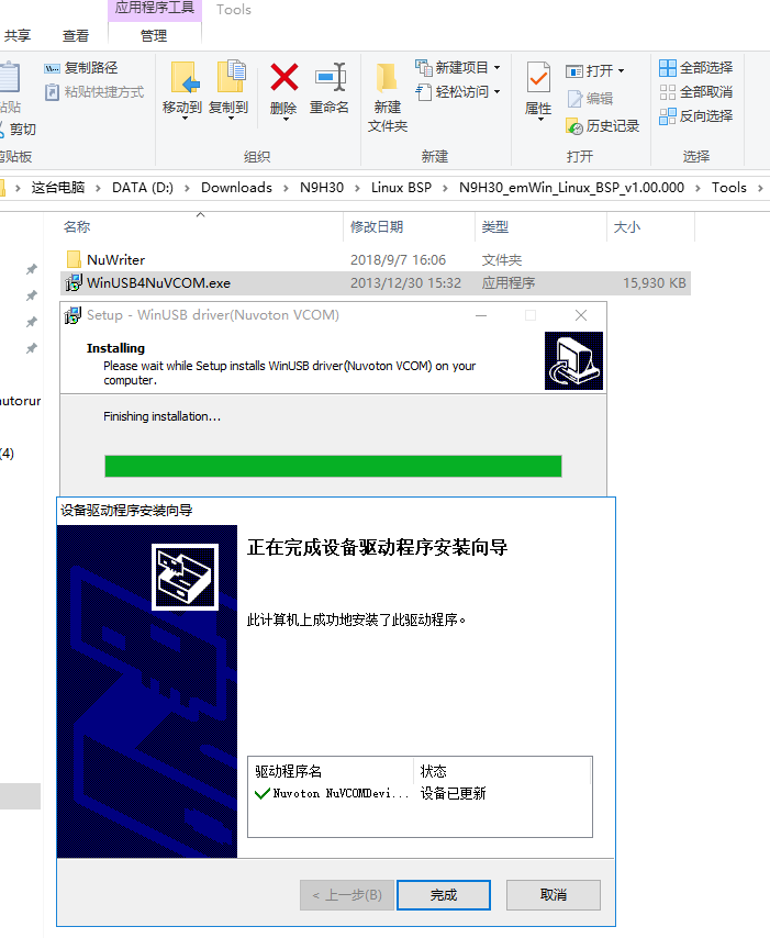

终于把烧录的驱动给装上了
根据百度经验这个帖子: https://jingyan.baidu.com/article/624e74594dbc8d34e8ba5aa6.html
禁用 win10 驱动签名, 终于搞定, 请问驱动签名到底是什么鬼?

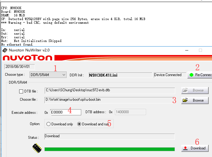

u-boot 的运行地址是 0xE00000

楼主的做法只能重启后一次禁用驱动签名。
Win10 可以用久禁用签名:
永久禁用可以在提示符后面输入bcdedit.exe /set nointegritychecks on后回车,
开启数字签名的话bcdedit.exe /set nointegritychecks off回车

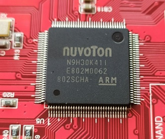

折腾了两天, 这个 N9H30K41I 怎么样也没跑起 Linux.
打开手册一看:
http://www.nuvoton.com/resource-files/HMI-N9H30_User_Manual_EN_Rev1.0.pdf
INTRODUCTION TO NUDESIGN-HMI-N9H30 BOARD
The NuDesign-HMI-N9H30 solution uses an outstanding CPU core ARM926EJ-S, N9H30K41I
which runs up to 300 MHz and features the embedded 16MB DDR memory, with 16 KB I-cache,
16 KB D-cache and MMU, 56 KB embedded SRAM and 16 KB IBR (Internal Boot ROM) for
booting from SPI Flash or booting from NAND Flash.
The NuDesign-HMI-N9H30 solution integrates touchscreen display, voice input/output, rich serial
port service and I/O interface, providing multiple external storage methods. It contains two kinds
of board, including the NuDesign-HMI-N9H30 board and NuDesign-TFT-LCD5 board.
这坑货才 16M DDR, 赶紧联系供应商换板子。

8M DRAM 的 n32903 都可以跑 linux,
https://whycan.cn/t_2258.html#p16569
看下是不是配置可以改下跑起来

Win10 可以用久禁用签名:
事实证明, 没有没有用, 还得一步一步去做: https://jingyan.baidu.com/article/624e74594dbc8d34e8ba5aa6.html
