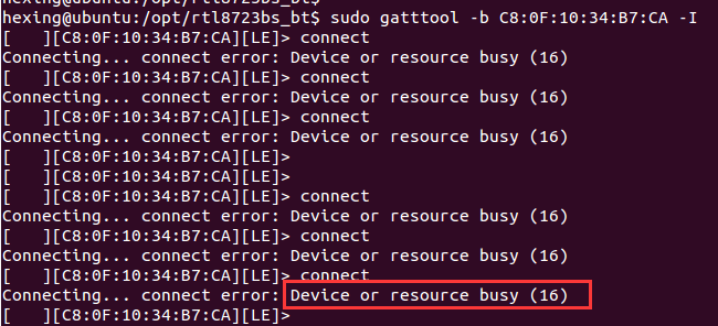

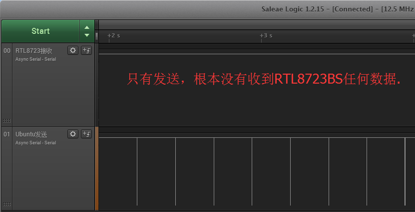

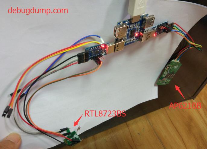

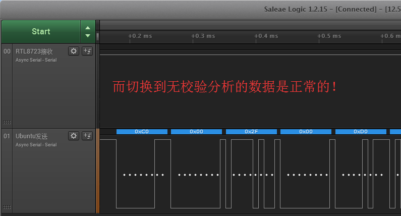

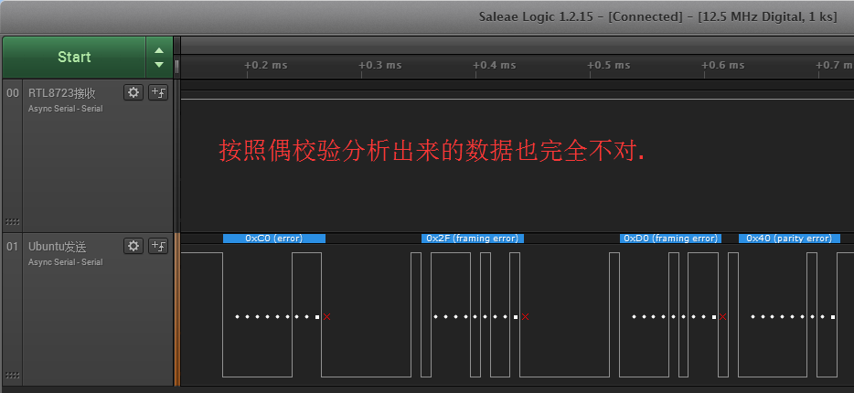

郁闷,没有搞定 Ubuntu下用btstack协议栈驱动 RTL8723BS
参考链接: http://www.ti.com/lit/ds/swrs121e/swrs121e.pdf
参考链接: https://whycan.cn/t_637.html

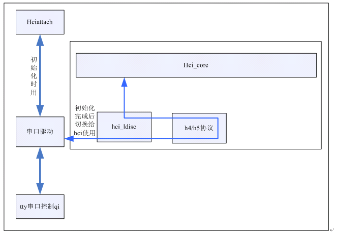

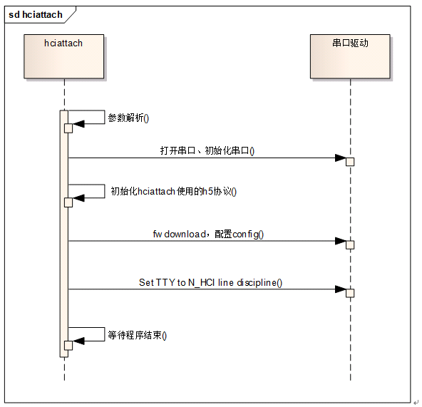

修改 hciattach.c
在 printf("Device setup complete\n"); 后添加:
close(n);
删除:
if (ioctl(fd, HCIUARTSETPROTO, u->proto) < 0) {
        perror("Can't set device");
        return -1;
删除:
/* Restore TTY line discipline */
    ld = N_TTY;
    if (ioctl(n, TIOCSETD, &ld) < 0) {
        perror("Can't restore line discipline");
        exit(1);

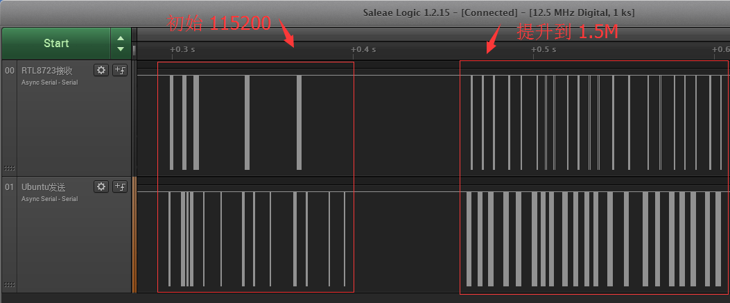

让rtl8723bs 更新固件, 运行命令:
sudo ./rtk_hciattach -n -s 115200 /dev/ttyUSB1 rtk_h5
输出log:
xxx@ubuntu:/opt/ap6210$ sudo ./brcm_patchram_plus -d  --patchram bcm20710a1.hcd --bd_addr 11:22:33:44:55:66 --no2bytes --tosleep 1000 /dev/ttyUSB1
Realtek Bluetooth init uart with init speed:115200, final_speed:115200, type:HCI UART H5
Realtek Bluetooth :Realtek hciattach version 2.5
Realtek Bluetooth :3-wire sync pattern resend : 1, len: 8
Realtek Bluetooth :Get SYNC Resp Pkt
Realtek Bluetooth :Get SYNC pkt-active mode
Realtek Bluetooth :3-wire config pattern resend : 1 , len: 10
Realtek Bluetooth :Get CONFG pkt-active mode
Realtek Bluetooth :Get CONFG resp pkt-active mode
Realtek Bluetooth :H5 init finished

楼主 #7 2018-05-07 13:49:00
已发帖子: 9,424
Re: 郁闷,没有搞定 Ubuntu下用btstack协议栈驱动 RTL8723BS
gatttools 用 AP6201B 和 RTL8723BS 永远都是 connect error: Device or resource busy (16)

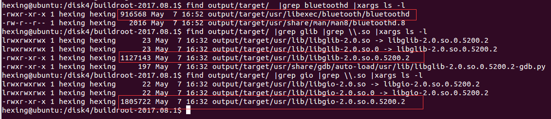

光这三个文件加起来就有 4M, bluez 太重量级了, 只能想办法用轻量级协议栈。

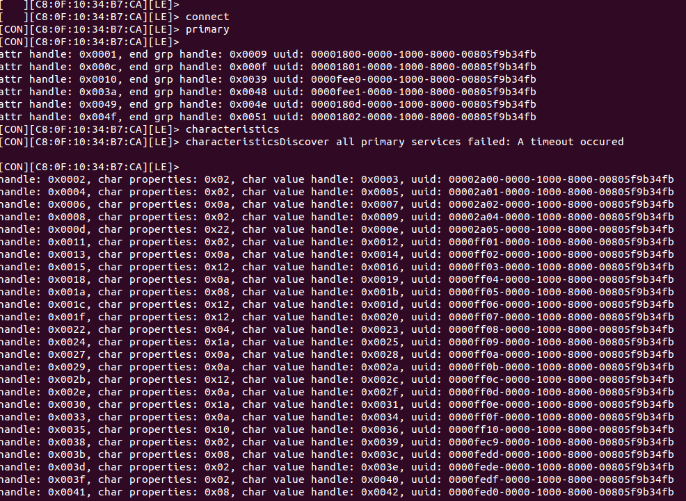

楼主 #11 2018-05-07 20:57:33
已发帖子: 9,424
https://whycan.cn/files/members/3/QQ20180507134225.png
RRRR@ubuntu:/disk5$ sudo gatttool -b C8:0F:10:34:B7:CA -I
[   ][C8:0F:10:34:B7:CA][LE]> connect
[CON][C8:0F:10:34:B7:CA][LE]> primary
attr handle: 0x0001, end grp handle: 0x0009 uuid: 00001800-0000-1000-8000-00805f9b34fb
attr handle: 0x000c, end grp handle: 0x000f uuid: 00001801-0000-1000-8000-00805f9b34fb
attr handle: 0x0010, end grp handle: 0x0039 uuid: 0000fee0-0000-1000-8000-00805f9b34fb
attr handle: 0x003a, end grp handle: 0x0048 uuid: 0000fee1-0000-1000-8000-00805f9b34fb
attr handle: 0x0049, end grp handle: 0x004e uuid: 0000180d-0000-1000-8000-00805f9b34fb
attr handle: 0x004f, end grp handle: 0x0051 uuid: 00001802-0000-1000-8000-00805f9b34fb
[CON][C8:0F:10:34:B7:CA][LE]> characteristics
handle: 0x0002, char properties: 0x02, char value handle: 0x0003, uuid: 00002a00-0000-1000-8000-00805f9b34fb
handle: 0x0004, char properties: 0x02, char value handle: 0x0005, uuid: 00002a01-0000-1000-8000-00805f9b34fb
handle: 0x0006, char properties: 0x0a, char value handle: 0x0007, uuid: 00002a02-0000-1000-8000-00805f9b34fb
handle: 0x0008, char properties: 0x02, char value handle: 0x0009, uuid: 00002a04-0000-1000-8000-00805f9b34fb
handle: 0x000d, char properties: 0x22, char value handle: 0x000e, uuid: 00002a05-0000-1000-8000-00805f9b34fb
handle: 0x0011, char properties: 0x02, char value handle: 0x0012, uuid: 0000ff01-0000-1000-8000-00805f9b34fb
handle: 0x0013, char properties: 0x0a, char value handle: 0x0014, uuid: 0000ff02-0000-1000-8000-00805f9b34fb
handle: 0x0015, char properties: 0x12, char value handle: 0x0016, uuid: 0000ff03-0000-1000-8000-00805f9b34fb
handle: 0x0018, char properties: 0x0a, char value handle: 0x0019, uuid: 0000ff04-0000-1000-8000-00805f9b34fb
handle: 0x001a, char properties: 0x08, char value handle: 0x001b, uuid: 0000ff05-0000-1000-8000-00805f9b34fb
handle: 0x001c, char properties: 0x12, char value handle: 0x001d, uuid: 0000ff06-0000-1000-8000-00805f9b34fb
handle: 0x001f, char properties: 0x12, char value handle: 0x0020, uuid: 0000ff07-0000-1000-8000-00805f9b34fb
handle: 0x0022, char properties: 0x04, char value handle: 0x0023, uuid: 0000ff08-0000-1000-8000-00805f9b34fb
handle: 0x0024, char properties: 0x1a, char value handle: 0x0025, uuid: 0000ff09-0000-1000-8000-00805f9b34fb
handle: 0x0027, char properties: 0x0a, char value handle: 0x0028, uuid: 0000ff0a-0000-1000-8000-00805f9b34fb
handle: 0x0029, char properties: 0x0a, char value handle: 0x002a, uuid: 0000ff0b-0000-1000-8000-00805f9b34fb
handle: 0x002b, char properties: 0x12, char value handle: 0x002c, uuid: 0000ff0c-0000-1000-8000-00805f9b34fb
handle: 0x002e, char properties: 0x0a, char value handle: 0x002f, uuid: 0000ff0d-0000-1000-8000-00805f9b34fb
handle: 0x0030, char properties: 0x1a, char value handle: 0x0031, uuid: 0000ff0e-0000-1000-8000-00805f9b34fb
handle: 0x0033, char properties: 0x0a, char value handle: 0x0034, uuid: 0000ff0f-0000-1000-8000-00805f9b34fb
handle: 0x0035, char properties: 0x10, char value handle: 0x0036, uuid: 0000ff10-0000-1000-8000-00805f9b34fb
handle: 0x0038, char properties: 0x02, char value handle: 0x0039, uuid: 0000fec9-0000-1000-8000-00805f9b34fb
handle: 0x003b, char properties: 0x08, char value handle: 0x003c, uuid: 0000fedd-0000-1000-8000-00805f9b34fb
handle: 0x003d, char properties: 0x02, char value handle: 0x003e, uuid: 0000fede-0000-1000-8000-00805f9b34fb
handle: 0x003f, char properties: 0x02, char value handle: 0x0040, uuid: 0000fedf-0000-1000-8000-00805f9b34fb
handle: 0x0041, char properties: 0x08, char value handle: 0x0042, uuid: 0000fed0-0000-1000-8000-00805f9b34fb
handle: 0x0043, char properties: 0x08, char value handle: 0x0044, uuid: 0000fed1-0000-1000-8000-00805f9b34fb
handle: 0x0045, char properties: 0x02, char value handle: 0x0046, uuid: 0000fed2-0000-1000-8000-00805f9b34fb
handle: 0x0047, char properties: 0x08, char value handle: 0x0048, uuid: 0000fed3-0000-1000-8000-00805f9b34fb
handle: 0x004a, char properties: 0x10, char value handle: 0x004b, uuid: 00002a37-0000-1000-8000-00805f9b34fb
handle: 0x004d, char properties: 0x0a, char value handle: 0x004e, uuid: 00002a39-0000-1000-8000-00805f9b34fb
handle: 0x0050, char properties: 0x04, char value handle: 0x0051, uuid: 00002a06-0000-1000-8000-00805f9b34fb
问题已经解决,
原来是手环被 小米运动 app占用了,
把手机蓝牙禁用问题就解决了。

终于找到了设置波特率到 1.5Mbps的地方, 开始我以为和AP6210B那个套路一样,在命令行参数设定,后来发现根本不是。
跟踪 hciattach_rtk.c    rtk_parse_config_file() 函数,
打开这个文件 /lib/firmware/rtl_bt/rtlbt_config
改成 14 C0 52 02 即为 115200 波特率,
即对应代码中的
{0x0252C014, 115200}
用逻辑分析仪观察, 全程 115200 了.

还真是一点反应都没有,
然后进入看逻辑分析仪:

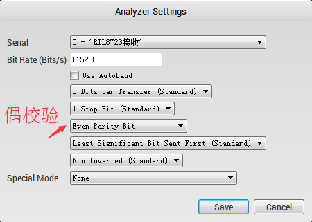

立刻想到了 打开 串口的姿势不正确.
楼主 #15 2018-05-08 10:31:27
已发帖子: 9,424
然而并没有找到设置 open /dev/ttySXXX 的地方.
只好放狗搜索了: https://www.google.com/search?q=btstack+even+parity
楼主 #16 2018-05-08 10:32:41
已发帖子: 9,424
找到这个页面:  https://bluekitchen-gmbh.com/btstack/chipsets/
BCSP
The predecessor of H5. The main difference to H5 is that Even Parity is used for BCSP. To use BCSP with BTstack, you use the H5 transport and can call hci_transport_h5_enable_bcsp_mode
看能不能发现一些端倪。

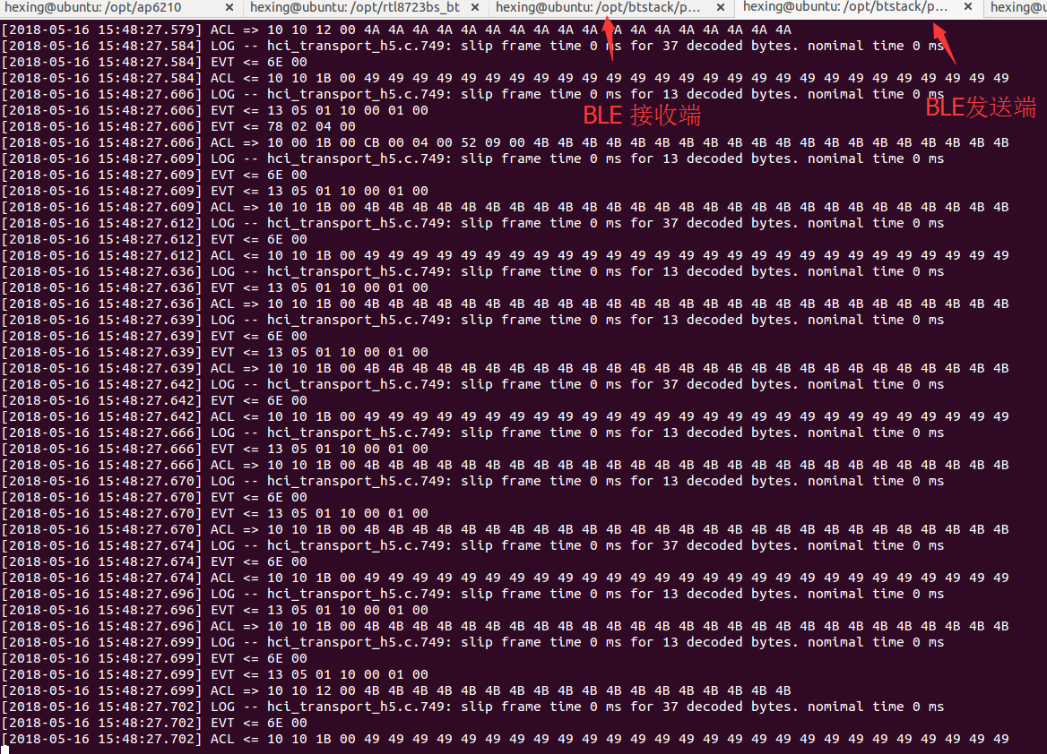

用 btstack 自带的 le_streamer 接收数据, le_streamer_client 发送数据, 正常运行。

读了下源码,发现这个文章讲得比较清晰。  https://blog.csdn.net/zjli321/article/details/52122447
uart接口蓝牙驱动框图
hciattach初始化流程
uart接口蓝牙的fw download及config配置工作也放到了应用层,这些工作都是由hciattach来实现。串口的使用有一个切换的过程,在初始化的时候,由hciattach使用串口,初始化完成后,把串口切换给hci使用,hci负责与串口交互蓝牙数据,中间还经过了h4/h5协议层,驱动层跟移植相关只有h4/h5协议,若h4/h5使用的是内核自带的协议,那驱动层就不需要做任何的工作。 只有uart接口的蓝牙才需要hciattach工具,hciattach的作用为配置串口,下载fw及config文件,把串口切换给hci_ldisc使用。
楼主 #34 2018-05-20 12:16:04
已发帖子: 9,424
不错,这个图确实比较直观。

[00:08:38.922] LOG -- hci_transport_h5.c.749: slip frame time 7 ms for 947 decoded bytes. nomimal time 6 ms
[00:08:38.946] LOG -- hci_transport_h5.c.749: slip frame time 6 ms for 766 decoded bytes. nomimal time 5 ms
[00:08:38.946] LOG -- hci_transport_h5.c.556: expected payload len 941 but got 760
[00:08:39.066] LOG -- hci_transport_h5.c.749: slip frame time 120 ms for 947 decoded bytes. nomimal time 6 ms
[00:08:39.076] LOG -- hci_transport_h5.c.749: slip frame time 8 ms for 947 decoded bytes. nomimal time 6 ms
[00:08:39.088] LOG -- hci_transport_h5.c.749: slip frame time 9 ms for 947 decoded bytes. nomimal time 6 ms
[00:08:39.113] LOG -- hci_transport_h5.c.749: slip frame time 22 ms for 947 decoded bytes. nomimal time 6 ms
[00:08:39.123] LOG -- hci_transport_h5.c.749: slip frame time 7 ms for 947 decoded bytes. nomimal time 6 ms

正在搞这个协议栈,mark一下
#83 2020-03-20 14:41:41
木子猫
注册时间: 2018-03-27
已发帖子: 63
积分: 22.5
先初始化RTL8723BS:
运行btstack测试程序:
还真是一点反应都没有,
然后进入看逻辑分析仪:
https://whycan.cn/files/members/3/QQ20180508102753.png
https://whycan.cn/files/members/3/QQ20180508102849.png
https://whycan.cn/files/members/3/QQ20180508102928.png
立刻想到了 打开 串口的姿势不正确.
这个最后怎么解决的呢 现在也是卡在EVT <= 60 01 01  后面就不动了
