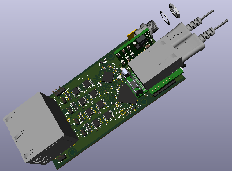

here's a 3D of a pre-production SSD212 design. considering jumping to F133-A ...

after years of fighting flash/ram sizes in MCU (PIC32, PSOC5, XMC4500, etc) the ability to program/buffer in a 64MB memory is unbelievable. we've had 10Base-T, then 100Base-T but very few MCU have 1000Base-T. one thing we fight in professional lighting displays is latency so the faster/wider the pipelines the better. we use an FPGA to take a buffer of lighting data and custom generate peripherals that are tailored to the pixel protocols. no need for fooling spi/uart to do the job with our custom drivers nailed to the protocol. not the only way to get there, just a path we are taking. we are near production on SSD212 products but they have been so difficult to work with on documentation. porting the drivers from linux to freertos when you don't know the register bits has been a pain in the ....
just our humble opinion after many years of product development.

What bits do you need to know about the SSD212.
Most of it is the same as the other SSDxxx chips. I have linux 5.15 running on it with some minor changes for the new GPIO.
Also we have the kernel, u-boot etc sources now.
