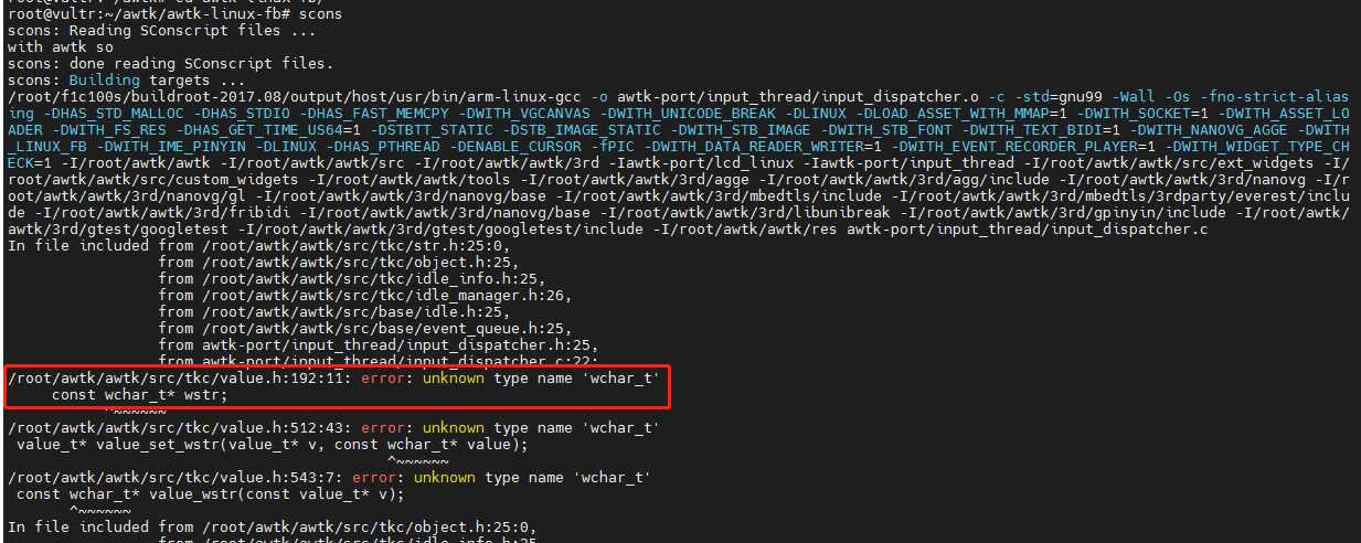

编译AWTK,提示error: unknown type name 'wchar_t' 如何处理
如下图所示:
unknown type name wchar_t

wchar_t is defined in stddef.h. Your header file needs to #include <stddef.h>.
https://github.com/rust-lang/rust-bindgen/issues/1406
谢谢晕哥 搞定 但是又有新的问题了,
build/var/awtk/src/base/text_edit.c:22:20: fatal error: wctype.h: No such file or directory
