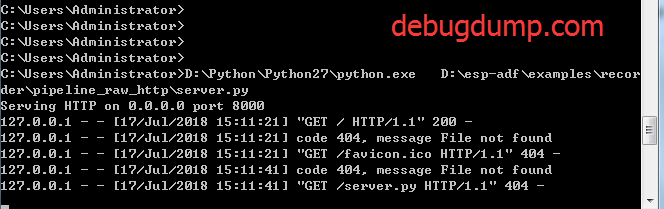

#8 2018-07-17 15:27:25
已发帖子: 9,435
Re: 录音上传,adf中的pipeline_raw_http,如何搭建一个可以看到上传的录音服务器。
随便试了一下, 貌似没什么问题:
1. 下载: python-2.7.9.amd64.msi, 安装.
2. 执行 D:\Python\Python27\python.exe   D:\esp-adf\examples\recorder\pipeline_raw_http\server.py
C:\Users\Administrator>D:\Python\Python27\python.exe   D:\esp-adf\examples\recorder\pipeline_raw_http\server.py
Serving HTTP on 0.0.0.0 port 8000
127.0.0.1 - - [17/Jul/2018 15:11:21] "GET / HTTP/1.1" 200 -
127.0.0.1 - - [17/Jul/2018 15:11:21] code 404, message File not found
127.0.0.1 - - [17/Jul/2018 15:11:21] "GET /favicon.ico HTTP/1.1" 404 -
127.0.0.1 - - [17/Jul/2018 15:11:41] code 404, message File not found
127.0.0.1 - - [17/Jul/2018 15:11:41] "GET /server.py HTTP/1.1" 404 -
