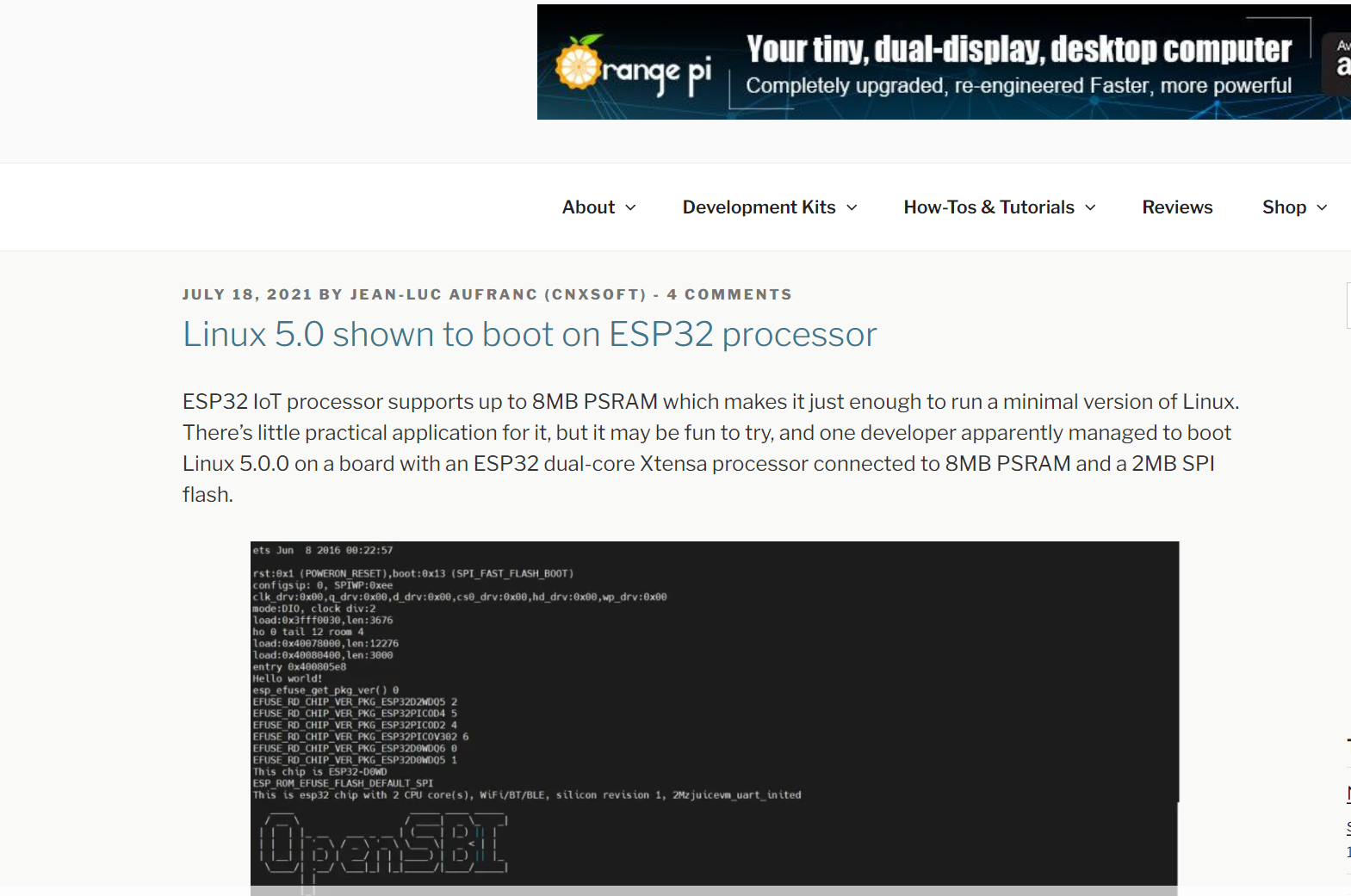

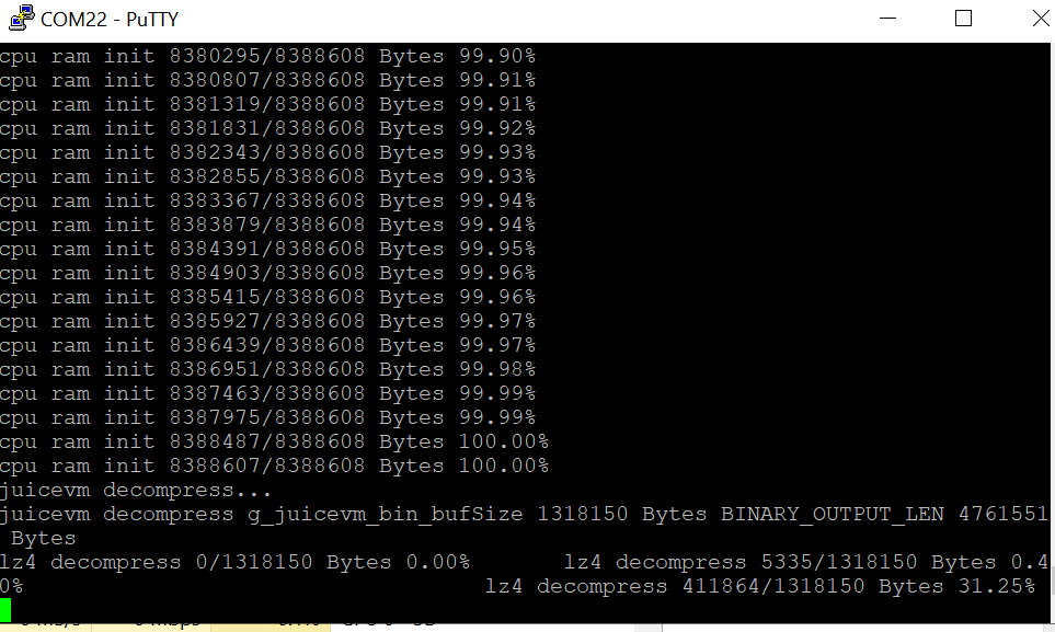

juiceVm risc-v虚拟机在esp32上运行linux kernel
RT.
有图有真相,固件在文章末尾
运行环境:
esp32 devkit v1开发板:
外置 2MB flash.
外接 spi psram 8MB:
psram spi interface info:
CS:4,CLK:5,MOSI:18,MISO:19
固件下载信息:
Compressed 1583728 bytes to 1294532...
Wrote 1583728 bytes (1294532 compressed) at 0x00001000 in 33.1 seconds (effective 382.7 kbit/s)...
固件下载:
juicevm-risc-v_vm-for-esp32_20210716.zip

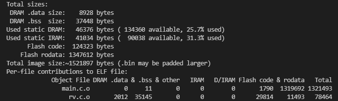

Re: juiceVm risc-v虚拟机在esp32上运行linux kernel
这里运行的 opensbi+kernel+fs 总共 4.6MB 文件 塞到了 1.5MB的固件里

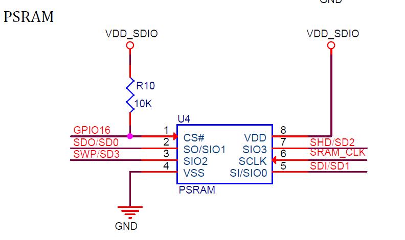

#6 2021-07-16 17:36:42
已发帖子: 857
积分: 693
esp32最大支持16m的falsh和8m的psram,但esp32-s2支持1G的flash和1G的ram,esp32-s2硬件资源是够了,lz重新定义了能跑linux最廉价的riscv板子。
#7 2021-07-16 17:57:08
findie
注册时间: 2021-01-30
积分: 3.5
xiaohui wrote:
findie wrote:
大佬威武 就是我的psram是 按照esp32 wrover的接法弄的有估计吗
可以跑的,flash够大就可以,固件1.5MB左右,可以把引脚给我,我编译下的
1-IO16 8
2-SD0(IO7) 7-SD2(IO9)
3-SD3(IO10) 6-IO17
4- 5-SD1(IO8)
官方wrover内置psram的接法
#8 2021-07-16 18:01:26
findie
注册时间: 2021-01-30
积分: 3.5

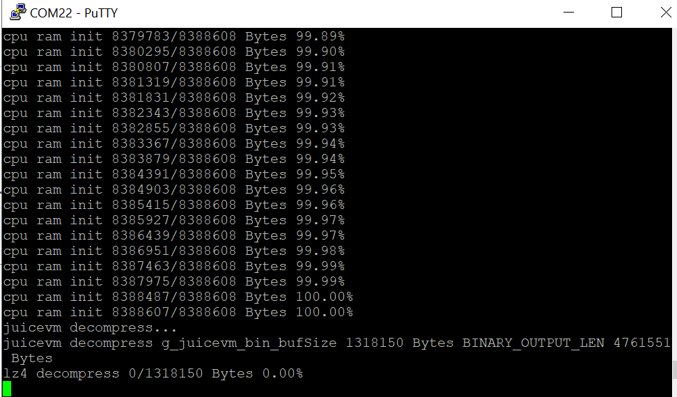

#14 2021-07-20 14:17:44
findie
注册时间: 2021-01-30
积分: 3.5
Hello world!
esp_efuse_get_pkg_ver() 0
EFUSE_RD_CHIP_VER_PKG_ESP32D2WDQ5 2
EFUSE_RD_CHIP_VER_PKG_ESP32PICOD4 5
EFUSE_RD_CHIP_VER_PKG_ESP32PICOD2 4
EFUSE_RD_CHIP_VER_PKG_ESP32PICOV302 6
EFUSE_RD_CHIP_VER_PKG_ESP32D0WDQ6 0
EFUSE_RD_CHIP_VER_PKG_ESP32D0WDQ5 1
This chip is ESP32-D0WD
ESP_ROM_EFUSE_FLASH_DEFAULT_SPI
This is esp32 chip with 2 CPU core(s), WiFi/BT/BLE, silicon revision 1, 2MB external flash
Minimum free heap size: 259564 bytes
juicevm_psram_init:300
Initializing bus SPI2...
停在这里不动了.... 是需要再等等?

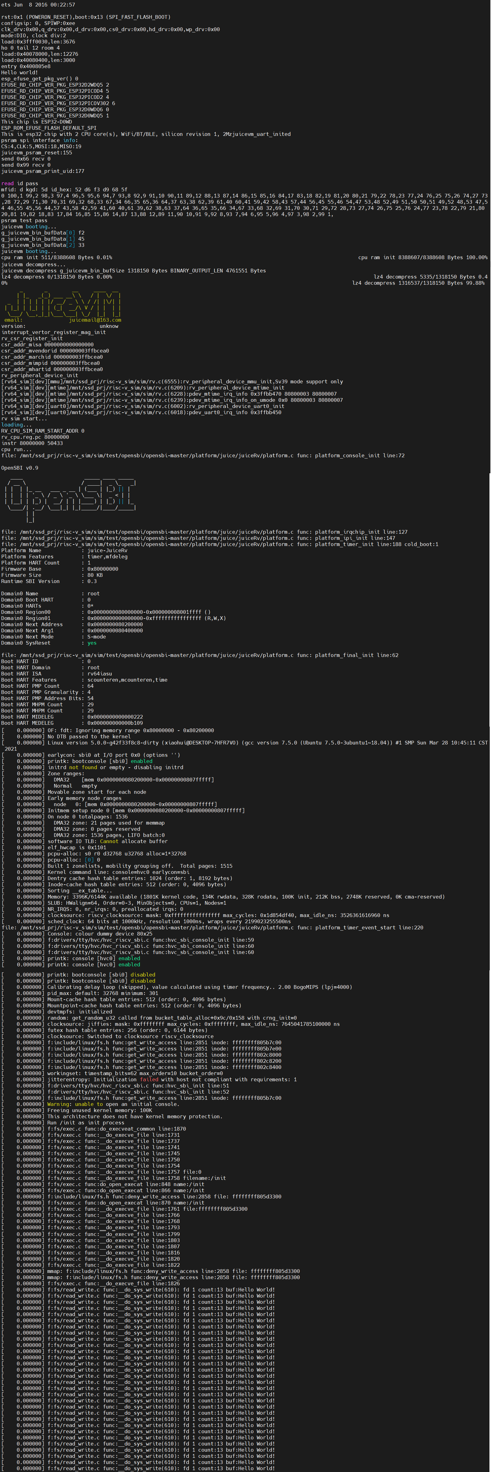

楼主 #16 2021-08-02 19:14:26
xiaohui
注册时间: 2019-01-15
已发帖子: 259
积分: 122.5
@findie
上传esp32 WROVER-B支持的固件
juicevm-risc-v_vm-for-esp32_wrover_20210812.zip

juicevm booting...
g_juicevm_bin_bufData[0] b0
g_juicevm_bin_bufData[1] 73
g_juicevm_bin_bufData[2] 50
juicevm booting...
cpu ram init 48519/8388608 Bytes 0.58%
cpu ram init 8388487/8388608 Bytes 100.00%
cpu ram init 8388607/8388608 Bytes 100.00%
juicevm decompress...
juicevm decompress g_juicevm_bin_bufSize 25119 Bytes BINARY_OUTPUT_LEN 45176 Bytes
lz4 decompress 0/25119 Bytes 0.00%
                                   lz4 decompress 4801/25119 Bytes 19.11%
                                       lz4 decompress 11789/25119 Bytes 46.93%
                                        lz4 decompress 15262/25119 Bytes 60.76%
                                        lz4 decompress 18424/25119 Bytes 73.35%
                                        lz4 decompress 21379/25119 Bytes 85.11%
                                        lz4 decompress 24130/25119 Bytes 96.06%

同样是WROVER-B,cpu ram init到99.60%的时候,速度突然变慢,而且卡在了下图:
楼主 #18 2021-08-07 14:12:01
xiaohui
注册时间: 2019-01-15
已发帖子: 259
积分: 122.5
/files/members/1315/Screenshot121824.png
这里是在解压,压缩率有点高,解压有点慢。
#19 2021-08-07 16:45:18
已发帖子: 857
积分: 693
xiaohui wrote:
感觉有点不正常啊,几个小时了,才解压31%。就像我说的在ram init到99.60%的时候突然变慢,似乎有在此时就不正常了。
最近编辑记录 kekemuyu (2021-08-07 16:46:44)

@kekemuyu
开机六小时,解压和初始化psram超级慢
