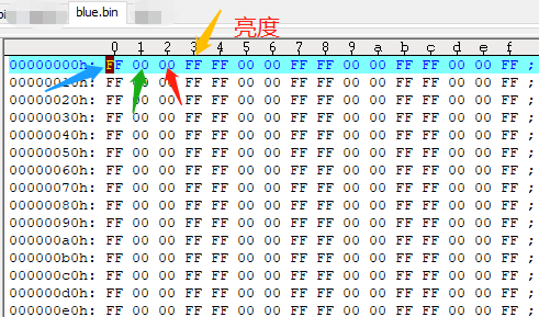

是因为 全志SDK默认Framebuffer格式是 RGBA,有Alpha通道,这个通道要赋值才行。

已发帖子: 288
积分: 202.5
Re: 索智S3-EVB上QT5 GUI LCD无显示
memory 说:
https://whycan.com/files/members/7106/2021-12-12_123528.png
修改 output/build/fb-test-app-rosetta-1.1.0/fb-test.c
        }else if (fb_info->var.bits_per_pixel== 32){
                unsigned char *p;
                p = (unsigned char *)fbmem + fb_info->fix.line_length *y + 4*x;
                *p++ = color;
                *p++ = color >> 8;
                *p++ = color >> 16;
                *p = 0xFF;
output/build/fbv-1.0b/fb_display.c
void* convertRGB2FB(int fh, unsigned char *rgbbuff, unsigned long count, int bpp, int *cpp)
加上:  0xFF000000
        case 32:
            *cpp = 4;
            i_fbbuff = (unsigned int *) malloc(count * sizeof(unsigned int));
            for(i = 0; i < count ; i++)
                i_fbbuff[i] = ((rgbbuff[i*3] << 16) & 0xFF0000) |
                            ((rgbbuff[i*3+1] << 8) & 0xFF00) |
                            (rgbbuff[i*3+2] & 0xFF) |
                            0xFF000000;
            fbbuff = (void *) i_fbbuff;
            break;
