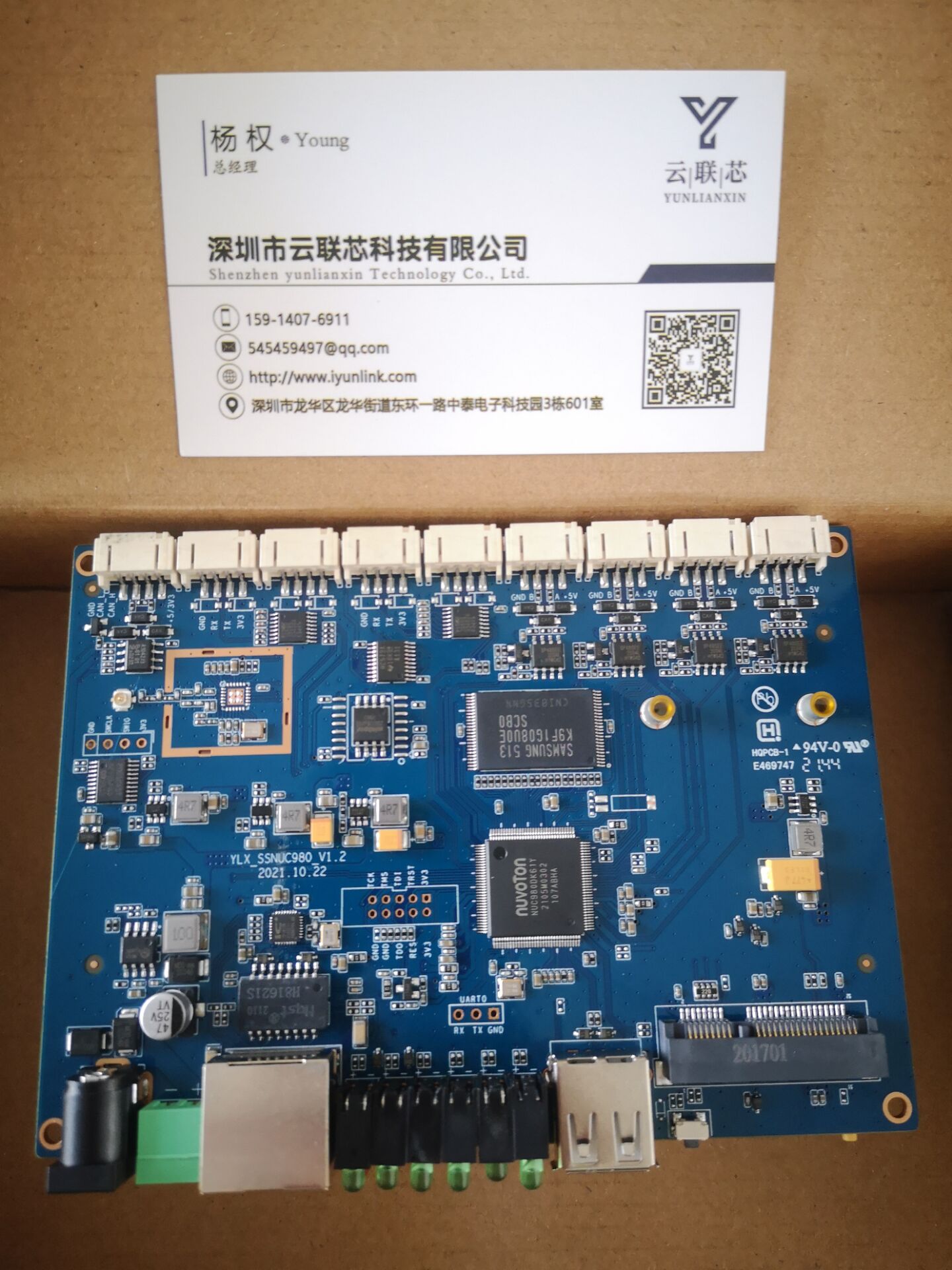

第二批 新唐NUC980 开箱
板子很漂亮,画的很美
启动了一下,openwrt的固件, 没有 root密码,里面没法玩,不知道 杨叔 会不会给密码我们直接玩一下.
就看看LOG

[    2.367716] alg: No test for hmac-sha256 (nuc980-hmac-sha256)
[    2.374333] alg: No test for hmac-sha384 (nuc980-hmac-sha384)
[    2.380958] alg: No test for hmac-sha512 (nuc980-hmac-sha512)
[    2.386774] NUC980 Crypto engine enabled.
[    2.410174] usbcore: registered new interface driver usbhid
[    2.415699] usbhid: USB HID core driver
[    2.434249] NET: Registered protocol family 10
[    2.444066] NET: Registered protocol family 17
[    2.449316] bridge: automatic filtering via arp/ip/ip6tables has been deprecated. Update your scripts to load br_netfilter if you need this.
[    2.462383] can: controller area network core (rev 20120528 abi 9)
[    2.469166] NET: Registered protocol family 29
[    2.473708] can: raw protocol (rev 20120528)
[    2.477958] can: broadcast manager protocol (rev 20120528 t)
[    2.483908] can: netlink gateway (rev 20130117) max_hops=1
[    2.490891] 8021q: 802.1Q VLAN Support v1.8
[    2.506408] ubi0: attaching mtd2
[    2.871774] ubi0: scanning is finished
[    2.893083] ubi0: attached mtd2 (name "rootfs", size 106 MiB)
[    2.899066] ubi0: PEB size: 131072 bytes (128 KiB), LEB size: 126976 bytes
[    2.905899] ubi0: min./max. I/O unit sizes: 2048/2048, sub-page size 2048
[    2.912874] ubi0: VID header offset: 2048 (aligned 2048), data offset: 4096
[    2.920199] ubi0: good PEBs: 844, bad PEBs: 4, corrupted PEBs: 0
[    2.926166] ubi0: user volume: 1, internal volumes: 1, max. volumes count: 128
[    2.933599] ubi0: max/mean erase counter: 2/0, WL threshold: 4096, image sequence number: 565934091
[    2.942799] ubi0: available PEBs: 0, total reserved PEBs: 844, PEBs reserved for bad PEB handling: 16
[    2.952124] ubi0: background thread "ubi_bgt0d" started, PID 1034
[    2.998366] UBIFS (ubi0:0): background thread "ubifs_bgt0_0" started, PID 1041
[    3.021491] UBIFS (ubi0:0): recovery needed
[    3.109641] UBIFS (ubi0:0): recovery completed
[    3.114333] UBIFS (ubi0:0): UBIFS: mounted UBI device 0, volume 0, name "rootfs"
[    3.121841] UBIFS (ubi0:0): LEB size: 126976 bytes (124 KiB), min./max. I/O unit sizes: 2048 bytes/2048 bytes
[    3.131824] UBIFS (ubi0:0): FS size: 103231488 bytes (98 MiB, 813 LEBs), journal size 9023488 bytes (8 MiB, 72 LEBs)
[    3.142374] UBIFS (ubi0:0): reserved for root: 0 bytes (0 KiB)
[    3.148266] UBIFS (ubi0:0): media format: w4/r0 (latest is w4/r0), UUID FE66F50E-7F9E-4193-91A2-B16196A57DDB, small LPT model
[    3.161708] VFS: Mounted root (ubifs filesystem) on device 0:12.
[    3.169949] Freeing unused kernel memory: 184K
[    3.638599] init: Console is alive
[    3.855699] kmodloader: loading kernel modules from /etc/modules-boot.d/*
[    3.915866] kmodloader: done loading kernel modules from /etc/modules-boot.d/*
[    3.939408] init: - preinit -
[    4.456899] random: jshn: uninitialized urandom read (4 bytes read, 7 bits of entropy available)
[    4.590324] random: jshn: uninitialized urandom read (4 bytes read, 7 bits of entropy available)
[    4.751399] random: jshn: uninitialized urandom read (4 bytes read, 7 bits of entropy available)
[    4.874283] random: jshn: uninitialized urandom read (4 bytes read, 7 bits of entropy available)
[    5.012599] random: jshn: uninitialized urandom read (4 bytes read, 8 bits of entropy available)
[    5.201424] nuc980-emac0 b0012000.emac0: eth0 is OPENED
[    5.207408] IPv6: ADDRCONF(NETDEV_UP): eth0: link is not ready
Press the [f] key and hit [enter] to enter failsafe mode
Press the [1], [2], [3] or [4] key and hit [enter] to select the debug level
[    8.692916] mount_root: mounting /dev/root
[    8.707349] urandom-seed: Seed file not found (/etc/urandom.seed)
[    8.834874] procd: - early -
[   11.429299] procd: - ubus -
[   11.499708] random: ubusd: uninitialized urandom read (4 bytes read, 16 bits of entropy available)
[   11.592949] random: ubusd: uninitialized urandom read (4 bytes read, 16 bits of entropy available)
[   11.605574] random: ubusd: uninitialized urandom read (4 bytes read, 16 bits of entropy available)
[   11.614966] random: ubusd: uninitialized urandom read (4 bytes read, 16 bits of entropy available)
[   11.626924] random: ubusd: uninitialized urandom read (4 bytes read, 16 bits of entropy available)
[   11.640558] procd: - init -
[   12.267308] kmodloader: loading kernel modules from /etc/modules.d/*
[   12.294866] ip6_tables: (C) 2000-2006 Netfilter Core Team
[   12.337824] ip_tables: (C) 2000-2006 Netfilter Core Team
[   12.382283] nf_conntrack version 0.5.0 (909 buckets, 3636 max)
[   12.444316] NET: Registered protocol family 24
[   12.496449] xt_time: kernel timezone is -0000
[   12.535874] kmodloader: done loading kernel modules from /etc/modules.d/*
[   22.558574] nuc980-emac0 b0012000.emac0: eth0 is OPENED
[   22.568016] device eth0 entered promiscuous mode
[   22.615216] IPv6: ADDRCONF(NETDEV_UP): br-lan: link is not ready
[  109.348258] random: nonblocking pool is initialized
LEDE login:
