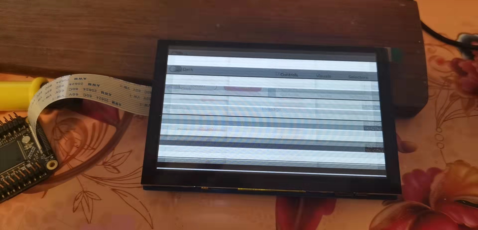

使用小麻雀直接驱动树莓派的DSI屏
续前贴: https://bbs.aw-ol.com/topic/311/
当时使用D1开发板驱动了,因D1的mipi是30pin,需要转接才能接树莓DSI屏。
麻雀设计的时候考虑到这点,直接板载的15Pin,所以直接接上就好。
效果:
固件:
tina_d1s_mipi_rpi_uart0.img
代码:只涉及board.dts和uboot-board.dts

#2 2022-01-20 17:57:53
rstg00po54
注册时间: 2022-01-20
Re: 使用小麻雀直接驱动树莓派的DSI屏
我烧了你的镜像文件显示不正常

Run unmodified tina_d1s_mipi_rpi_uart0.img - uart shown this:
[00.395]line:714 init_clocks
__clk_init: clk pll_periph0x2 already initialized
register fix_factor clk error
[00.406]drv_disp_init
request pwm success, pwm2:pwm2:0x2000c00.
[00.422]drv_disp_init finish
[00.425]boot_gui_init:start
[00.428]set disp.dev2_output_type fail. using defval=0
[00.620]boot_gui_init:finish
partno erro : can't find partition bootloader
54 bytes read in 1 ms (52.7 KiB/s)
[00.989]bmp_name=bootlogo.bmp size 307254
307254 bytes read in 28 ms (10.5 MiB/s)
[01.031]LCD open finish
Why disp.dev2_output_type fail ?
Display not shown anything. Backlight turned on by hardware.
最近编辑记录 GenaSPB (2024-04-28 15:14:47)
