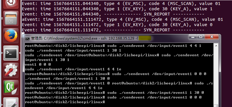

请教Linux下面如何才能对 /dev/input/event* 在应用程序注入数据,用 evtest 可以读出?内核要不要配置什么

网上复制的代码怎么都没搞定

sendevent.c

    if(argc != 5) {
        fprintf(stderr, "use: %s device type code value\n", argv[0]);
        return 1;
    fd = open(argv[1], O_RDWR);
    if(fd < 0) {
        fprintf(stderr, "could not open %s, %s\n", argv[optind], strerror(errno));
        return 1;
    if (ioctl(fd, EVIOCGVERSION, &version)) {
        fprintf(stderr, "could not get driver version for %s, %s\n", argv[optind], strerror(errno));
        return 1;
    memset(&event, 0, sizeof(event));
    event.type = atoi(argv[2]);
    event.code = atoi(argv[3]);
    event.value = atoi(argv[4]);
    ret = write(fd, &event, sizeof(event));
    if(ret < sizeof(event)) {
        fprintf(stderr, "write event failed, %s\n", strerror(errno));
        return -1;
