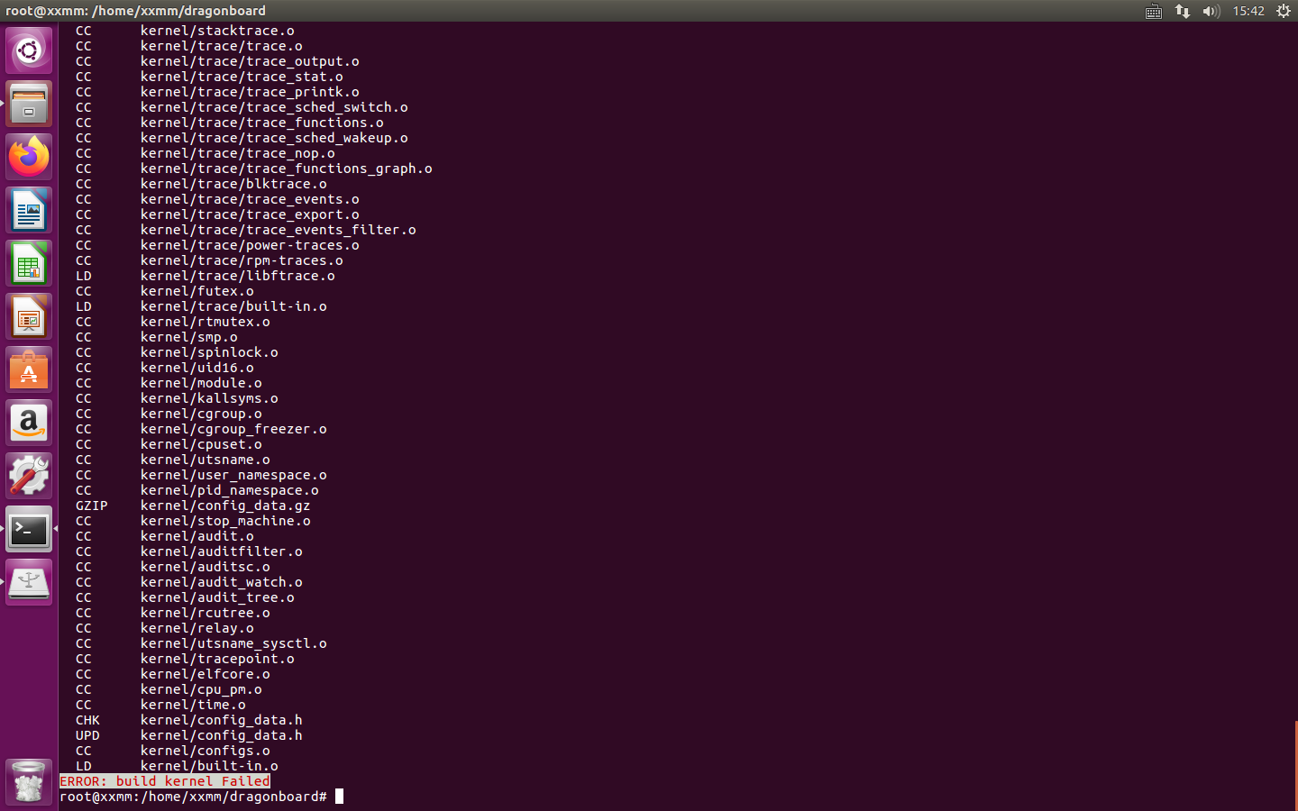

今天我尝试编译A33的SDK了
入坑失败
make[3]: arch/arm/mach-sunxi/pm/standby/gen_check_code:命令未找到
/home/xxmm/A33/dragonboard/linux-3.4/arch/arm/mach-sunxi/pm/standby/Makefile:85: recipe for target 'arch/arm/mach-sunxi/pm/standby/resume1.code' failed
make[3]: *** [arch/arm/mach-sunxi/pm/standby/resume1.code] Error 127
/home/xxmm/A33/dragonboard/linux-3.4/arch/arm/mach-sunxi/pm/Makefile:70: recipe for target 'arch/arm/mach-sunxi/pm/standby/standby.code' failed
make[2]: *** [arch/arm/mach-sunxi/pm/standby/standby.code] Error 2
scripts/Makefile.build:443: recipe for target 'arch/arm/mach-sunxi/pm' failed
make[1]: *** [arch/arm/mach-sunxi/pm] Error 2
Makefile:945: recipe for target 'arch/arm/mach-sunxi' failed
make: *** [arch/arm/mach-sunxi] Error 2
缺少 gen_check_code:命令

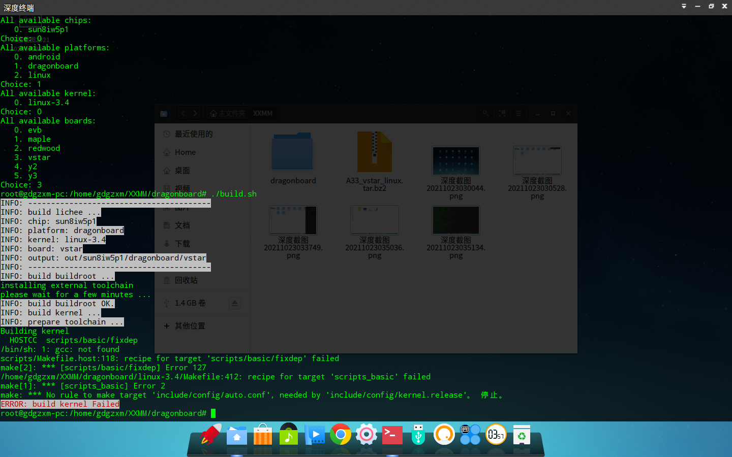

今天早上再次编译全志A33 vstar , 再次失败 ,
信息 , 操作命令在下面

    root@xxmm:/home/xxmm/A33/dragonboard# ./build.sh
    INFO: ----------------------------------------
    INFO: build lichee ...
    INFO: chip: sun8iw5p1
    INFO: platform: dragonboard
    INFO: kernel: linux-3.4
    INFO: board: vstar
    INFO: output: out/sun8iw5p1/dragonboard/vstar
    INFO: build buildroot ...
    external toolchain has been installed
    INFO: build buildroot OK.
    INFO: build kernel ...
    INFO: prepare toolchain ...
    Building kernel
    scripts/kconfig/conf --silentoldconfig Kconfig
    drivers/net/wireless/bcmdhd/Kconfig:43:warning: defaults for choice values not supported
    CHK include/linux/version.h
    CHK include/generated/utsrelease.h
    make[1]: 'include/generated/mach-types.h' is up to date.
    CALL scripts/checksyscalls.sh
    CHK include/generated/compile.h
    CC kernel/fork.o
    CC arch/arm/mach-sunxi/pm/standby/common.o
    CC arch/arm/mach-sunxi/pm/standby/standby_clock.o
在这里,省略了若干信息
CC arch/arm/mach-sunxi/pm/standby/./../mem_hwspinlock.o
CC kernel/exec_domain.o
CC arch/arm/mach-sunxi/pm/standby/standby.o
rm -rf .o arch/arm/mach-sunxi/pm/standby/../.o
CC arch/arm/mach-sunxi/pm/standby/super/common.o
在这里,省略了若干信息
CC kernel/printk.o
AS arch/arm/mach-sunxi/pm/standby/../mem_mmu_pc_asm.o
在这里,省略了若干信息
CC arch/arm/mach-sunxi/pm/standby/../mem_hwspinlock.o
CC arch/arm/mach-sunxi/pm/standby/../mem_clk.o
/home/xxmm/A33/dragonboard/linux-3.4/arch/arm/mach-sunxi/pm/standby/Makefile:89: recipe for target 'arch/arm/mach-sunxi/pm/standby/resume1.code' failed
make: *** 正在等待未完成的任务....
CC kernel/cpu.o
在这里,省略了若干信息
CC kernel/sched/fair.o
kernel/time/alarmtimer.c: In function ‘alarmtimer_shutdown’:
kernel/time/alarmtimer.c:298:13: warning: unused variable ‘i’ [-Wunused-variable]
CC kernel/time/clockevents.o
在这里,省略了若干信息
CHK kernel/config_data.h
UPD kernel/config_data.h
CC kernel/configs.o
LD kernel/built-in.o
ERROR: build kernel Failed

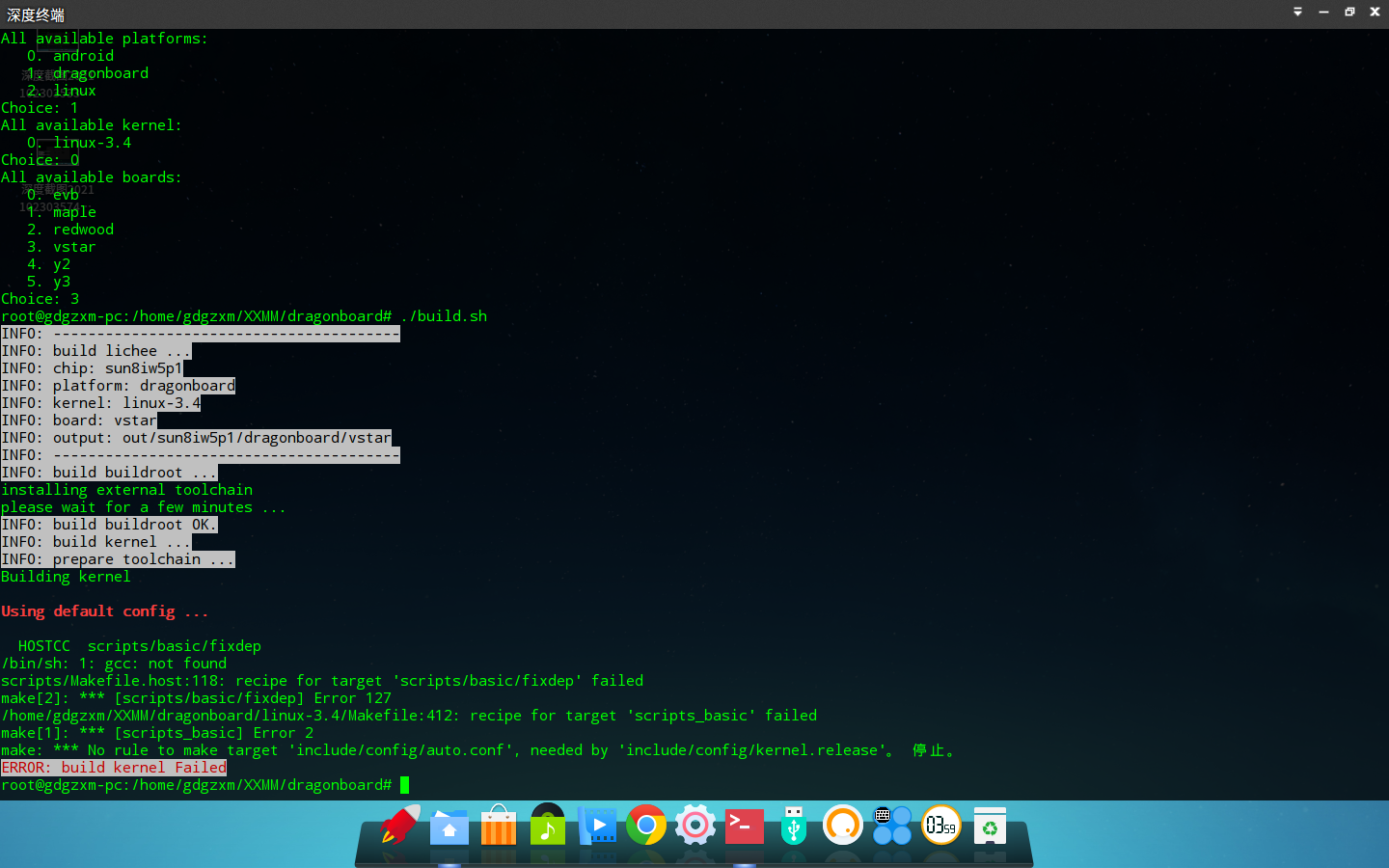

编译选项 0 1 0 3 , 失败

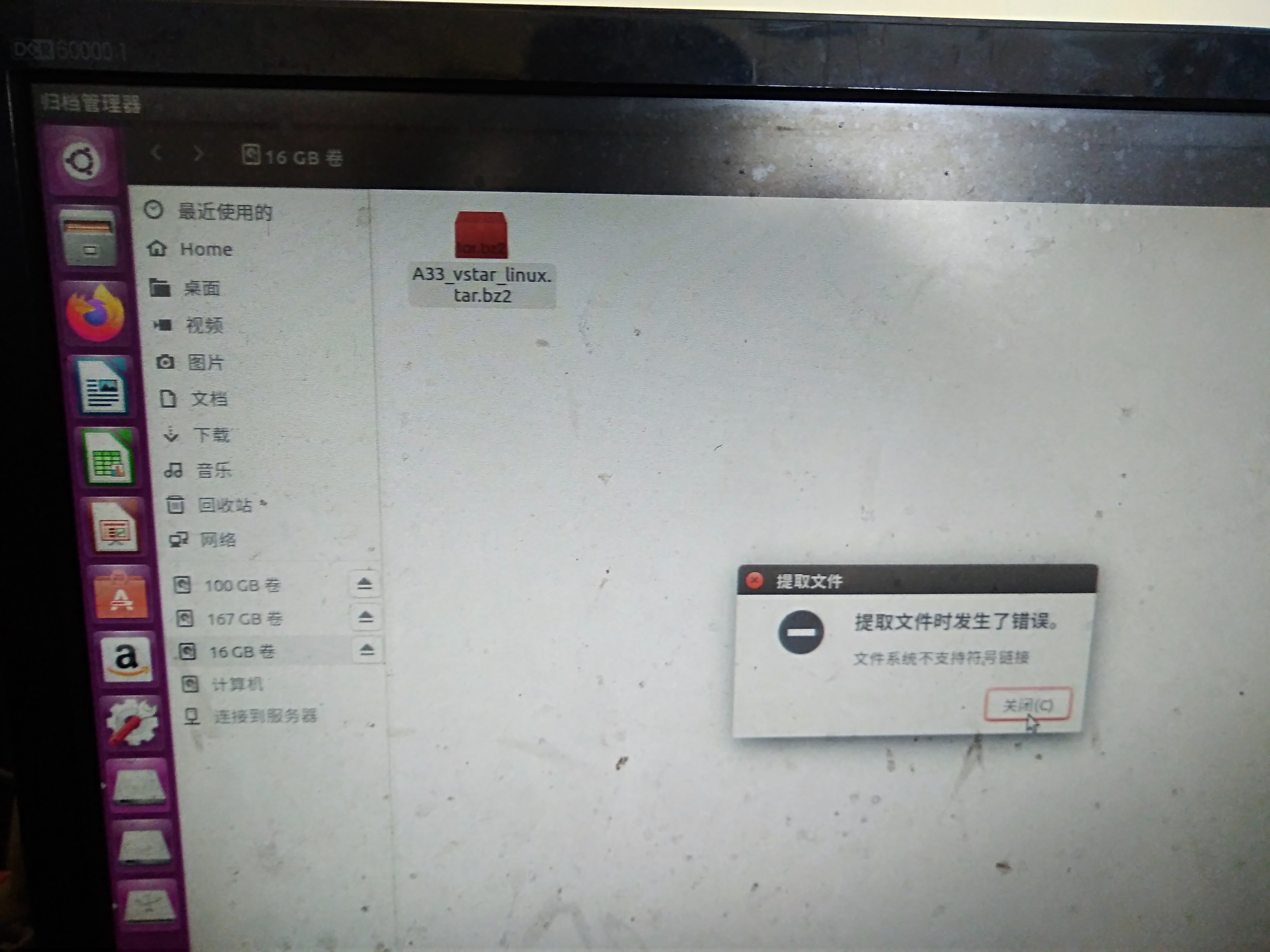

感觉你的SDK不全, 或者解压的时候丢了文件? 你是不是windows解压,然后复制过去的?

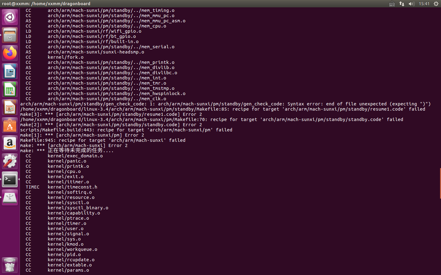

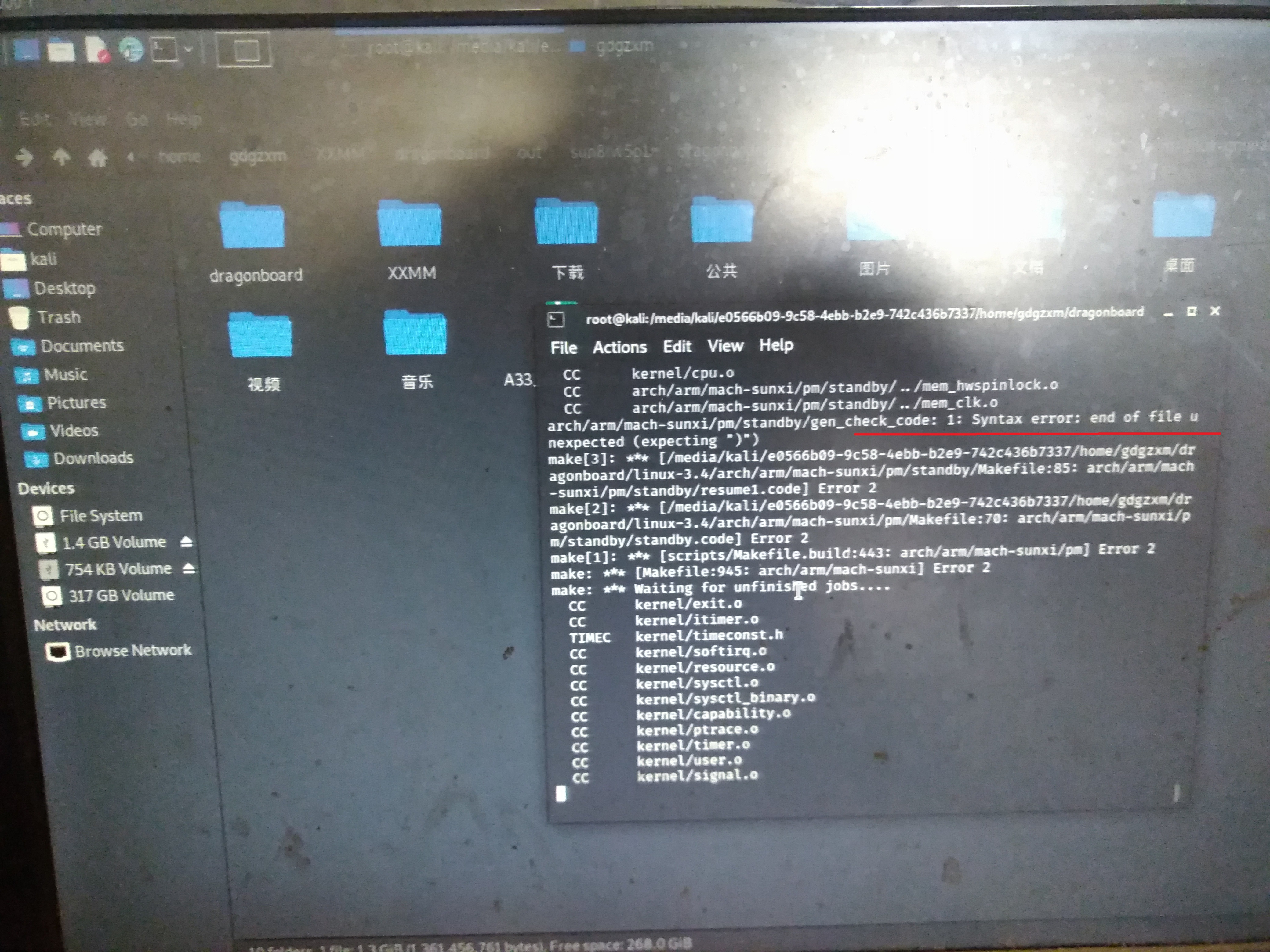

我是在 UBUNTU,使用提取到此处来解压的
我已经再次下载 A33_vstar_linux.tar
再次解压,
再次编译
再次失败
失败的信息
arch/arm/mach-sunxi/pm/standby/gen_check_code: 1: arch/arm/mach-sunxi/pm/standby/gen_check_code: Syntax error: end of file unexpected (expecting ")")
make[3]: *** [arch/arm/mach-sunxi/pm/standby/resume1.code] Error 2
上一次失败

楼主 #10 2021-10-21 12:01:37
0123456789
注册时间: 2021-10-14
已发帖子: 25
积分: 25
Re: 全志A33 , 4核,1.2G主频
root@xxmm:/home/xxmm/A33# cd  dragonboard
root@xxmm:/home/xxmm/A33/dragonboard# ls
brandy  buildroot  build.sh  clean.sh  linux-3.4  out  README  tools
INFO: board: vstar
Building kernel
  CC      mm/fadvise.o
  LD      mm/built-in.o
其中很关键的几个信息

楼主 #15 2021-10-22 15:07:38
0123456789
注册时间: 2021-10-14
已发帖子: 25
积分: 25
现在解压都发生错误
#16 2021-10-22 15:48:28
已发帖子: 3,410
积分: 1907
0123456789 wrote:
/files/members/7482/A33.jpg
现在解压都发生错误
用命令行解压 tar xvf xxx.tagz

楼主 #21 2021-10-23 16:02:40
0123456789
注册时间: 2021-10-14
已发帖子: 25
积分: 25
从早上忙碌到现在 , 还没有编译成功 。
安装了一个叫KALI的linux 系统,然后编译 , 没有成功。
还是 Syntax error: end of file unexpected (expecting ")")
楼主 #22 2021-10-23 16:07:21
0123456789
注册时间: 2021-10-14
已发帖子: 25
积分: 25
然后安装一个叫做 deepin 深度系统
还是失败
