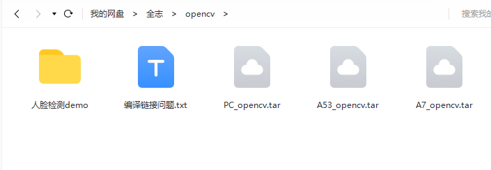

分享一下编译好的opencv库
opencv交叉编译挺坑的,分享一下个人编译好的库
包含适用于 PC端 A7架构(V3s/V3X H2 H3等) A53架构(H5 H6)的opencv动态库
链接:
https://pan.baidu.com/s/19ia2QO9gtlHLV82U27WCmg
提取码:7ur9

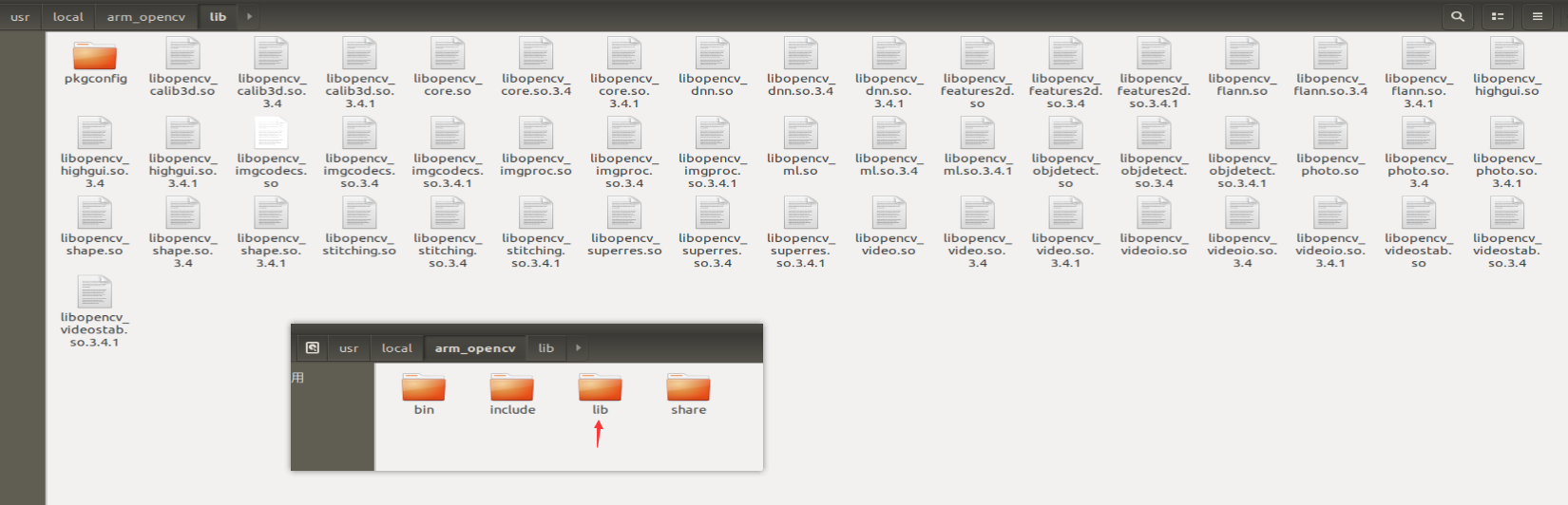

【PC端】
将PC opencv和ARM opencv库解压到自定义路径下(PC用于调试,调试后成功后切换arm编译)
【ARM端】
将lib文件下的所有文件复制到板子/usr/lib下 (如果在arm端编译还需复制include下的文件)
【Qt】
INCLUDEPATH += /usr/local/include \
                /usr/local/arm_opencv/include/opencv \
               /usr/local/arm_opencv/include/opencv2
LIBS += /usr/local/arm_opencv/lib/libopencv*.so
【GCC】
g++ test.cpp -o test -I/home/lzq/opencv/PC_opencv/include -L/home/lzq/opencv/PC_opencv/lib -lopencv_highgui -lopencv_imgproc -lopencv_core -lopencv_imgcodecs -lopencv_videoio -lpthread -ldl
