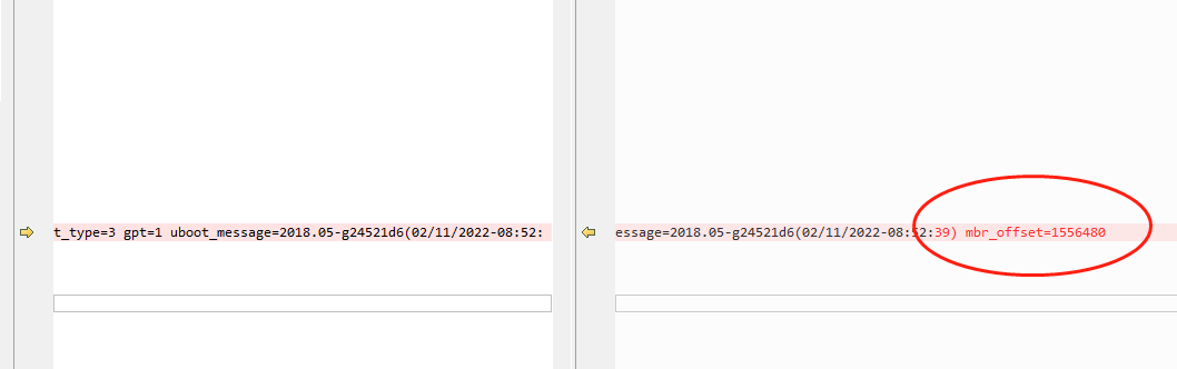

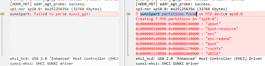

缓冲区不够长?
楼主 #4 2022-03-09 23:02:03
Re: D1s SPINOR patch, MX25L256 已测试
发现是bootargs太长了, 改短一点
lichee/brandy-2.0/u-boot-2018/board/sunxi/sunxi_bootargs.c
-       sprintf(tmpbuf, " uboot_message=%s(%s-%s)", PLAIN_VERSION, U_BOOT_DMI_DATE, U_BOOT_TIME);
-       strcat(cmdline, tmpbuf);
+//     sprintf(tmpbuf, " uboot_message=%s(%s-%s)", PLAIN_VERSION, U_BOOT_DMI_DATE, U_BOOT_TIME);
+//     strcat(cmdline, tmpbuf);

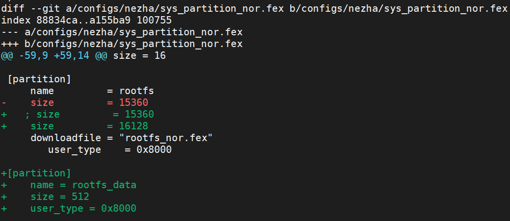

发现 overlayfs 死活挂不上去:

添加 jffs2 文件系统解决了。
