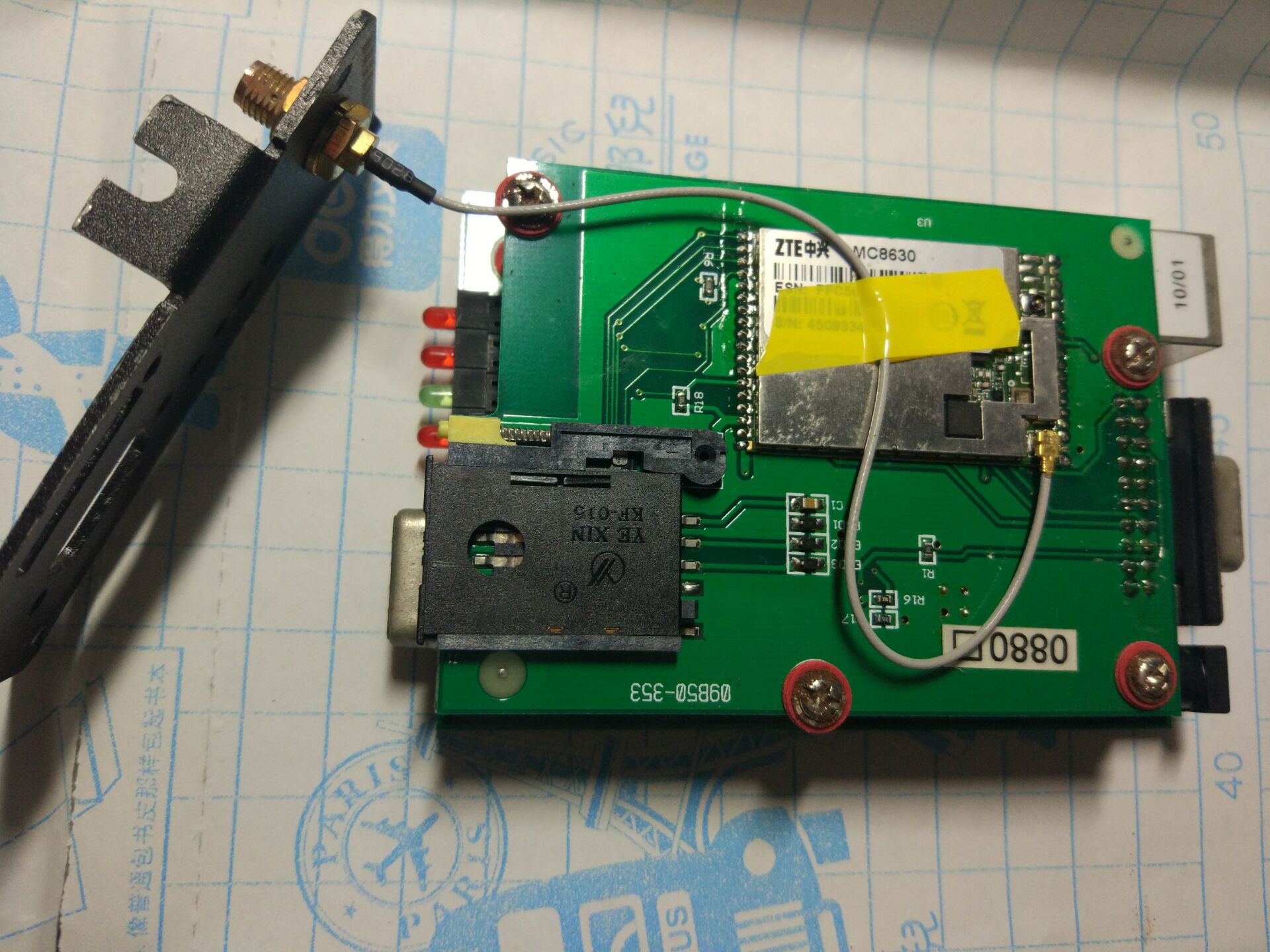

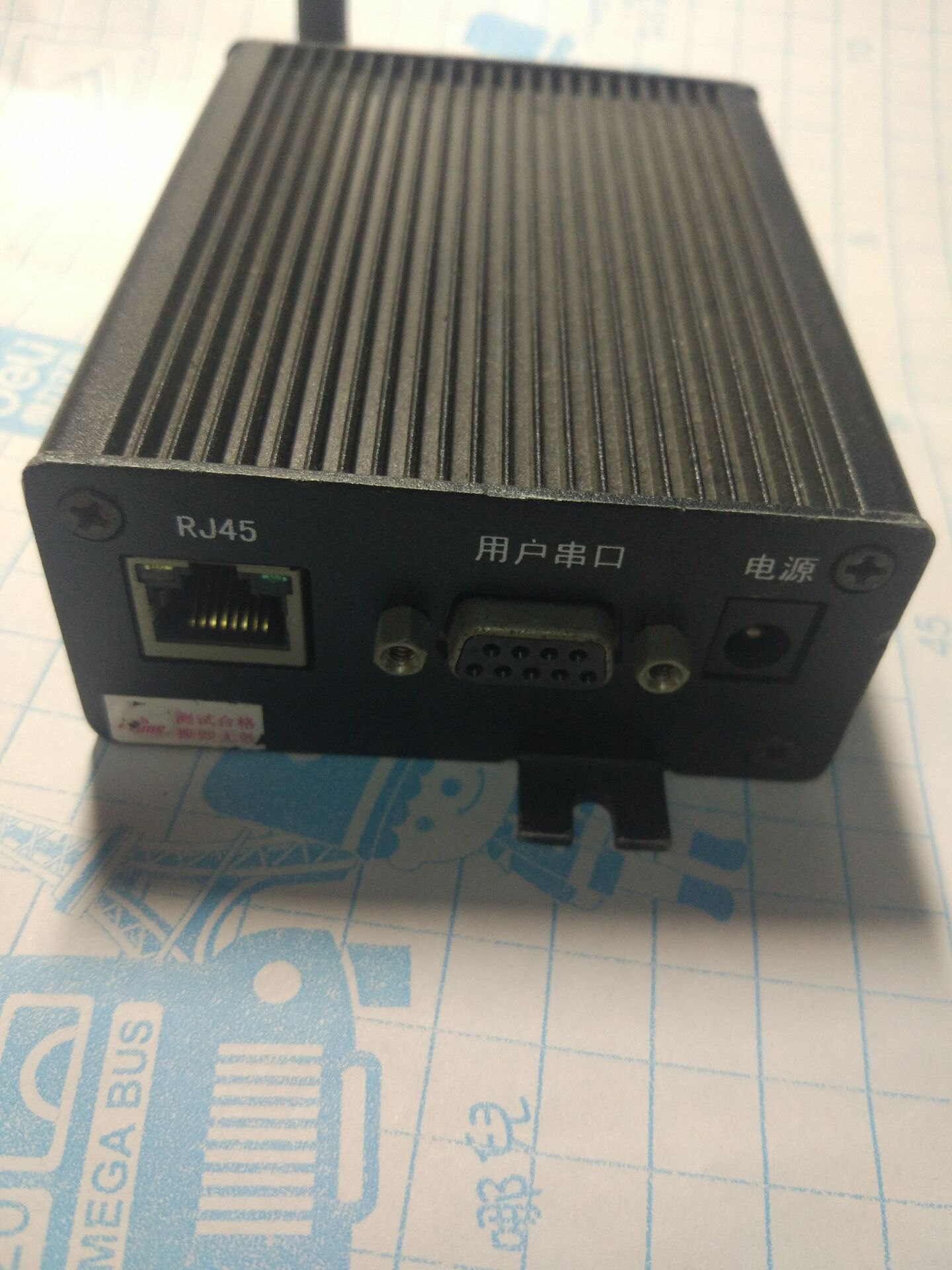

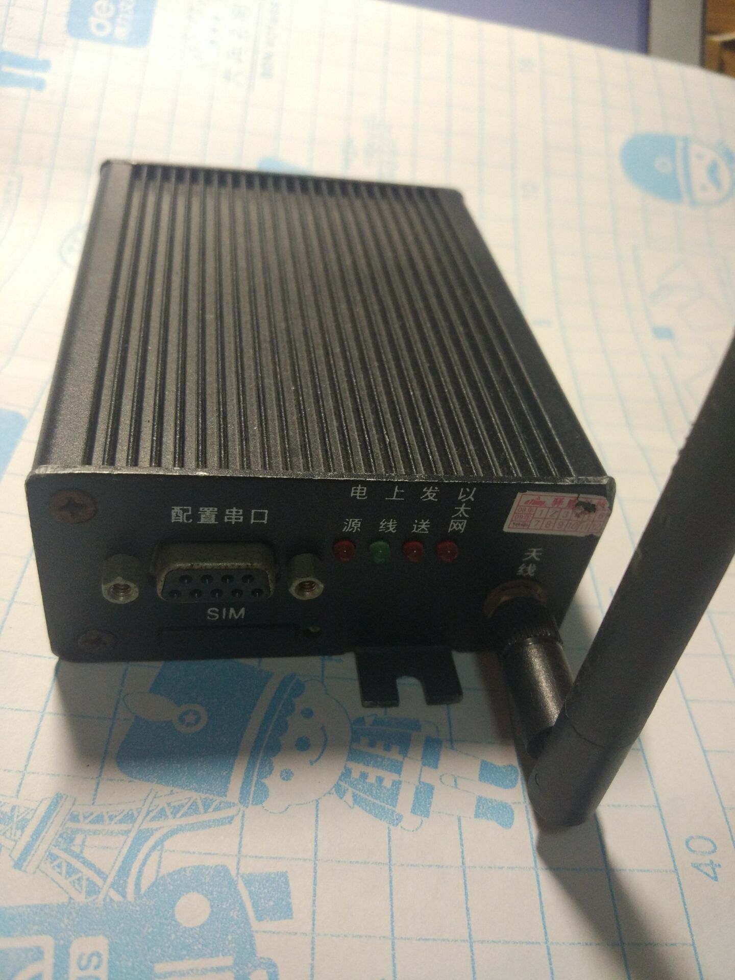

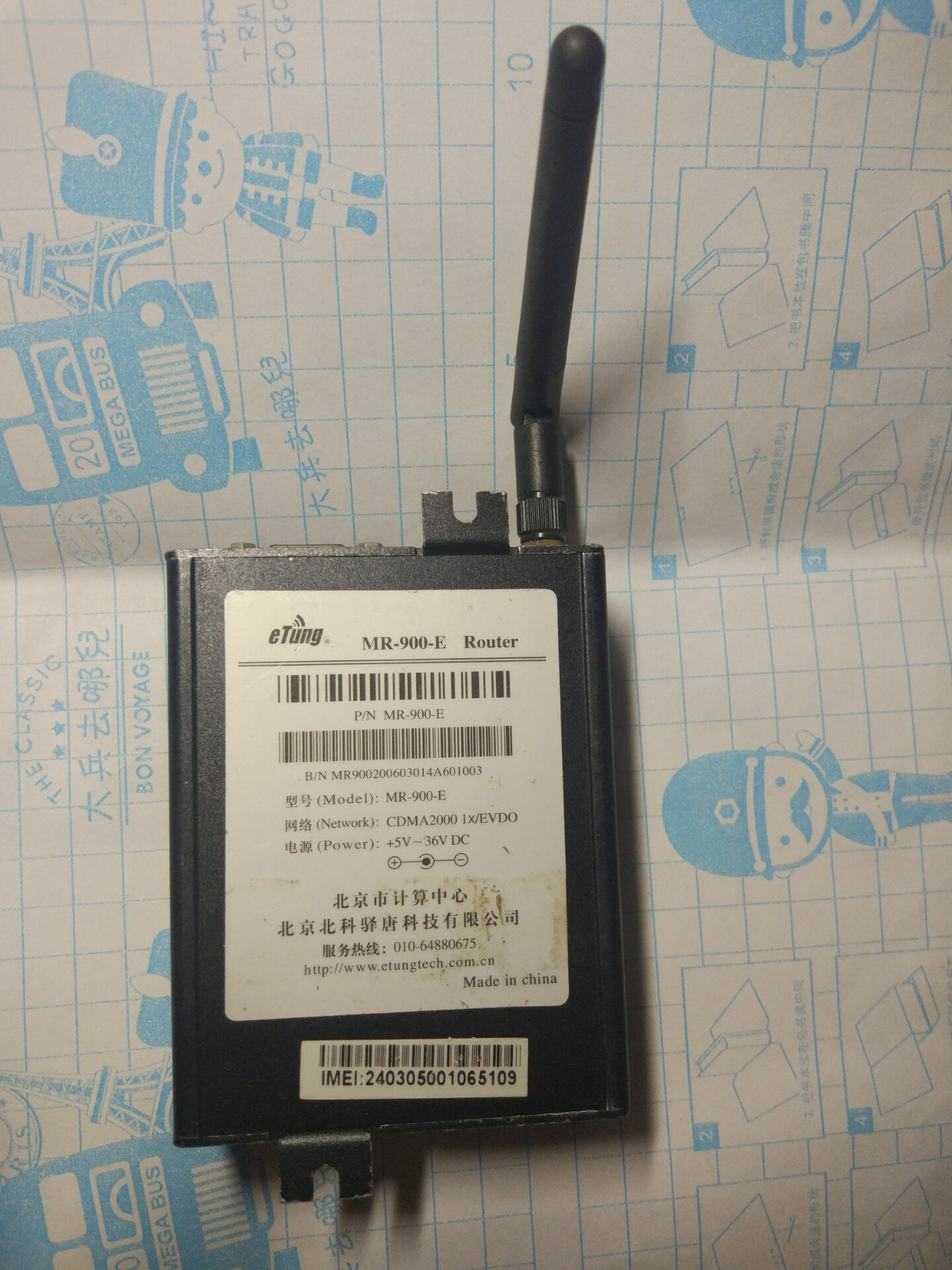

从家里垃圾堆翻出来的北京驿唐科技(eTung)的 MR-900-E 电信3G路由器,使用AT91SAM9260方案

串口线插入【配置串口】,默认115200 8 N 1, 显示以上信息.

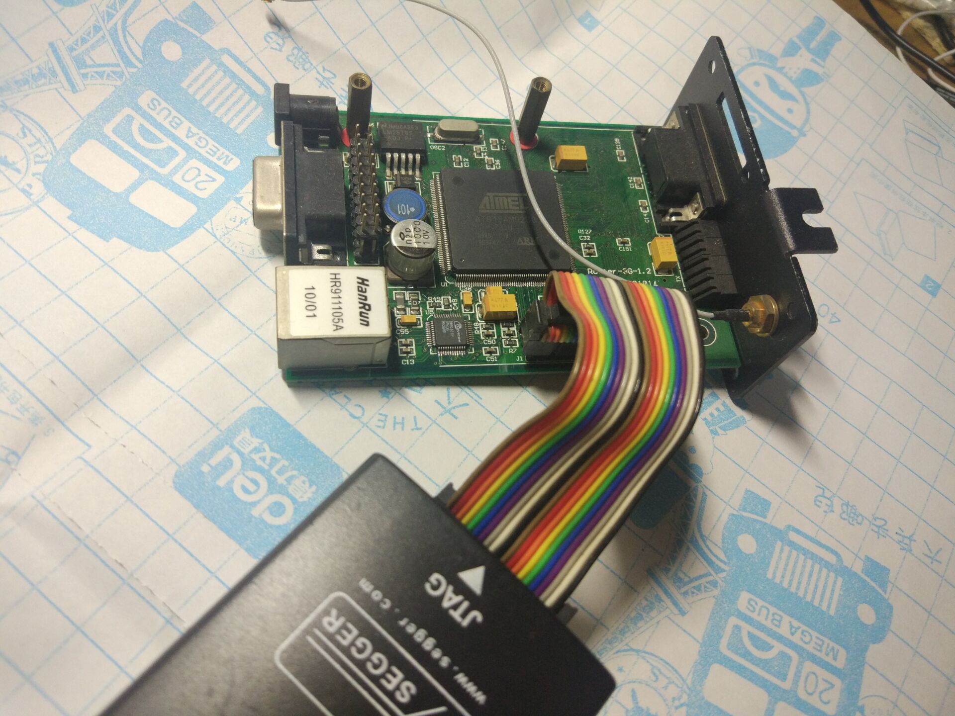

SEGGER J-Link Commander V4.50 ('?' for help)
Compiled Jun 1 2012 22:44:34
DLL version V4.50, compiled Jun 1 2012 22:44:17
Firmware: J-Link ARM V8 compiled Nov 28 2014 13:44:46
Hardware: V8.00
S/N: 20121126
Feature(s): RDI,FlashDL,FlashBP,JFlash
VTarget = 3.293V
Info: TotalIRLen = 4, IRPrint = 0x01
Found 1 JTAG device, Total IRLen = 4:
#0 Id: 0x0792603F, IRLen: 04, IRPrint: 0x1, ARM926EJ-S Core (Atmel)
Found ARM with core Id 0x0792603F (ARM9)
JTAG speed: 100 kHz
J-Link>
JLINK 信息.
