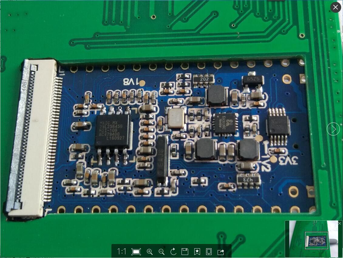

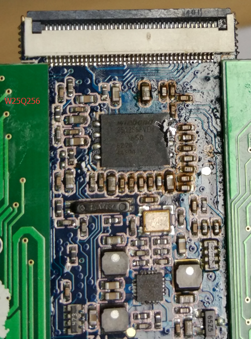

请问全志v3s支持32M的spi nor flash吗,比如w25q256?

Re: 请问全志v3s支持32M的spi nor flash吗,比如w25q256?
支持,我试过了
#3 2017-10-10 10:49:18
已发帖子: 9,422
看我的w25q256:
aaaaa@ubuntu:/disk2$ sudo sunxi-fel spiflash-info
Manufacturer: Winbond (EFh), model: 40h, size: 33554432 bytes.
aaaaa@ubuntu:/disk2/licheepi$ sudo sunxi-fel -p spiflash-write 0x100000 linux/arch/arm/boot/dts/sun8i-v3s-licheepi-zero-dock.dtb
100% [================================================]    12 kB,   32.1 kB/s
aaaaa@ubuntu:/disk2/licheepi$ sudo sunxi-fel -p spiflash-write 0x110000 linux/arch/arm/boot/zImage
100% [================================================]  4594 kB,   49.7 kB/s
搞定, 可以正常启动Linux
#4 2017-10-10 14:56:35
已发帖子: 9,422
搞定v3s 使用 MX25L256
