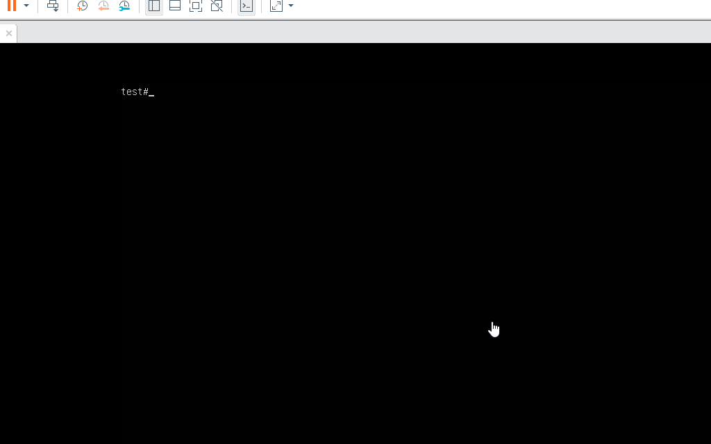

[分享] LittleVGL / LVGL 显示鼠标的代码
https://forum.lvgl.io/t/how-to-set-a-cursor-to-show-where-i-touch-the-screen/1524/2
	lv_indev_drv_t indev_drv;
	lv_indev_drv_init(&indev_drv);
	indev_drv.type       = LV_INDEV_TYPE_POINTER;
	indev_drv.read_cb    = mouse_read;
	lv_indev_t *indev    = lv_indev_drv_register(&indev_drv);
	lv_obj_t *cursor_img = lv_img_create(lv_scr_act(), NULL);
	lv_img_set_src(cursor_img, LV_SYMBOL_OK);
	lv_indev_set_cursor(indev, cursor_img);

Re: [分享] LittleVGL / LVGL 显示鼠标的代码
在linux下怎么即使用触屏又使用鼠标呢?一个evdev0一个evdev1
#4 2022-07-18 22:29:35
Ican
注册时间: 2022-06-11
已发帖子: 30
这鼠标的输入数据是真实鼠标的吗?
