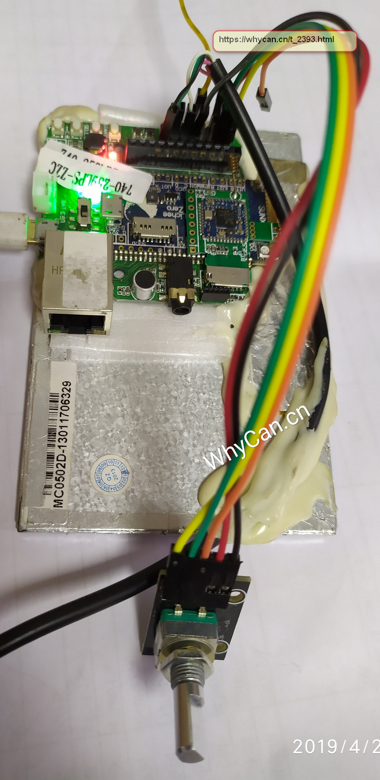

楼主 #5 2019-04-27 14:07:17
已发帖子: 9,413
Re: V3s/S3 Linux 测试 轮询/中断 GPIO 按钮驱动程序 / 旋转编码器 等
旋转编码器(中断)测试:
参考: https://github.com/teknoid/dac/blob/master/misc/gpio-rotary.dts
接线方法:
PB0 - CLK
PB1 - DT
3V3
GND
1. Linux驱动配置 gpio keys 驱动:
CONFIG_INPUT_GPIO_ROTARY_ENCODER=y
2. arch/arm/boot/dts/sun8i-v3s.dtsi 添加引脚定义:
key_pins: key_pins@0 {
pins = "PB0", "PB1";
function = "gpio_in";
allwinner,drive = <0>;
allwinner,pull = <1>;
3. arch/arm/boot/dts/sun8i-v3s-licheepi-zero.dts 添加:
rotary@0 {
        compatible = "rotary-encoder";
        pinctrl-names = "default";
        pinctrl-0 = <&key_pins>;
        gpios = <&pio 1 0 GPIO_ACTIVE_LOW>, <&pio 1 1 GPIO_ACTIVE_LOW>; /* PB0, PB1 */
        linux,axis = <0>; /* REL_X */
        rotary-encoder,encoding = "gray";
        rotary-encoder,relative-axis;
4. 编译烧录运行测试, 支持长按:
# evtest /dev/input/event1
Input driver version is 1.0.1
Input device ID: bus 0x19 vendor 0x0 product 0x0 version 0x0
Input device name: "rotary@0"
Supported events:
  Event type 0 (EV_SYN)
  Event type 2 (EV_REL)
    Event code 0 (REL_X)
Properties:
Event: time 2474.959560, type 2 (EV_REL), code 0 (REL_X), value 1
Event: time 2474.959560, -------------- SYN_REPORT ------------
Event: time 2476.204760, type 2 (EV_REL), code 0 (REL_X), value 1
Event: time 2476.204760, -------------- SYN_REPORT ------------
Event: time 2476.907228, type 2 (EV_REL), code 0 (REL_X), value 1
Event: time 2476.907228, -------------- SYN_REPORT ------------
Event: time 2477.565278, type 2 (EV_REL), code 0 (REL_X), value 1
Event: time 2477.565278, -------------- SYN_REPORT ------------
Event: time 2478.140605, type 2 (EV_REL), code 0 (REL_X), value 1
Event: time 2478.140605, -------------- SYN_REPORT ------------
Event: time 2478.548095, type 2 (EV_REL), code 0 (REL_X), value -1
Event: time 2478.548095, -------------- SYN_REPORT ------------
Event: time 2479.051748, type 2 (EV_REL), code 0 (REL_X), value -1
Event: time 2479.051748, -------------- SYN_REPORT ------------
Event: time 2479.541767, type 2 (EV_REL), code 0 (REL_X), value -1
Event: time 2479.541767, -------------- SYN_REPORT ------------
Event: time 2479.924168, type 2 (EV_REL), code 0 (REL_X), value -1
Event: time 2479.924168, -------------- SYN_REPORT ------------

在线
楼主 #6 2019-04-27 19:57:18
已发帖子: 9,413
荔枝派zero 旋转编码器演示视频

这是我设备树的配置:
    rotary@0 {
            gpios = <&pio PE 5 0 6 1 0>, <&pio PE 6 0 6 1 0>;

我记得PE没有中断

我看了芯片手册,PE有外部中断
我怀疑可能是这个帖子的原因:
https://bbs.aw-ol.com/topic/1253/linux4 … 3229721575

问题已解决
