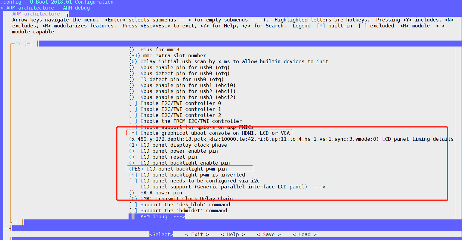

Uboot是参考https://blog.csdn.net/Naisu_kun/article/details/123142958可以正常编译,我想把lcd显示加上,在menuconfig里面把Enable graphical uboot console on HDMI, LCD or VGA选项打开后编译就提示下面的错误,求大神帮忙看一下是什么原因?

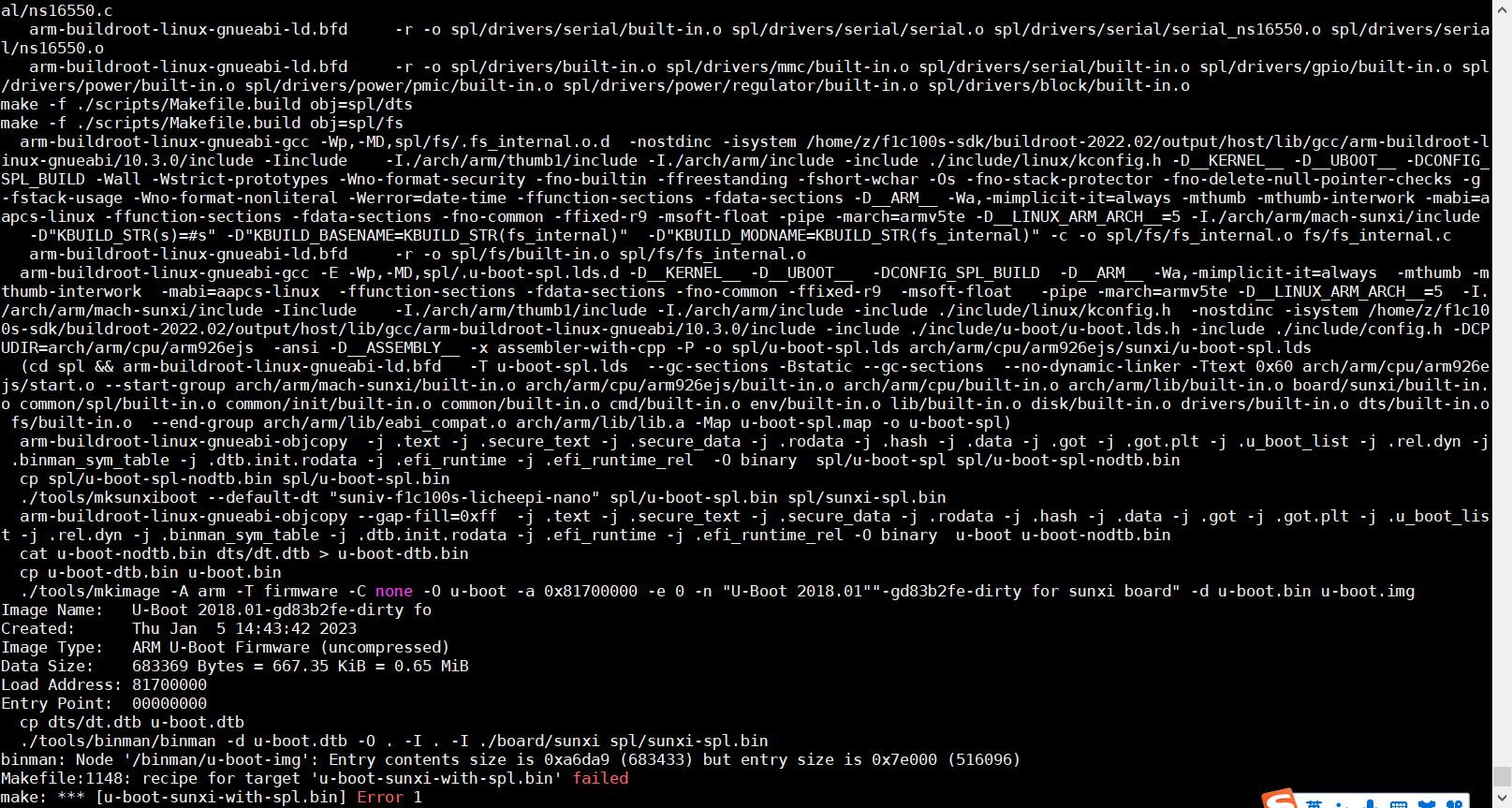

binman: Node '/binman/u-boot-img': Entry contents size is 0xa6da9 (683433) but entry size is 0x7e000 (516096)
Makefile:1148: recipe for target 'u-boot-sunxi-with-spl.bin' failed
