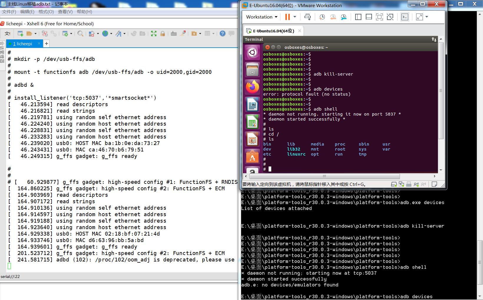

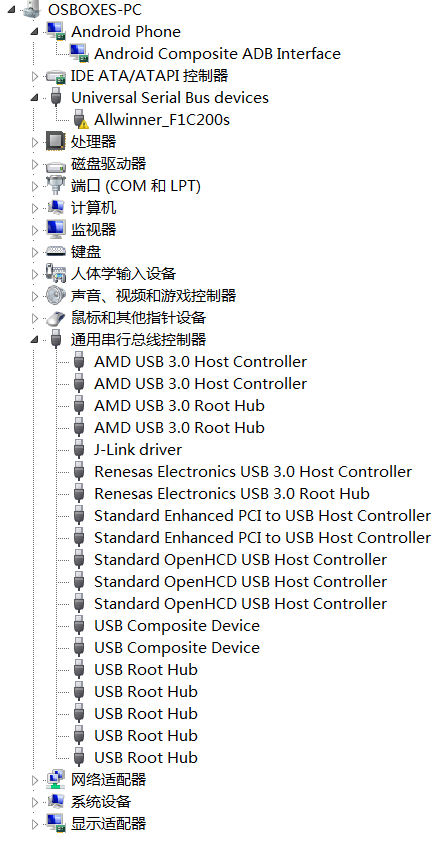

趁晕哥跑路赶紧发帖求助:adb驱动正常,但是device not found
昨天刚移植的系统,增加了adb,开机进shell里手动执行下面指令:
modprobe g_ffs idVendor=0x18d1 idProduct=0x4e42 iSerialNumber="buildroot"
mkdir -p /dev/usb-ffs/adb
mount -t functionfs adb /dev/usb-ffs/adb -o uid=2000,gid=2000
adbd &
然后插入usb,电脑也识别出adb设备了,但是在cmd里面adb shell错误:error: device not found
这是为啥?
插入usb之后提示:
[ 87.222118] g_ffs gadget: high-speed config #1: FunctionFS + RNDIS
是RNDIS影响的么?
  1. 这是插入usb电脑驱动:
  2. adb shell:
    Microsoft Windows XP [版本 6.1.7601]
    (C) 版权所有 1985-2001 Microsoft Corp.
F:\Lichee Nano\扩展\adb shell>adb shell
  • daemon not running. starting it now *
  • daemon started successfully *

# modprobe g_ffs idVendor=0x18d1 idProduct=0x4e42 iSerialNumber="buildroot"
[   47.826561] file system registered
# mkdir -p /dev/usb-ffs/adb
# mount -t functionfs adb /dev/usb-ffs/adb -o uid=2000,gid=2000
# adbd &
# install_listener('tcp:5037','*smartsocket*')
[   73.867570] read descriptors
[   73.870542] read strings
[   73.873285] using random self ethernet address
[   73.877892] using random host ethernet address
[   73.882405] using random self ethernet address
[   73.886849] using random host ethernet address
[   73.892646] usb0: HOST MAC 5e:9e:62:f6:5a:b5
[   73.897026] usb0: MAC e2:63:4f:78:06:04
[   73.901264] g_ffs gadget: g_ffs ready

取消下面两项试试:
Device Drivers > USB support > USB Gadget Support
[ ] RNDIS
[ ] Include configuration with RNDIS (Ethernet)
编译再烧写看看:
[ 203.119624] g_ffs: Unknown symbol rndis_borrow_net (err 0)
[ 203.127150] g_ffs: Unknown symbol rndis_borrow_net (err 0)
modprobe: can't load module g_ffs (kernel/drivers/usb/gadget/legacy/g_ffs.ko): unknown symbol in module, or unknown parameter
很明显失败了!!!

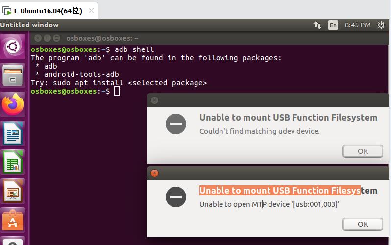

  1. 换台电脑试一试
  2. 挂载到 VMWARE + Ubuntu 试一试, 看是否正常.
楼主 #4 2020-07-09 23:47:41
大帅
注册时间: 2019-01-17
已发帖子: 169
积分: 128.5
Re: 趁晕哥跑路赶紧发帖求助:adb驱动正常,但是device not found
哇酷小二 wrote:
  1. 换台电脑试一试
这个电脑设别F1C600的adb是没有问题.
明天在虚拟机里试试.

首先想到的是不是win7下面原来使用的adb比较老,于是在下载一个:
ADB和Fastboot for Windows
https://dl.google.com/android/repository/platform-tools-latest-windows.zip
用这个还adb是不行,信息在下面图片里面有。
然后去虚拟机里安装adb工具试试,一顿操作之后,可以使用了!
疑问: 有没有办法可以在win7下面使用adb?

还遇见一个问题,usb插拔一个,电脑就失败不出来了, 只能licheepi 重启 再搞一次adb脚本 才能识别, 这是为啥?

[ 51.276001] g_ffs gadget: high-speed config #1: FunctionFS + RNDIS
[ 299.120687] g_ffs gadget: high-speed config #2: FunctionFS + ECM
发现在win7和Ubuntu下面,licheepi串口的消息不一样:
win7 : #1: FunctionFS + RNDIS
Ubuntu: #2: FunctionFS + ECM
win7 adb版本:
E:\桌面\platform-tools_r30.0.3-windows\platform-tools>adb version
Android Debug Bridge version 1.0.41
Version 30.0.3-6597393
Installed as E:\桌面\platform-tools_r30.0.3-windows\platform-tools\adb.exe
Ubuntu adb版本:
osboxes@osboxes:~$ adb version
Android Debug Bridge version 1.0.32
osboxes@osboxes:~$
