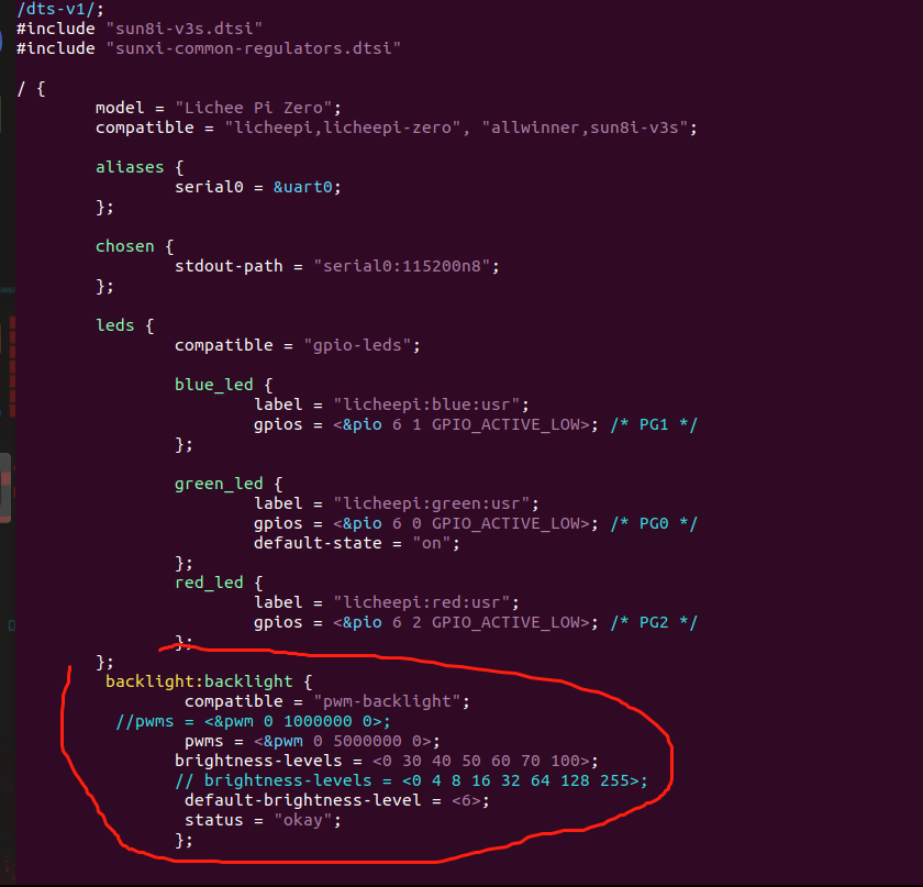

//pwms = <&pwm 0 1000000 0>;
pwms = <&pwm 0 5000000 0>;
//brightness-levels = <0 30 40 50 60 70 100>;
brightness-levels = <0 4 8 16 32 64 128 255>;
default-brightness-level = <6>;

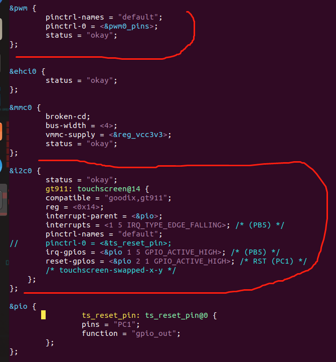

&pwm {
pinctrl-names = "default";
pinctrl-0 = <&pwm1_pins>;
pwm1_pins: pwm1 {
pins = "PB5";
function = "pwm1";
#9 2020-11-10 19:43:09

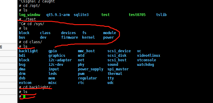

ls /sys/class/backlight/backlight/
actual_brightness device scale uevent
bl_power max_brightness subsystem
brightness power type
echo 1 > /sys/class/backlight/backlight/bl_power 可以关闭背光
echo 0 > /sys/class/backlight/backlight/bl_power 可以打开背光
echo 6 > /sys/class/backlight/backlight/brightness 最大为6,设备树定义的没生效?
echo 7 > /sys/class/backlight/backlight/brightness
sh: write error: Invalid argument
cat /sys/class/backlight/backlight/max_brightness
6

backlight: backlight {
compatible = "pwm-backlight";
default-brightness-level = <100>;
brightness-levels = <0 10 20 30 40 50 60 70 80 90 100>;
default-brightness-level = <80>;
power-supply = <&reg_vcc3v3>;
enable-gpios = <&pio 1 4 0>;
post-pwm-on-delay-ms = <10>;
pwm-off-delay-ms = <10>;
#18 2021-04-03 01:09:29

我的背光也没有
设备树如下

/dts-v1/;
#include "sun8i-v3s.dtsi"
#include "sunxi-common-regulators.dtsi"
	model = "Lichee Pi Zero";
	compatible = "licheepi,licheepi-zero", "allwinner,sun8i-v3s";
	aliases {
		serial0 = &uart0;
		default-brightness-level = <30>;

我的sys/class/backlight 啥都没,是什么问题,没办法驱动显示屏背光,设备树配置好了 PWMpb4,也编译了。什么问题

我自行解决了,在 sun8i-v3s-licheepi-zero.dts 把backlight 代码改一下移植进去,然后内核编译dtb,然后把对应的dtb拉进去就有了,然后可以控制开关背光,可以ech 0-6等级暗度

用的linux-5.2. 用的是电容屏。 后来看了看原来 官方的自带的设备文件dts(编译要加入到开发板的文件dtb)没有backlight的,backlight配置在另外一个ts文件,在LCD_800*480dts文件移植过去的。然后也要在内核编译 驱动选择 pwm backlight lcd。然后接好线就可以了.
		pwms = <&pwm 0 50000 0>;
		default-brightness-level = <4>;
        //enable-gpios = <&pio 1 5 0>;
        //post-pwm-on-delay-ms = <10>;
        //pwm-off-delay-ms = <10>;
&pwm {
      //pinctrl-0 = <&pwm0_pins>,<&pwm1_pins>;
	  pinctrl-0 = <&pwm0_pins>;
pb4可以用做背光,pb5就不行。
