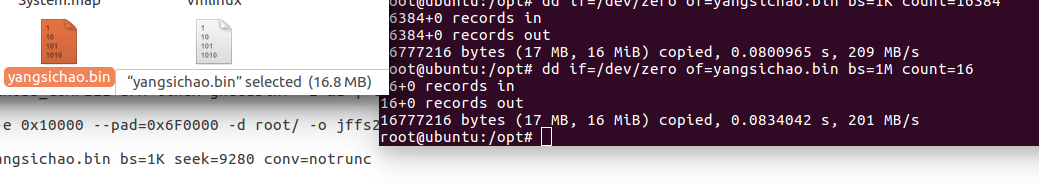

dd if=/dev/zero of=flashimg.bin bs=1M count=16 为什么出来的文件是大于16M
我用上面的语句生成一个空文件,大小的是16M
就会出现上面的文件大小 , 因为我的flash 是16M的 这里生成出来是16.8M了
#2 2018-09-19 14:23:41
已发帖子: 9,520
Re: dd if=/dev/zero of=flashimg.bin bs=1M count=16 为什么出来的文件是大于16M
16777216 = 0x1000000 = 16MiB = 16.8MB
1024B = 1KiB = 1.024 KB
你按上面的算一下.

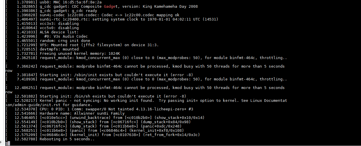

我现在是要通过jffs2去启动 板子 还是有点问题 不知道是那一块出现了问题
#4 2018-09-19 14:35:11
已发帖子: 9,520
文件系统挂载成功了,但是 /sbin/init 不能执行, /bin/sh 也不能执行.
楼主 #5 2018-09-19 14:55:00
无情一刀
注册时间: 2018-09-04
已发帖子: 723
积分: 690
刚才重新换了一个文件系统 重新编译后 出现下面的 应该是成功了 你看看呗 晕哥

[ 1.721299] VFS: Mounted root (jffs2 filesystem) on device 31:3.
[ 1.728515] devtmpfs: mounted
[ 1.732781] Freeing unused kernel memory: 1024K
[ 2.362518] request_module: kmod_concurrent_max (0) close to 0 (max_modprobes: 50), for module binfmt-464c, throttling.. .
[ 7.366242] request_module: modprobe binfmt-464c cannot be processed, kmod busy with 50 threads for more than 5 seconds now
[ 7.381847] Starting init: /sbin/init exists but couldn't execute it (error -8)
[ 7.418936] request_module: kmod_concurrent_max (0) close to 0 (max_modprobes: 50), for module binfmt-464c, throttling.. .
[ 12.486251] request_module: modprobe binfmt-464c cannot be processed, kmod busy with 50 threads for more than 5 seconds now
[ 12.501882] Starting init: /bin/sh exists but couldn't execute it (error -8)
[ 12.520217] Kernel panic - not syncing: No working init found. Try passing init= option to kernel. See Linux Documentat ion/admin-guide/init.rst for guidance.
[ 12.534370] CPU: 0 PID: 1 Comm: swapper/0 Not tainted 4.13.16-licheepi-zero+ #3
[ 12.541666] Hardware name: Allwinner sun8i Family
[ 12.546405] [<c010e5cc>] (unwind_backtrace) from [<c010b2b0>] (show_stack+0x10/0x14)
[ 12.554149] [<c010b2b0>] (show_stack) from [<c06716fc>] (dump_stack+0x84/0x98)
[ 12.561374] [<c06716fc>] (dump_stack) from [<c011b6e8>] (panic+0xdc/0x248)
[ 12.568251] [<c011b6e8>] (panic) from [<c06846c4>] (kernel_init+0xf8/0x108)
[ 12.575209] [<c06846c4>] (kernel_init) from [<c0107638>] (ret_from_fork+0x14/0x3c)
[ 12.582780] Rebooting in 5 seconds..
