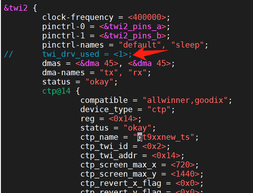

H133 使用触摸屏出错 evtest dev/input/event3
# evtest dev/input/event3

[   87.952114] i2c i2c2: Timeout when sending 9th SCL clk
[   87.957922] i2c i2c2: incomplete xfer, (status: 0x1, dev addr: 0x14)
[   87.965072] 0x02502a00: 01011001 00000001 00002900 0002000a
[   87.971516] 0x02502a10: 000080c0 00010004 000a0010 00000002
[   87.977945] i2c i2c2: Timeout when sending 9th SCL clk
[   87.983740] i2c i2c2: incomplete xfer, (status: 0x1, dev addr: 0x14)
[   87.990925] 0x02502a00: 01011001 00000001 00002900 0002000a
[   87.997316] 0x02502a10: 000080c0 00010004 000a0010 00000002
[   88.003697] i2c i2c2: Timeout when sending 9th SCL clk
[   88.009492] i2c i2c2: incomplete xfer, (status: 0x1, dev addr: 0x14)
[   88.016653] 0x02502a00: 01011001 00000001 00002900 0002000a
[   88.023009] 0x02502a10: 000080c0 00010004 000a0010 00000002
[   88.029399] i2c i2c2: Timeout when sending 9th SCL clk
[   88.035184] i2c i2c2: incomplete xfer, (status: 0x1, dev addr: 0x14)
[   88.042350] 0x02502a00: 01011001 00000001 00002900 0002000a
[   88.042360] 0x02502a10: 000080c0 00010004 000a0010 00000002
[   88.055103] i2c i2c2: Timeout when sending 9th SCL clk
[   88.060897] i2c i2c2: incomplete xfer, (status: 0x1, dev addr: 0x14)
[   88.068048] 0x02502a00: 01011001 00000001 00002900 0002000a
[   88.074402] 0x02502a10: 000080c0 00010004 000a0010 00000002
[   88.080777] <<-GTP-ERROR->> I2C Read: 0x814E, 10 bytes failed, errcode: -70! Process reset.
[   88.245298] <<-GTP-ERROR->> I2C transfer error. errno:-70

都对上了,还是一模一样的错误。
