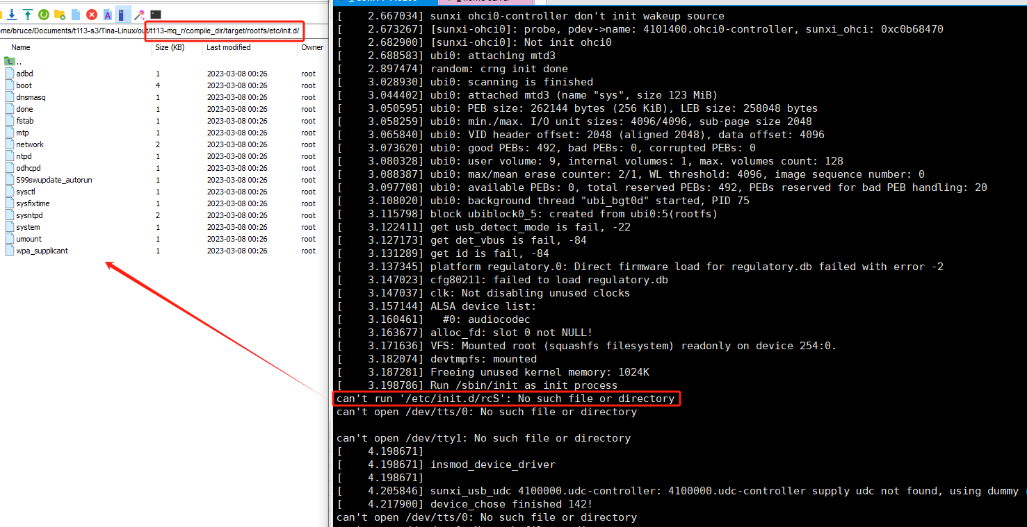

t113-s3 无法启动,提示/etc/init.d/rcS: No such file or directory
[    3.171636] VFS: Mounted root (squashfs filesystem) readonly on device 254:0.
[    3.182074] devtmpfs: mounted
[    3.187281] Freeing unused kernel memory: 1024K
[    3.198786] Run /sbin/init as init process
can't run '/etc/init.d/rcS': No such file or directory
can't open /dev/tts/0: No such file or directory
can't open /dev/tty1: No such file or directory
[    4.198671]
[    4.198671] insmod_device_driver
[    4.198671]
[    4.205846] sunxi_usb_udc 4100000.udc-controller: 4100000.udc-controller supply udc not found, using dummy regulator
[    4.217900] device_chose finished 142!
看init.d文件夹里面确实没有 rcS 这个文件
Tina-Linux/out/t113-mq_r/compile_dir/target/rootfs/etc/init.d/
楼主 #1 2023-12-13 11:40:21
bigzhu
注册时间: 2023-08-30
已发帖子: 24
积分: 15
Re: t113-s3 无法启动,提示/etc/init.d/rcS: No such file or directory
已解决。
tina linux init程序需要使用busybox的init,之前调成prodc init了。
