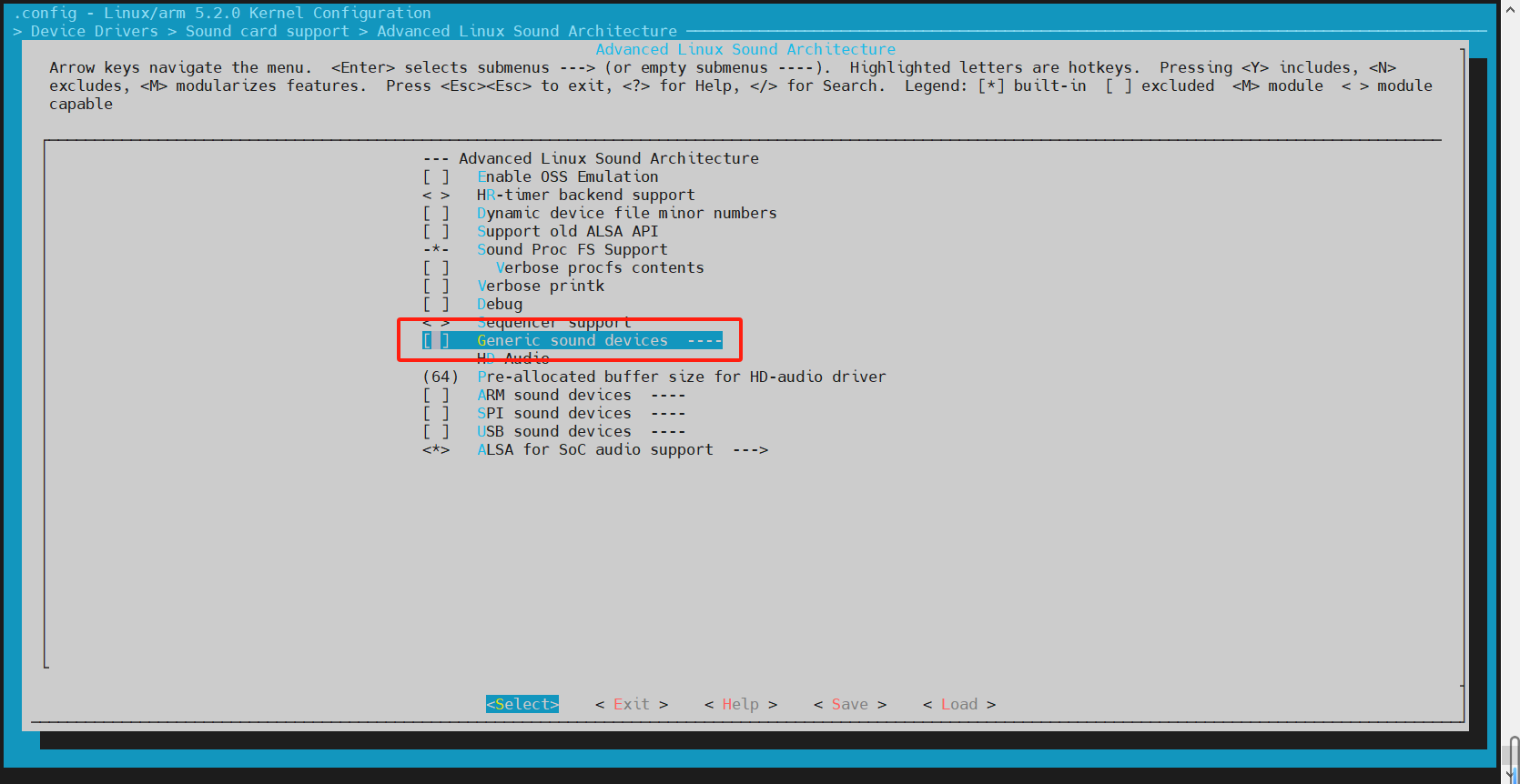

我已经按照这个教程来了,启动日志也有加载声卡
[    1.865834] ALSA device list:
[    1.868942]   #0: Loopback 1
[    1.871826]   #1: F1C100s Audio Codec使用命令查看声卡也有
[root@lmnb:~]$ cat /proc/asound/cards
 0 [Loopback       ]: Loopback - Loopback
                      Loopback 1
 1 [Codec          ]: F1C100s_Audio_C - F1C100s Audio Codec
                      F1C100s Audio Codec为什么我用mplayer -ao alsa xxx.mp3就报这样的错呢
No such audio driver 'alsa'
Could not open/initialize audio device -> no sound.
Audio: no sound
Video: no video用这个命令也是tinymix contents,跳出一堆奇奇怪怪的东西,我看别看只有13个的,我这怎么会有96个,还全是重复的
