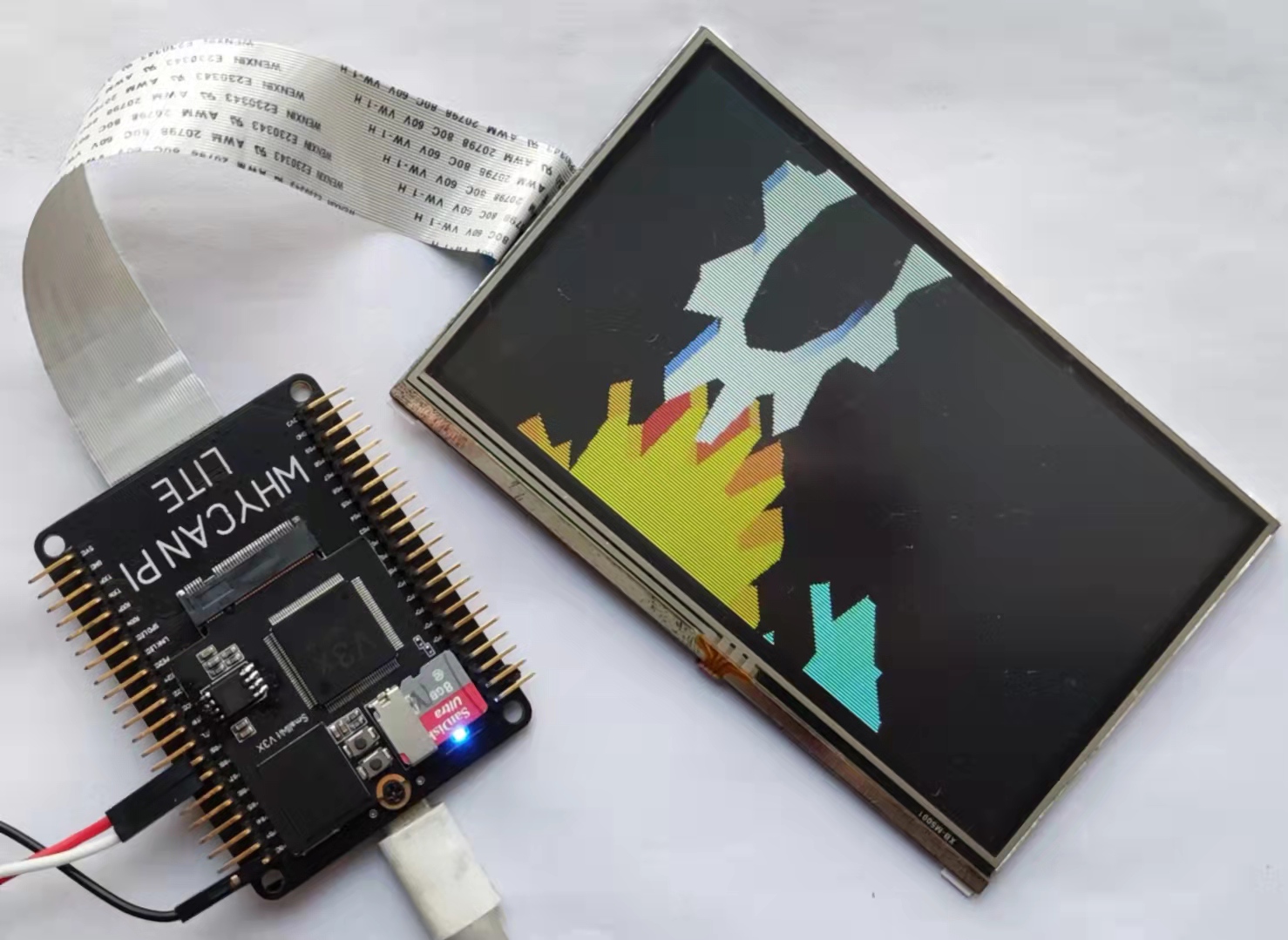

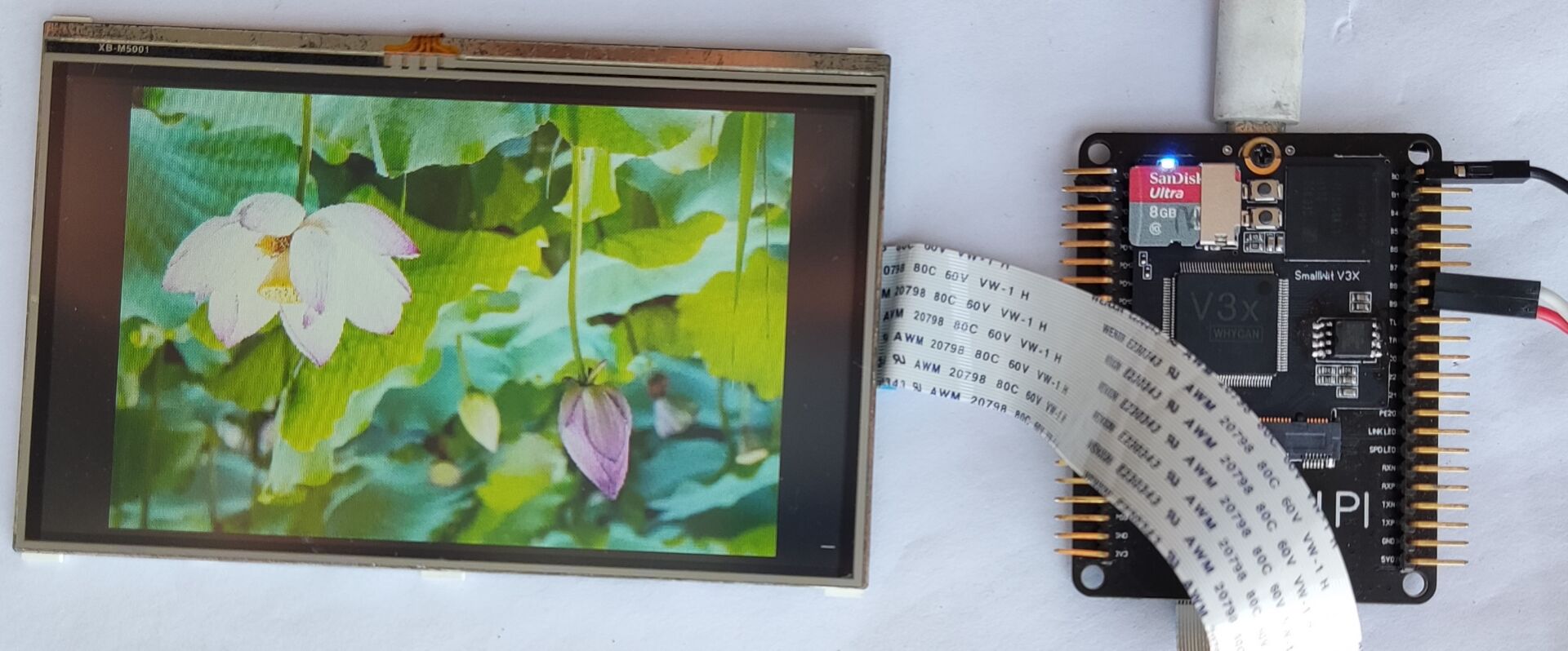

小智V3x开发板16M SPI NOR /TFCARD 固件,分辨率480x272:
firmware-smallwitpi-lite-v1-spinor-uart0-pb8-pb9-480x272-开机显示一朵荷花.7z
小智V3x开发板TFCard 固件,分辨率480x272:
firmware-smallwitpi-lite-v1-sdcard-uart0-pb8-pb9-480x272-开机显示一朵荷花.7z
克隆:
git clone https://github.com/buildroot/buildroot -b 2020.02.4
buildroot patch: br2_v3_uart0_pb8_pb9-spinor-tfcard-20211026132800.tgz
解压:
tar xvf br2_v3_uart0_pb8_pb9-spinor-tfcard-20211026132800.tgz
生成 V3s / S3L 固件:
make br2_smallwitpi_lite_v3_ddr2_uart0_pb8_pb9_tfcard_spinor_defconfig
生成 V3x / S3 固件:
make br2_smallwitpi_lite_v3_ddr3_uart0_pb8_pb9_tfcard_spinor_defconfig
电阻触摸屏触摸校正与测试(NS2009 I2C PB8/9, 中断: PB0 ):
TSLIB_TSDEVICE=/dev/input/event0 ts_calibrate
TSLIB_TSDEVICE=/dev/input/event0 ts_test

buildroot 源码补丁: smallwitpi_lite_patch_5inch_800x480_ns2009_rtp_20220222_src.tgz
5寸 800x480 电阻触摸屏固件: smallwitpi_lite_patch_5inch_800x480_ns2009_rtp_20220222_firmware.7z
