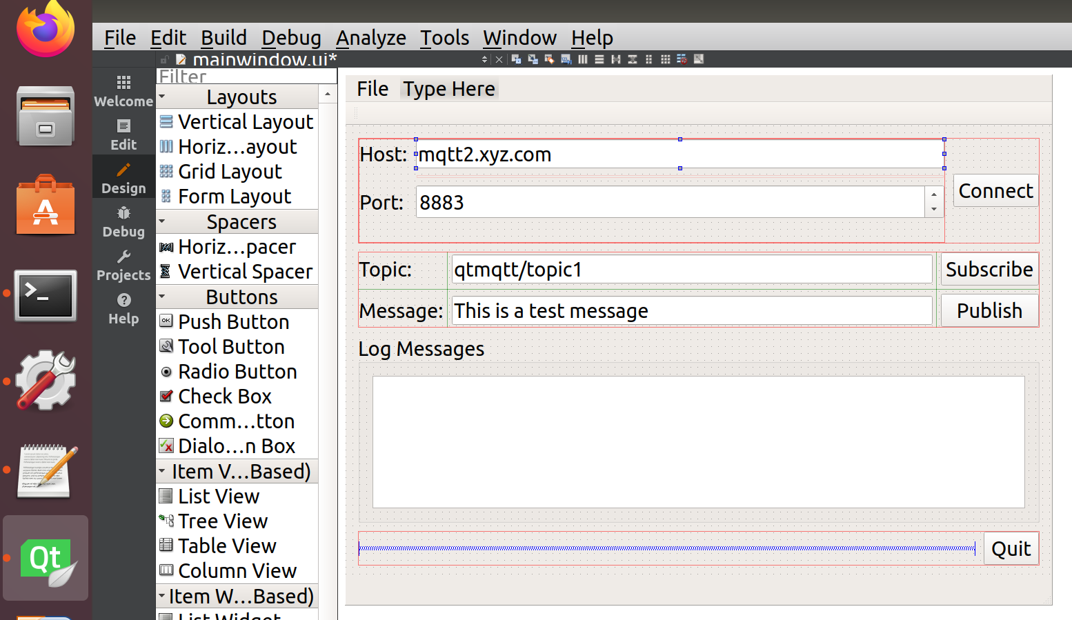

qt5mqtt-5.15.2 自带 simpleclient 没有 ssl 支持,添加几行代码支持一下
参考: https://stackoverflow.com/questions/57829480/how-do-i-perform-a-secure-mqtt-using-qtmqtt-and-ssl
    const QByteArray pem = R"(-----BEGIN CERTIFICATE-----
    MIIC8DCCAlmgAwIBAgIJAOD63PlXjJi8MA0GCSqGSIb3DQEBBQUAMIGQMQswCQYD
    VQQGEwJHQjEXMBUGA1UECAwOVW5pdGVkIEtpbmdkb20xDjAMBgNVBAcMBURlcmJ5
    MRIwEAYDVQQKDAlNb3NxdWl0dG8xCzAJBgNVBAsMAkNBMRYwFAYDVQQDDA1tb3Nx
    dWl0dG8ub3JnMR8wHQYJKoZIhvcNAQkBFhByb2dlckBhdGNob28ub3JnMB4XDTEy
    MDYyOTIyMTE1OVoXDTIyMDYyNzIyMTE1OVowgZAxCzAJBgNVBAYTAkdCMRcwFQYD
    VQQIDA5Vbml0ZWQgS2luZ2RvbTEOMAwGA1UEBwwFRGVyYnkxEjAQBgNVBAoMCU1v
    c3F1aXR0bzELMAkGA1UECwwCQ0ExFjAUBgNVBAMMDW1vc3F1aXR0by5vcmcxHzAd
    BgkqhkiG9w0BCQEWEHJvZ2VyQGF0Y2hvby5vcmcwgZ8wDQYJKoZIhvcNAQEBBQAD
    gY0AMIGJAoGBAMYkLmX7SqOT/jJCZoQ1NWdCrr/pq47m3xxyXcI+FLEmwbE3R9vM
    rE6sRbP2S89pfrCt7iuITXPKycpUcIU0mtcT1OqxGBV2lb6RaOT2gC5pxyGaFJ+h
    A+GIbdYKO3JprPxSBoRponZJvDGEZuM3N7p3S/lRoi7G5wG5mvUmaE5RAgMBAAGj
    UDBOMB0GA1UdDgQWBBTad2QneVztIPQzRRGj6ZHKqJTv5jAfBgNVHSMEGDAWgBTa
    d2QneVztIPQzRRGj6ZHKqJTv5jAMBgNVHRMEBTADAQH/MA0GCSqGSIb3DQEBBQUA
    A4GBAAqw1rK4NlRUCUBLhEFUQasjP7xfFqlVbE2cRy0Rs4o3KS0JwzQVBwG85xge
    REyPOFdGdhBY2P1FNRy0MDr6xr+D2ZOwxs63dG1nnAnWZg7qwoLgpZ4fESPD3PkA
    1ZgKJc2zbSQ9fCPxt2W3mdVav66c6fsb7els2W2Iz7gERJSX
    -----END CERTIFICATE-----
    QSslCertificate cert = QSslCertificate(pem, QSsl::Pem);
    QSslSocket::addDefaultCaCertificate(cert);
    m_client = new QMqttClient(this);
    m_client->setHostname(ui->lineEditHost->text());
    m_client->setPort(ui->spinBoxPort->value());
    m_client->setUsername("user"); //用户名
    m_client->setPassword("password");//密码
m_client->connectToHost();
改为 ==>
m_client->connectToHostEncrypted();
下载:simplemqttclient.tar
