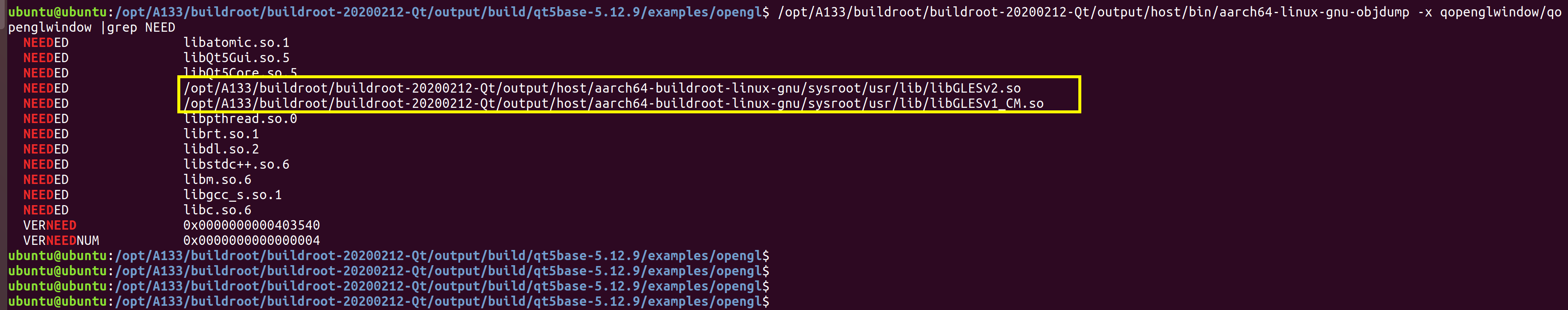

奇怪,这个buildroot Qt5依赖的库路径好神奇
$ /opt/A133/buildroot/buildroot-20200212-Qt/output/host/bin/aarch64-linux-gnu-objdump -x qopenglwindow/qopenglwindow |grep NEED
  NEEDED               libatomic.so.1
  NEEDED               libQt5Gui.so.5
  NEEDED               libQt5Core.so.5
  NEEDED               /opt/A133/buildroot/buildroot-20200212-Qt/output/host/aarch64-buildroot-linux-gnu/sysroot/usr/lib/libGLESv2.so
  NEEDED               /opt/A133/buildroot/buildroot-20200212-Qt/output/host/aarch64-buildroot-linux-gnu/sysroot/usr/lib/libGLESv1_CM.so
  NEEDED               libpthread.so.0
  NEEDED               librt.so.1
  NEEDED               libdl.so.2
  NEEDED               libstdc++.so.6
  NEEDED               libm.so.6
  NEEDED               libgcc_s.so.1
  NEEDED               libc.so.6
  VERNEED              0x0000000000403540
  VERNEEDNUM           0x0000000000000004

不知道是不是buildroot的eglfs的bug,生成的elf都是依赖绝对路径
找到patchelf 命令可以直接修改elf文件:
patchelf --replace-needed /opt/A133/buildroot/buildroot-20200212-Qt/output/host/aarch64-buildroot-linux-gnu/sysroot/usr/lib/libGLESv2.so libGLESv2.so qopenglwindow/qopenglwindow
patchelf --replace-needed /opt/A133/buildroot/buildroot-20200212-Qt/output/host/aarch64-buildroot-linux-gnu/sysroot/usr/lib/libGLESv1_CM.so libGLES_CM.so qopenglwindow/qopenglwindow
看结果:
$ /opt/A133/buildroot/buildroot-20200212-Qt/output/host/bin/aarch64-linux-gnu-objdump -x /opt/A133/buildroot/buildroot-20200212-Qt/output/build/qt5base-5.12.9/examples/opengl/qopenglwindow/qopenglwindow |grep NEED
  NEEDED               libGLESv2.so
  NEEDED               libGLES_CM.so
  NEEDED               librt.so.1
  NEEDED               libdl.so.2
  NEEDED               libm.so.6
  NEEDED               libc.so.6
参考: https://forum.qt.io/topic/101590/absolute-paths-to-egl-library-in-libqt5gui-so-since-qt-5-12-1/13

跟踪了一下,貌似 so 文件缺 SONAME 节点引起:
$ /opt/A133/buildroot/buildroot-20200212-Qt/output/host/bin/aarch64-linux-gnu-readelf -d ./output/build/sunxi-mali-mainline-d691cb93884ca8ac67860502117bbec283dc19aa/r6p2/arm64/fbdev/libGLESv2.so |grep SONAME
$ /opt/A133/buildroot/buildroot-20200212-Qt/output/host/bin/aarch64-linux-gnu-readelf -d /opt/A133/tina4/package/libs/libgpu/ge8300/fbdev/glibc/lib64/libGLESv2.so |grep SONAME
 0x000000000000000e (SONAME)             Library soname: [libGLESv2.so.2]
楼主 #4 2024-07-23 09:50:11
memory
注册时间: 2021-08-11
已发帖子: 708
积分: 683
Re: 奇怪,这个buildroot Qt5依赖的库路径好神奇
搞定了,换另外一套带SONAME节点的so文件库就好了。
另外一个解决办法,给这些so文件用patchelf手动打上SONAME也可以解决,但是我没有测试。
