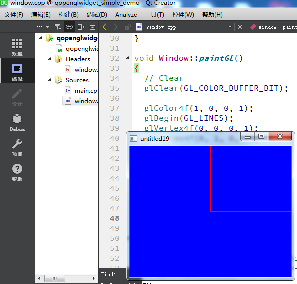

window.cpp
#include "window.h"
#include <QDebug>
#include <QString>
Window::~Window()
  makeCurrent();
  teardownGL();
 * OpenGL Events
void Window::initializeGL()
  // Initialize OpenGL Backend
  initializeOpenGLFunctions();
  printContextInformation();
  // Set global information
  glClearColor(0.0f, 0.0f, 1.0f, 1.0f);
void Window::resizeGL(int width, int height)
  // Currently we are not handling width/height changes
  (void)width;
  (void)height;
void Window::paintGL()
  // Clear
  glClear(GL_COLOR_BUFFER_BIT);
  glColor4f(1, 0, 0, 1);
  glBegin(GL_LINES);
  glVertex4f(0, 0, 0, 1);
  glVertex4f(0, 1, 0, 1);
  glVertex4f(1, 0, 0, 1);
  glVertex4f(0, 0, 1, 1);
  glEnd();
void Window::teardownGL()
  // Currently we have no data to teardown
 * Private Helpers
void Window::printContextInformation()
  QString glType;
  QString glVersion;
  QString glProfile;
  // Get Version Information
  glType = (context()->isOpenGLES()) ? "OpenGL ES" : "OpenGL";
  glVersion = reinterpret_cast<const char*>(glGetString(GL_VERSION));
  // Get Profile Information
#define CASE(c) case QSurfaceFormat::c: glProfile = #c; break
  switch (format().profile())
    CASE(NoProfile);
    CASE(CoreProfile);
    CASE(CompatibilityProfile);
#undef CASE
  // qPrintable() will print our QString w/o quotes around it.
  qDebug() << qPrintable(glType) << qPrintable(glVersion) << "(" << qPrintable(glProfile) << ")";
window.h
#ifndef WINDOW_H
#define WINDOW_H
#include <QOpenGLWindow>
#include <QOpenGLFunctions>
class Window : public QOpenGLWindow,
               protected QOpenGLFunctions
  Q_OBJECT
// OpenGL Events
public:
  ~Window();
  void initializeGL();
  void resizeGL(int width, int height);
  void paintGL();
  void teardownGL();
private:
  // Private Helpers
  void printContextInformation();
#endif // WINDOW_H
本站下载: qopenglwidget_simple_demo_2021010714.7z

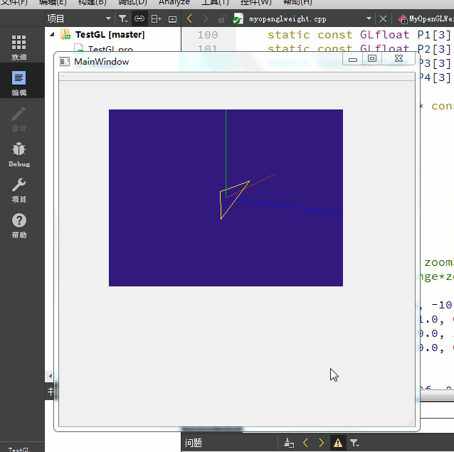

#include "myopenglweight.h"
#include <math.h>
MyOpenGLWeight::MyOpenGLWeight(QWidget *parent, Qt::WindowFlags f) :
    QOpenGLWidget(parent, f)
//    QSurfaceFormat format;
//    format.setDepthBufferSize(24);
//    format.setStencilBufferSize(8);
//    format.setVersion(3, 2);
//    format.setProfile(QSurfaceFormat::CoreProfile);
//    setFormat(format);
    rotationX = 0.0;
    rotationY = 0.0;
    rotationZ = 0.0;
    faceColor[0] = Qt::red;
    faceColor[1] = Qt::green;
    faceColor[2] = Qt::blue;
    faceColor[3] = Qt::yellow;
MyOpenGLWeight::~MyOpenGLWeight()
void MyOpenGLWeight::initializeGL()
    //QOpenGLFunctions *f = QOpenGLContext::currentContext()->functions();
    glClearColor(0.2f, 0.1f, 0.5f, 1.0f);
    glEnable(GL_DEPTH_TEST);
void MyOpenGLWeight::resizeGL(int w, int h)
    glViewport(0, 0, w, h);
    glMatrixMode(GL_PROJECTION);
    glLoadIdentity();
    GLfloat x = GLfloat(w) / h;
    glFrustum(-x, +x, -1, +1, 5.0, 30.0);
    glMatrixMode(GL_MODELVIEW);
void MyOpenGLWeight::paintGL()
    glClear(GL_COLOR_BUFFER_BIT | GL_DEPTH_BUFFER_BIT);
    draw();
void MyOpenGLWeight::mousePressEvent(QMouseEvent *event)
    if(event->button() == Qt::LeftButton)
        startPoint = event->pos();
    mouseMoveEvent(event);
void MyOpenGLWeight::mouseMoveEvent(QMouseEvent *event)
    if (event->buttons() & Qt::LeftButton)
        QPoint movePoint = event->pos() - startPoint;
            rotationX += movePoint.y();
            rotationY += movePoint.x();
        update();
GLfloat ctrlpoints[4][3] = {
        { -4.0, -4.0, 0.0}, { -2.0, 4.0, 0.0},
        {2.0, -4.0, 0.0}, {4.0, 4.0, 0.0}};
void MyOpenGLWeight::draw()
    static const GLfloat P1[3] = {0.0, -1.0, 2.0};
    static const GLfloat P2[3] = {1.0, -1.0, -2.0};
    static const GLfloat P3[3] = {0.5, 1.0, 1.5};
    static const GLfloat P4[3] = {-1.0, 0.0, -1.5};
    static const GLfloat * const coords[4][3] = {
        {P1, P2, P3},
        {P1, P3, P4},
        {P1, P4, P2},
        {P2, P4, P3},
    glLoadIdentity();
    glTranslatef(0.0, 0.0, -10);
    glRotatef(rotationX, 1.0, 0.0, 0.0);
    glRotatef(rotationY, 0.0, 1.0, 0.0);
    glRotatef(rotationZ, 0.0, 0.0, 1.0);
    glBegin(GL_LINES);
    float s = 3;
    glColor3f(255.0, 0, 0);
    glVertex3f( 0, 0, 0 );
    glVertex3f( s, 0, 0 );
    glColor3f(0, 255.0, 0);
    glVertex3f( 0, s, 0 );
    glColor3f(0, 0, 255.0);
    glVertex3f( 0, 0, s );
    glEnd();
    glBegin(GL_LINE_STRIP);
        for (int i = 0; i <= 30; i++)
           glEvalCoord1f((GLfloat) i/30.0);
     glEnd();
     /* The following code displays the control points as dots. */
     glPointSize(5.0);
     glColor3f(1.0, 1.0, 0.0);
     glBegin(GL_POINTS);
        for (int i = 0; i < 4; i++)
           glVertex3fv(&ctrlpoints[i][0]);
     glEnd();
//    for(int i = 0; i < 4; ++i)
//        glBegin(GL_TRIANGLES);
//        glColor3f(faceColor[i].redF(), faceColor[i].greenF(), faceColor[i].blueF());
//        for(int j = 0; j < 4; ++j)
//            glVertex3f(coords[i][j][0], coords[i][j][1], coords[i][j][2]);
//        glEnd();
https://github.com/PhoebeTsou/TestGL.git
本站下载: TestGL.7z

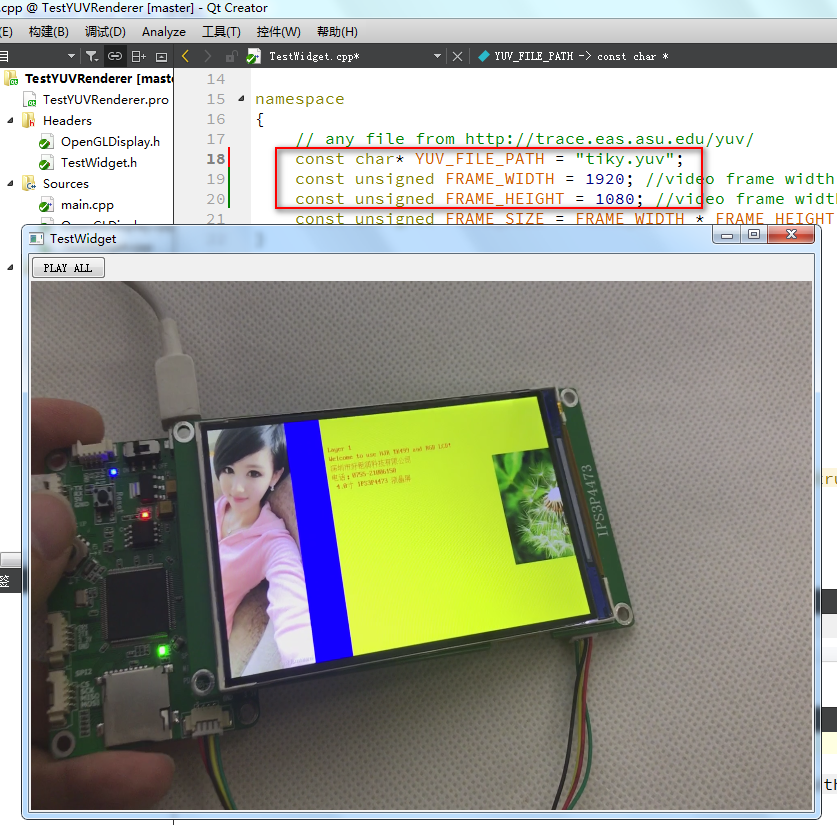

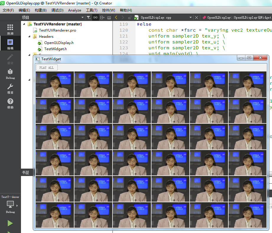

Qt5 用 OpenGL 把 YUV 转 RGB显示到 Widget的故事: https://github.com/MasterAler/SampleYUVRenderer
YUV测试文件这里下载: http://trace.eas.asu.edu/yuv/
解压、改名test.yuv复制到 bin 目录即可运行。
也可以本站下载
源码: SampleYUVRenderer_git.7z
YUV: akiyo_cif.7z

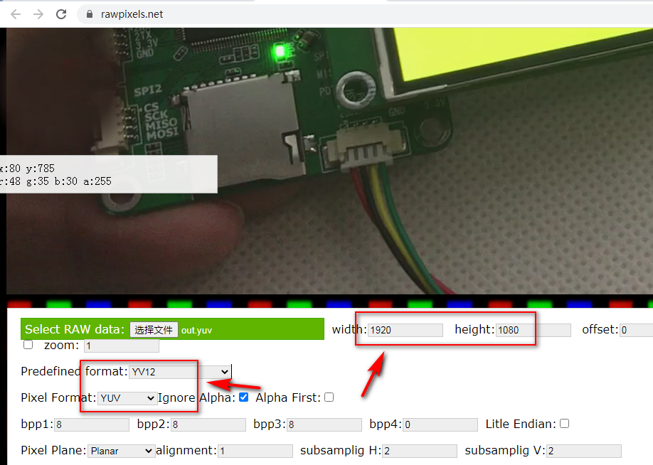

顺手推荐一个在线显示YUV/RGB格式文件的网站: https://rawpixels.net/

ffmpeg 转码 MOV/MP4 文件到 yuv, 尺寸 1920x1080:
ffmpeg -i tiky.mov tiky.yuv
如果只需生成一帧, 用这个命令
ffmpeg -i tiky.mov -vframes 1 tiky.yuv
拉轰的脚踏车 说:
视频素材来源:
TKM32F499配4.0寸IPS屏在RGB888模式下截屏功能
http://whycan.com/t_5830.html
(出处:哇酷开发者社区【好钜润半导体(TIKY)】)
最近编辑记录 拉轰的脚踏车 (2021-01-09 15:09:48)

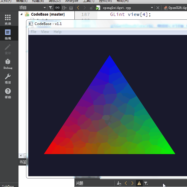

https://github.com/james-yoo/CodeBase
#include <math.h>
    zoomScale = 1.0f;
    rotationX = 0.0;
    rotationY = 0.0;
    rotationZ = 0.0;
    glLoadIdentity();
    draw();
        update();
void MyOpenGLWeight::wheelEvent(QWheelEvent *event)
    QPoint numDegrees = event->angleDelta();
    if (numDegrees.y() < 0)  zoomScale = zoomScale/1.1;
    if (numDegrees.y() > 0)  zoomScale = zoomScale*1.1;
    paintGL(); // call paintGL()
    //update();
        {P1, P2, P3},
        {P1, P3, P4},
        {P1, P4, P2},
        {P2, P4, P3},
    int range = 1000;
    glLoadIdentity();
    int height = 320;
    int width = 240;
    //glScalef(zoomScale, zoomScale, zoomScale);
        //glOrtho(-0.5*range*zoomScale, +0.5*range*zoomScale, -0.5*height/width*range*zoomScale, +0.5*height/width*range*zoomScale, -5*range, +5*range);
    glBegin(GL_LINES);
    glVertex3f(-0.6f, -0.3f, 0.2f);
    glVertex3f(0.6f, 0.3f, 0.3f);
    glVertex3f(0.1f, 0.1f, -0.2f);
    glEnd();
    glBegin(GL_LINES);
    float s = 3;
    glEnd();
     glEnd();
     glPointSize(5.0);
     glBegin(GL_POINTS);
     glEnd();
//        glEnd();
本站下载: qt_opengl_zoom.7z

    //设置widget的坐标和尺寸
    setGeometry(300, 150, 500, 500);
    //设置清除时颜色
    glClearColor(0.0, 0.0, 0.0, 0);
void Widget::resizeGL(int w, int h)
    //视口变换
    glViewport(0,0,(GLsizei)w,(GLsizei)h);
    //投影变换
    glLoadIdentity();
    gluPerspective(40.0,(GLdouble)w/(GLdouble)h,0.1,10000.0);
    //视图变换
    glLoadIdentity();
    gluLookAt(0.0,0.0,15.0,0.0,0.0,0.0,0.0,1.0,0.0);
void Widget::paintGL()
    //清屏
    //绘制七彩三角形
    glColor3f(1.0,0.0,0.0);
    glVertex3f(-2,0,0);
    glColor3f(0.0,1.0,0.0);
    glVertex3f(2,0,0);
    glColor3f(0.0,0.0,1.0);
    glVertex3f(0,4,0);
    glEnd();
    glFlush();
