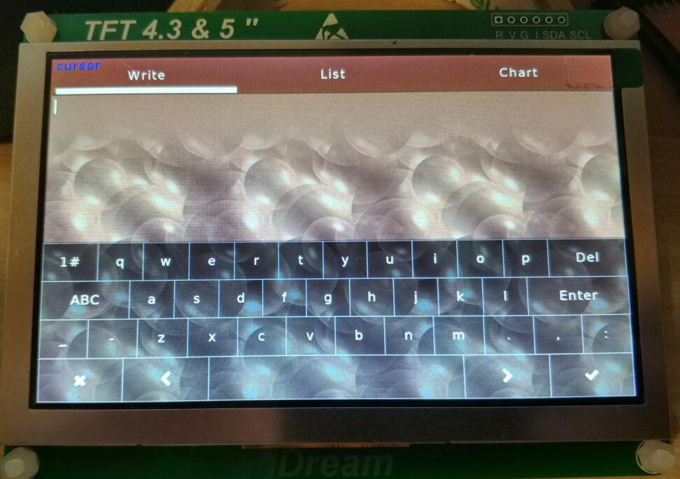

NUC972 RGB颜色反了求助
我的972颜色显示貌似反了,RGB貌似RG倒了,不知道能不能通过修改寄存器实现,MCU可以修改的,972是不是改驱动能将R和G翻转呢?

先试一下直接 /dev/fb0 单色(红绿蓝三基色).

这个改下gui的打点应该也可以。看了下手册,DEVICE_CTRL  显示输出控制寄存器,貌似也也可以设定

同遇到这个问题,为了拉线方便画的BGR,看手册RGB可以调换,但看不懂啥是first line data,啥是second line data。
Publication Release Date: Oct. 15, 2018
- 1123 - Revision V1.46
NUC970 TECHNICAL REFERENCE MANUAL
[18:17]
[LCD_ODD :
SEL_ODD]
Control LCD Line Data Out
00 = First line data is RGB, second line data is GBR.
01 = First line data is BGR, second line data is RBG.
10 = First line data is GBR, second line data is RGB.
11 = First line data is RBG, second line data is BGR.
如果能从内核驱动层改过来最好了,不想绘图程序时改。
