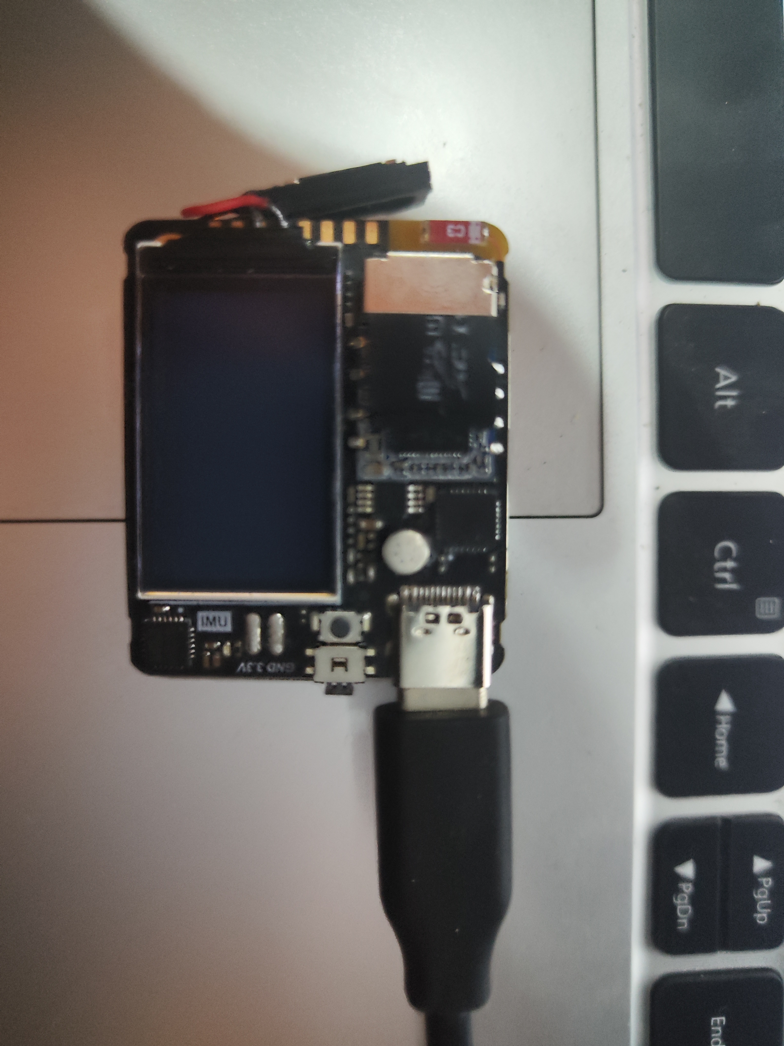

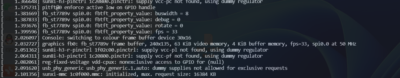

#3 全志 SOC » 求助,全志h3,内核6.74无法驱动fbtft st7789 134x240lcd » 2024-02-09 20:28:31
hech
回复: 1
板子是 quark-n 稚辉君开发
原本内核4.14 lcd可以正常使用
重新移植uboot和内核
内核版本6.7.4
结果
内核加载了,但是没有显示,跪求大佬帮忙
jt
设备树
&spi0 {
	/* needed to avoid dtc warning */
	#address-cells = <1>;
	#size-cells = <0>;
	mode = <3>;
	pinctrl-names = "default";
	pinctrl-0 = <&spi0_pins &spi0_cs_pins>;
	cs-gpios = <&pio 2 3 GPIO_ACTIVE_HIGH>, <&pio 0 6 GPIO_ACTIVE_HIGH>; /*SPI-CS:PC3 and PA6*/
	pitft: pitft@0{
		reg = <0>;
		rotate = <0>;
		fps = <33>;
		buswidth = <8>;
		dc-gpios = <&pio 0 11 GPIO_ACTIVE_HIGH>;	 /* PA11 */
		reset-gpios = <&pio 0 12 GPIO_ACTIVE_HIGH>; /* PA12 */
		// led-gpios = <&pio 0 0 GPIO_ACTIVE_LOW>;	 /* PA0 */
		debug = <0x7>;
		init = <0x2000032
				0x1000011
				0x2000012
				0x1000011
				0x100003a 0x05
				0x10000c5 0x1a
				0x1000036 0x70
				0x10000b2 0x05 0x05 0x00 0x33 0x33
				0x10000b7 0x35
				0x10000bb 0x3f
				0x10000c0 0x2c
				0x10000c2 0xc1
				0x10000c3 0x0f
				0x10000c4 0x20
				0x10000c6 0x11
				0x10000d0 0xa4 0xa1
				0x10000e8 0x03
				0x10000e9 0x09 0x09 0x08
				0x10000e0 0xd0 0x05 0x09 0x09 0x08 0x14 0x28 0x33 0x3f 0x07 0x13 0x14 0x28 0x30
				0x10000e1 0xd0 0x05 0x08 0x09 0x08 0x03 0x24 0x32 0x32 0x3b 0x14 0x13 0x28 0x2f
				0x1000021
				0x1000011
				0x2000078
				0x1000029
				0x20000c8>;
驱动文件
