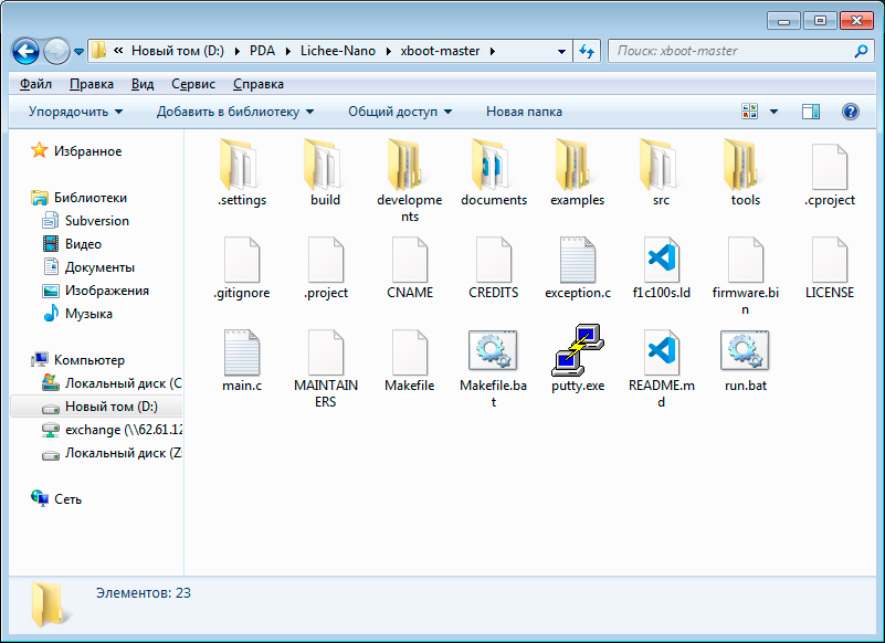

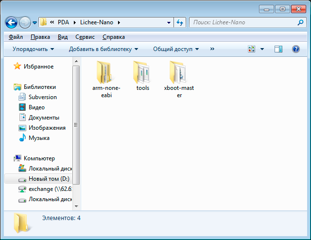

Toolchain - https://developer.arm.com/tools-and-software/open-source-software/developer-tools/gnu-toolchain/gnu-rm/downloads/8-2018-q4-major
XBoot - https://github.com/xboot/xboot
Tools - https://whycan.cn/files/members/4508/tools.zip
Work directory
XBoot directory + My zip arhive

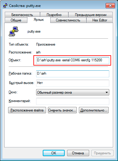

PUTTY setting

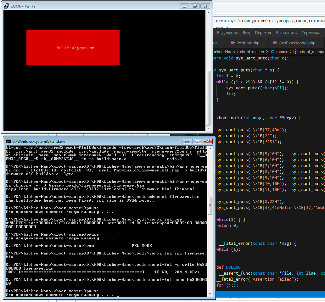

Minimal UART 0 for f1c100s...
https://whycan.cn/files/members/4508/uart.zip
