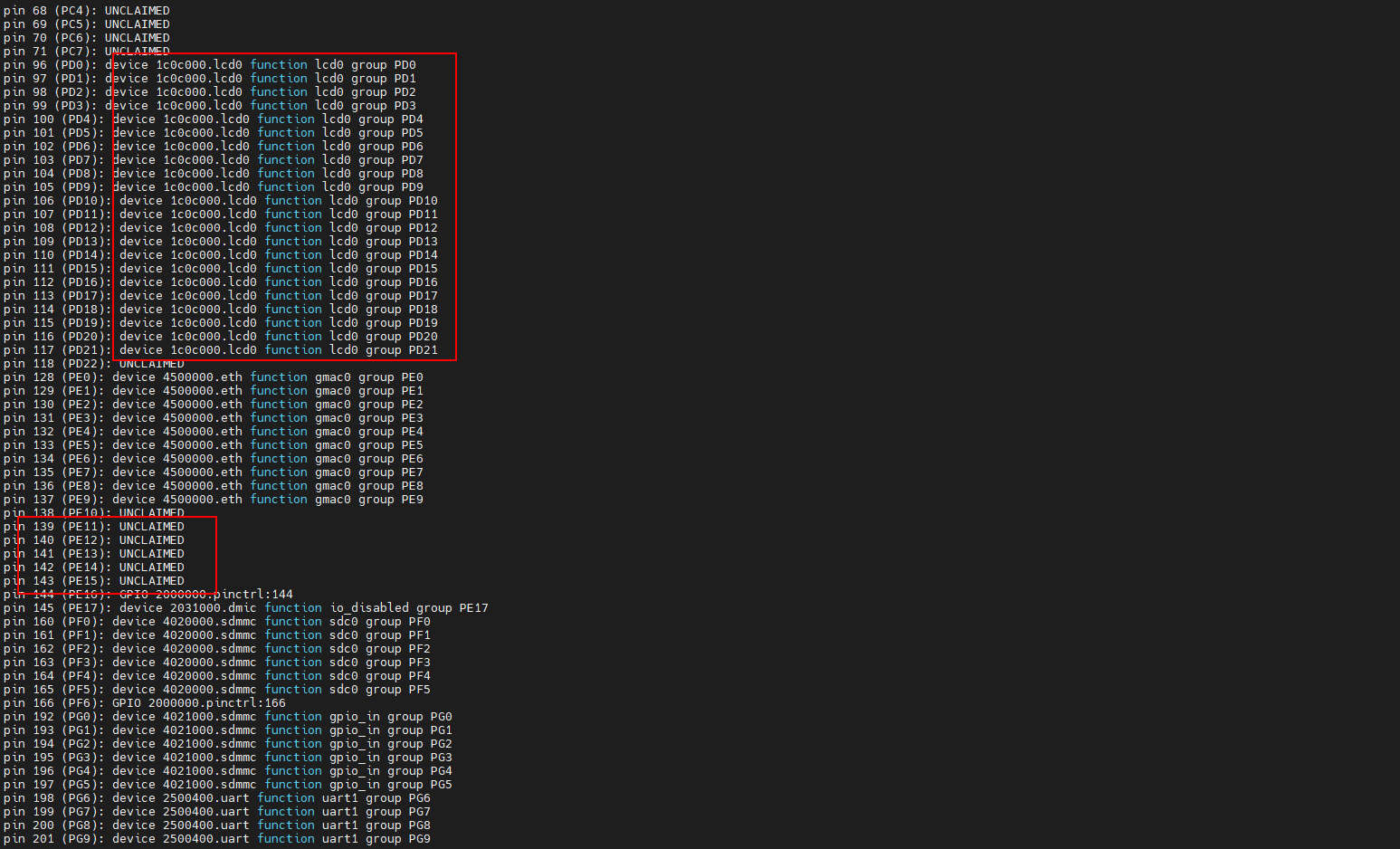

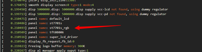

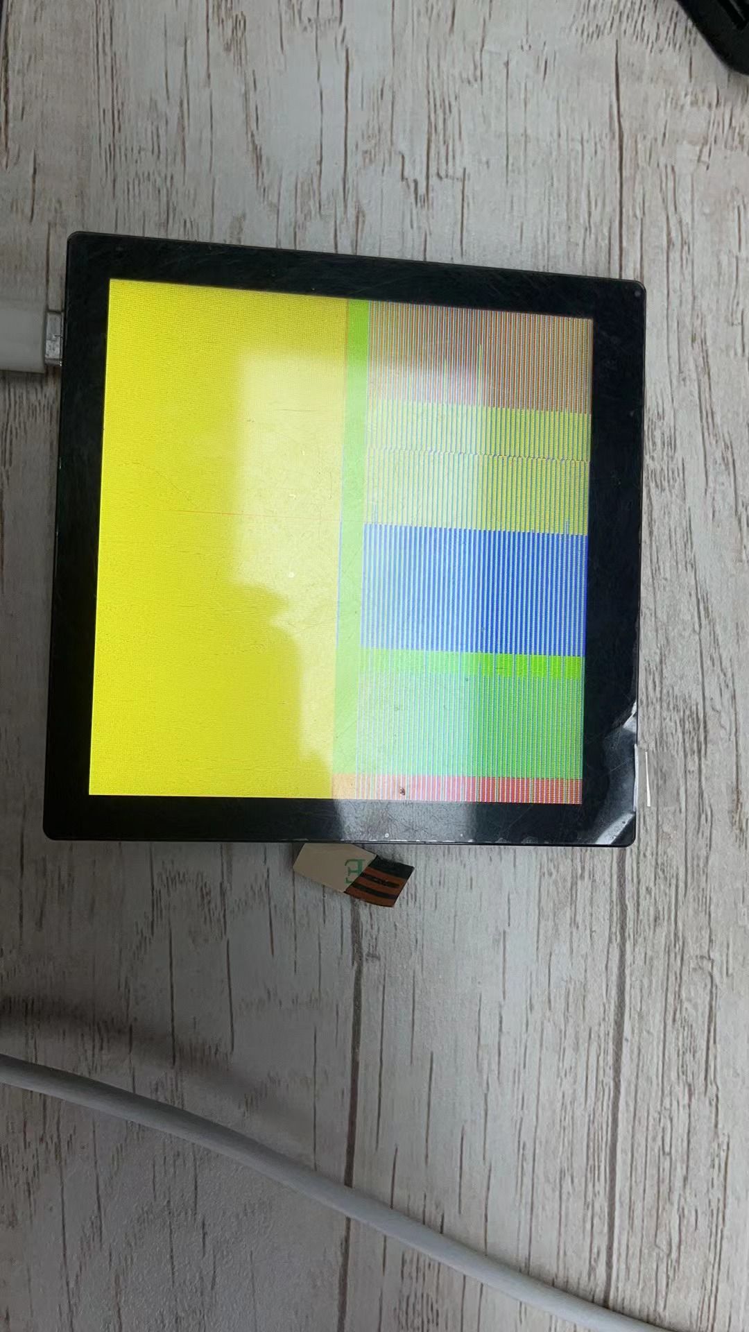

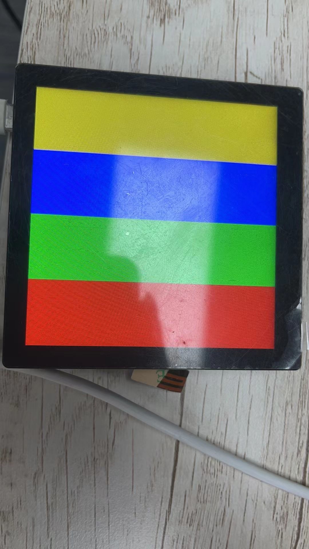

#4 全志 SOC » 解决LicheeRV 86 Panel在tina2.0配置lcd GPIO引脚及colorbar闪屏的问题 » 2022-09-16 10:11:26
神棍地海棠
回复: 0
设备树修改如下:
project device/config/chips/d1-h/

-	pinctrl-0       = <&daudio0_pins_a &daudio0_pins_b &daudio0_pins_c>;
-	pinctrl-1       = <&daudio0_pins_d>;
+	pinctrl-0       = <&daudio0_pins_a>;
+	pinctrl-1       = <&daudio0_pins_b>;
 	pinctrl_used	= <0x0>;
 	status = "disabled";
@@ -861,8 +870,8 @@ tvd_row*tvd_column is the total tvd channel number to be used in multichannel mo
 	pcm_lrck_period = <0x80>;
 	slot_width_select = <0x20>;
 	pinctrl-names   = "default", "sleep";
-	pinctrl-0       = <&daudio1_pins_a &daudio1_pins_b &daudio1_pins_c>;
-	pinctrl-1       = <&daudio1_pins_d>;
+	pinctrl-0       = <&daudio1_pins_a>;
+	pinctrl-1       = <&daudio1_pins_b>;

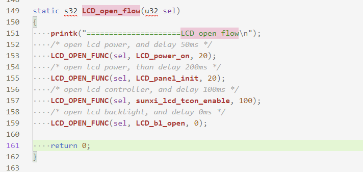

@@ -1279,57 +1249,50 @@ pull up or pull down(default 0), driver level(default 1), data>
 ;For lvds0: use lvds0_pins_a  and lvds0_pins_b instead
 &lcd0 {
-	lcd_used            = <1>;
-	lcd_driver_name     = "tft08006";
-	lcd_backlight       = <100>;
-	lcd_if              = <4>;
-	lcd_x               = <800>;
-	lcd_y               = <1280>;
-	lcd_width           = <52>;
-	lcd_height          = <52>;
-	lcd_dclk_freq       = <70>;
-	lcd_pwm_used        = <1>;
-	lcd_pwm_ch          = <2>;
-	lcd_pwm_freq        = <1000>;
-	lcd_pwm_pol         = <0>;
-	lcd_pwm_max_limit   = <255>;
-	lcd_hbp             = <32>;
-	lcd_ht              = <868>;
-	lcd_hspw            = <4>;
-	lcd_vbp             = <12>;
-	lcd_vt              = <1311>;
-	lcd_vspw            = <4>;
-	lcd_dsi_if          = <0>;
-	lcd_dsi_lane        = <4>;
-	lcd_lvds_if         = <0>;
-	lcd_lvds_colordepth = <0>;
-	lcd_lvds_mode       = <0>;
-	lcd_frm             = <0>;
-	lcd_hv_clk_phase    = <0>;
-	lcd_hv_sync_polarity= <0>;
-	lcd_io_phase        = <0x0000>;
-	lcd_gamma_en        = <0>;
+	lcd_used        = <1>;
+	lcd_driver_name = "st7701s_rgb";
+	lcd_if          = <0>;
+	lcd_hv_if       = <0>;
+	lcd_width       = <70>;
+	lcd_height      = <72>;
+	lcd_x           = <480>;
+	lcd_y           = <480>;
+	lcd_dclk_freq   = <19>;
+	lcd_hbp         = <60>;
+	lcd_ht          = <612>;
+	lcd_hspw        = <12>;
+	lcd_vbp         = <18>;
+	lcd_vt          = <520>;
+	lcd_vspw        = <4>;
+	lcd_backlight   = <50>;
+	lcd_pwm_used    = <1>;
+	lcd_pwm_ch      = <7>;
+	lcd_pwm_freq    = <20000>;
+	lcd_pwm_pol     = <1>;
 	lcd_bright_curve_en = <0>;
-	lcd_cmap_en         = <0>;
-	lcd_fsync_en        = <0>;
-	lcd_fsync_act_time  = <1000>;
-	lcd_fsync_dis_time  = <1000>;
-	lcd_fsync_pol       = <0>;
-	deu_mode            = <0>;
-	lcdgamma4iep        = <22>;
-	smart_color         = <90>;
-	lcd_gpio_0 =  <&pio PG 13 GPIO_ACTIVE_HIGH>;
-	pinctrl-0 = <&dsi4lane_pins_a>;
-	pinctrl-1 = <&dsi4lane_pins_b>;
+	lcd_frm         = <1>;
+	lcd_io_phase    = <0x0000>;
+	lcd_gamma_en    = <0>;
+	lcd_cmap_en     = <0>;
+	lcd_hv_clk_phase= <0>;
+	lcd_hv_sync_polarity= <0>;
+	lcd_rb_swap          = <0>;
+	lcd_power       = "vcc-lcd";
+	lcd_pin_power   = "vcc-pd";
+	lcd_gpio_0      = <&pio PG 13 GPIO_ACTIVE_HIGH>;
+	lcd_gpio_1      = <&pio PE 14 GPIO_ACTIVE_HIGH>;
+	lcd_gpio_2      = <&pio PE 12 GPIO_ACTIVE_HIGH>;
+	lcd_gpio_3      = <&pio PE 15 GPIO_ACTIVE_HIGH>;
+	pinctrl-0       = <&rgb18_pins_a>;
+	pinctrl-1       = <&rgb18_pins_b>;

@@ -261,57 +261,49 @@
 &lcd0 {
-	lcd_used            = <1>;
-	lcd_if              = <4>;
-	lcd_x               = <800>;
-	lcd_y               = <1280>;
-	lcd_width           = <52>;
-	lcd_pwm_ch          = <2>;
-	lcd_hbp             = <32>;
-	lcd_ht              = <868>;
-	lcd_hspw            = <4>;
-	lcd_vbp             = <12>;
-	lcd_vt              = <1311>;
-	lcd_vspw            = <4>;
-	lcd_dsi_if          = <0>;
-	lcd_frm             = <0>;
+	lcd_used        = <1>;
+	lcd_if          = <0>;
+	lcd_hv_if       = <0>;
+	lcd_width       = <70>;
+	lcd_x           = <480>;
+	lcd_y           = <480>;
+	lcd_hbp         = <60>;
+	lcd_ht          = <612>;
+	lcd_hspw        = <12>;
+	lcd_vbp         = <18>;
+	lcd_vt          = <520>;
+	lcd_vspw        = <4>;
+	lcd_pwm_ch      = <7>;
-	deu_mode            = <0>;
+	lcd_frm         = <1>;

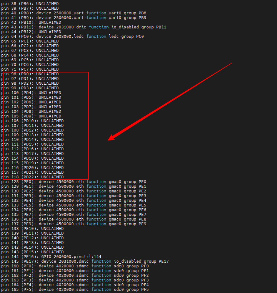

设备树修改参考了https://github.com/Tina-Linux/tina-d1x-lichee-rv和sipeed提供的licheerv_d1_compile。
使用以下命令
shell
cat /sys/kernel/debug/pinctrl/2000000.pinctrl/pinmux-pins
发现lcd的io均没有进行初始化
附上uboot的dts
 * Allwinner Technology CO., Ltd. sun20iw1p1 soc board.
 * soc board support.
&platform {
	eraseflag   = <1>;
	next_work   = <3>;
	debug_mode  = <1>;
&target {
	boot_clock = <1008>;	/*CPU boot frequency, Unit: MHz*/
	storage_type = <0xffffffff>; /*boot medium, 0-nand, 1-card0, 2-card2, -1(defualt)auto scan*/
	burn_key = <0>;		/*1:support burn key; 0:not support burn key*/
	dragonboard_test = <0>;	/*1:support card boot dragonboard; 0:not support card boot dragonboard*/
&charger0 {
	pmu_safe_vol = <3500>;
&twi6 {
	clock-frequency = <200000>;
	pinctrl-0 = <&s_twi0_pins_a>;
	no_suspend = <1>;
	twi_drv_used = <1>;
&pwm2_pin_a {
	pins = "PD18";
	function = "pwm2";
	muxsel = <5>;
	drive-strength = <10>;
	bias-pull-up;
&pwm2_pin_b {
	pins = "PD18";
	muxsel = <0>;
	function = "gpio_in";
&pwm2 {
	pinctrl-names = "active", "sleep";
	pinctrl-0 = <&pwm2_pin_a>;
	pinctrl-1 = <&pwm2_pin_b>;
&pwm7_pin_a {
	pins = "PD22";
	function = "pwm7";
	muxsel = <5>;
	bias-pull-up;
&pwm7_pin_b {
	pins = "PD22";
	muxsel = <0>;
&pwm7 {
	pinctrl-0 = <&pwm7_pin_a>;
	pinctrl-1 = <&pwm7_pin_b>;
&sdc0_pins_a {
	allwinner,pins = "PF0", "PF1", "PF2",
			 "PF3", "PF4", "PF5";
	allwinner,function = "sdc0";
	allwinner,muxsel = <2>;
	allwinner,drive = <3>;
	allwinner,pull = <1>;
	function = "sdc0";
	drive-strength = <30>;
	bias-pull-up;
	power-source = <3300>;
&sdc0_pins_b {
	function = "sdc0";
	bias-pull-up;
	power-source = <1800>;
&sdc0_pins_c {
&sdc2_pins_a {
	allwinner,pins = "PC2", "PC3", "PC4",
			 "PC5", "PC6", "PC7";
	allwinner,function = "sdc2";
	allwinner,muxsel = <3>;
	function = "sdc2";
	bias-pull-up;
&sdc2_pins_b {
&nand0_pins_a {
	allwinner,pins = "PC0", "PC1", "PC2", "PC5",
			 "PC8", "PC9", "PC10", "PC11",
			 "PC12", "PC13", "PC14", "PC15",
			 "PC16";
	allwinner,pname= "nand0_we", "nand0_ale","nand0_cle", "nand0_nre",
			 "nand0_d0", "nand0_d1", "nand0_d2", "nand0_d3",
			 "nand0_d4", "nand0_d5", "nand0_d6", "nand0_d7",
			 "nand0_ndqs";
	allwinner,function = "nand0";
	allwinner,drive = <1>;
	allwinner,pull = <0>;
&nand0_pins_b {
	allwinner,pins = "PC4", "PC6", "PC03", "PC07";
	allwinner,pname= "nand0_ce0", "nand0_rb0", "nand0_ce1", "nand0_rb1";
	allwinner,pull = <1>;	/* only RB&CE should be pulled up */
&nand0_pins_c {
	allwinner,pins = "PC0", "PC1", "PC2", "PC3",
			 "PC4", "PC5", "PC6", "PC7",
			 "PC16";
	allwinner,function = "io_disabled";
	allwinner,muxsel = <7>;
&card0_boot_para {  /* Avoid dtc compiling warnings. @TODO: Developer should modify this to the actual value */
	/* reg = <0x0 0x2 0x0 0x0>;  [> Avoid dtc compiling warnings. @TODO: Developer should modify this to the actual value <] */
	device_type = "card0_boot_para";
	card_ctrl = <0x0>;
	card_high_speed = <0x1>;
	card_line = <0x4>;
	pinctrl-0 = <&sdc0_pins_a>;
&card2_boot_para {  /* Avoid dtc compiling warnings. @TODO: Developer should modify this to the actual value */
	/* reg = <0x0 0x3 0x0 0x0>;  [> Avoid dtc compiling warnings. @TODO: Developer should modify this to the actual value <] */
	device_type = "card2_boot_para";
	card_ctrl = <0x2>;
	card_line = <0x4>;
	pinctrl-0 = <&sdc2_pins_a>;
	sdc_ex_dly_used = <0x2>;
	sdc_tm4_hs200_max_freq = <150>;
	sdc_tm4_hs400_max_freq = <100>;
&gpio_bias {  /* Avoid dtc compiling warnings. @TODO: Developer should modify this to the actual value */
	device_type = "gpio_bias";
&nand0 {
	compatible = "allwinner,sun20iw1-nand";
	device_type = "nand0";
	//reg = <0x0 0x04011000 0x0 0x1000>;/* nand0 */
	pinctrl-0 = <&nand0_pins_a &nand0_pins_b>;
	pinctrl-1 = <&nand0_pins_c>;
	nand0_regulator1 = "vcc-nand";
	nand0_regulator2 = "none";
	nand0_cache_level = <0x55aaaa55>;
	nand0_flush_cache_num = <0x55aaaa55>;
	nand0_capacity_level = <0x55aaaa55>;
	nand0_id_number_ctl = <0x55aaaa55>;
	nand0_print_level = <0x55aaaa55>;
	nand0_p0 = <0x55aaaa55>;
	nand0_p1 = <0x55aaaa55>;
	nand0_p2 = <0x55aaaa55>;
	nand0_p3 = <0x55aaaa55>;
	chip_code = "sun20iw1";
&disp {
	disp_init_enable         = <1>;
	disp_mode                = <0>;
	screen0_output_type      = <1>;
	screen0_output_mode      = <4>;
	screen1_output_type      = <3>;
	screen1_output_mode      = <10>;
	screen1_output_format    = <0>;
	screen1_output_bits      = <0>;
	screen1_output_eotf      = <4>;
	screen1_output_cs        = <257>;
	screen1_output_dvi_hdmi  = <2>;
	screen1_output_range     = <2>;
	screen1_output_scan      = <0>;
	screen1_output_aspect_ratio = <8>;
	dev0_output_type         = <1>;
	dev0_output_mode         = <4>;
	dev0_screen_id           = <0>;
	dev0_do_hpd              = <0>;
	dev1_output_type         = <4>;
	dev1_output_mode         = <10>;
	dev1_screen_id           = <1>;
	dev1_do_hpd              = <1>;
	def_output_dev           = <0>;
	hdmi_mode_check          = <1>;
	fb0_format               = <0>;
	fb0_width                = <0>;
	fb0_height               = <0>;
	fb1_format               = <0>;
	fb1_width                = <0>;
	fb1_height               = <0>;
	chn_cfg_mode             = <1>;
	disp_para_zone           = <1>;
	/*VCC-LCD*/
/*	dc1sw-supply = <&reg_dc1sw>;*/
	/*VCC-DSI*/
/*	eldo3-supply = <&reg_eldo3>;*/
	/*VCC-PD*/
/*	dcdc1-supply = <&reg_dcdc1>;*/
&lcd0 {
	lcd_used        = <1>;
	lcd_if          = <0>;
	lcd_hv_if       = <0>;
	lcd_width       = <70>;
	lcd_height      = <72>;
	lcd_x           = <480>;
	lcd_y           = <480>;
	lcd_hbp         = <60>;
	lcd_ht          = <612>;
	lcd_hspw        = <12>;
	lcd_vbp         = <18>;
	lcd_vt          = <520>;
	lcd_vspw        = <4>;
	lcd_pwm_used    = <1>;
	lcd_pwm_ch      = <7>;
	lcd_pwm_pol     = <1>;
	lcd_frm         = <1>;
	lcd_gamma_en    = <0>;
	lcd_cmap_en     = <0>;
&hdmi {
	hdmi_used = <1>;
	hdmi_power_cnt = <0>;
	hdmi_hdcp_enable = <1>;
	hdmi_hdcp22_enable = <0>;
	hdmi_cec_support = <1>;
	hdmi_cec_super_standby = <0>;
	ddc_en_io_ctrl = <0>;
	power_io_ctrl = <0>;
&aliases {
	nand0 = &nand0;
	twi6 = &twi6;
	pwm = &pwm;
	pwm0 = &pwm0;
	pwm1 = &pwm1;
	pwm2 = &pwm2;
	pwm3 = &pwm3;
	pwm4 = &pwm4;
	pwm5 = &pwm5;
	pwm6 = &pwm6;
	pwm7 = &pwm7;
	disp = &disp;
	hdmi = &hdmi;
	lcd0 = &lcd0;
	lcd1 = &lcd1;
	eink = &eink;
	spi0 = &spi0;
附上log
[34]HELLO! BOOT0 is starting!
[37]BOOT0 commit : 88480af
[39]set pll start
[41]periph0 has been enabled
[44]set pll end
[45][pmu]: bus read error
[48]board init ok
[50]get_pmu_exist() = -1
[52]ddr_efuse_type: 0x0
[54]trefi:7.8ms
[56][AUTO DEBUG] single rank and full DQ!
[60]ddr_efuse_type: 0x0
[63]trefi:7.8ms
[65][AUTO DEBUG] rank 0 row = 15
[68][AUTO DEBUG] rank 0 bank = 8
[71][AUTO DEBUG] rank 0 page size = 2 KB
[75]DRAM BOOT DRIVE INFO: V0.33
[78]DRAM CLK = 792 MHz
[80]DRAM Type = 3 (2:DDR2,3:DDR3)
[83]DRAMC ZQ value: 0x7b7bfb
[86]DRAM ODT value: 0x42.
[88]ddr_efuse_type: 0x0
[91]DRAM SIZE =512 M
[93]dram_tpr4:0x0
[95]PLL_DDR_CTRL_REG:0xf8004100
[98]DRAM_CLK_REG:0xc0000000
[100][TIMING DEBUG] MR2= 0x18
[105]DRAM simple test OK.
[107]dram size =512
[109]card no is 0
[110]sdcard 0 line count 4
[113][mmc]: mmc driver ver 2021-04-2 16:45
[122][mmc]: Wrong media type 0x0
[125][mmc]: ***Try SD card 0***
[134][mmc]: HSSDR52/SDR25 4 bit
[137][mmc]: 50000000 Hz
[139][mmc]: 59638 MB
[141][mmc]: ***SD/MMC 0 init OK!!!***
[195]Loading boot-pkg Succeed(index=0).
[198]Entry_name        = opensbi
[201]Entry_name        = u-boot
[205]Entry_name        = dtb
[207]mmc not para
[209]Jump to second Boot.
OpenSBI auto-t113-linux-V0.8-2-g053d088
   ____                    _____ ____ _____
  / __ \                  / ____|  _ \_   _|
 | |  | |_ __   ___ _ __ | (___ | |_) || |
 | |  | | '_ \ / _ \ '_ \ \___ \|  _ < | |
 | |__| | |_) |  __/ | | |____) | |_) || |_
  \____/| .__/ \___|_| |_|_____/|____/_____|
        |_|
Platform Name          : T-HEAD Xuantie Platform
Platform HART Features : RV64ACDFIMSUVX
Platform Max HARTs     : 1
Current Hart           : 0
Firmware Base          : 0x41fc0400
Firmware Size          : 75 KB
Runtime SBI Version    : 0.2
MIDELEG : 0x0000000000000222
MEDELEG : 0x000000000000b1ff
PMP0    : 0x0000000041fc0000-0x0000000041fdffff (A)
PMP1    : 0x0000000040000000-0x000000007fffffff (A,R,W,X)
PMP2    : 0x0000000080000000-0x00000000bfffffff (A,R,W,X)
PMP3    : 0x0000000000020000-0x0000000000027fff (A,?
U-Boot 2018.05-g24521d6-dirty-config-dirty (Jul 19 2022 - 14:31:38 +0800) Allwinner Technology
[00.296]DRAM:  512 MiB
[00.298]Relocation Offset is: 1dee7000
[00.302]secure enable bit: 0
[00.305]CPU=1008 MHz,PLL6=600 Mhz,AHB=200 Mhz, APB1=100Mhz  MBus=300Mhz
[00.311]flash init start
[00.313]workmode = 0,storage type = 1
[00.317][mmc]: mmc driver ver uboot2018:2021-11-19 15:38:00
[00.322][mmc]: get sdc_type fail and use default host:tm1.
[00.328][mmc]: can't find node "mmc0",will add new node
[00.333][mmc]: fdt err returned <no error>
[00.337][mmc]: Using default timing para
[00.341][mmc]: SUNXI SDMMC Controller Version:0x50310
[00.358][mmc]: card_caps:0x3000000a
[00.361][mmc]: host_caps:0x3000003f
[00.364]sunxi flash init ok
[00.367]line:703 init_clocks
[00.370]drv_disp_init
request pwm success, pwm7:pwm7:0x2000c00.
[00.386]drv_disp_init finish
[00.389]boot_gui_init:start
[00.392]set disp.dev2_output_type fail. using defval=0
[00.398]boot_gui_init:finish
[00.418]=====================LCD_panel_init
partno erro : can't find partition bootloader
54 bytes read in 3 ms (17.6 KiB/s)
[00.652]bmp_name=bootlogo.bmp size 3072054
[00.743]=====================LCD_bl_open
[00.747]LCD open finish
3072054 bytes read in 145 ms (20.2 MiB/s)
no support big size bmp[800x1280] on fb[480x480]
[00.813]show bmp on fb failed !-1
[00.849]Loading Environment from SUNXI_FLASH... OK
[00.871]out of usb burn from boot: not need burn key
[00.897]Item0 (Map) magic is bad
[00.900]the secure storage item0 copy0 magic is bad
[00.926]Item0 (Map) magic is bad
[00.929]the secure storage item0 copy1 magic is bad
[00.934]Item0 (Map) magic is bad
partno erro : can't find partition private
root_partition is rootfs
set root to /dev/mmcblk0p5
[00.951]update part info
[00.956]update bootcmd
[00.962]change working_fdt 0x5eaa6da0 to 0x5ea86da0
disable nand error: FDT_ERR_BADPATH
No reserved memory region found in source FDT
[00.993]update dts
noncached_alloc(): addr = 0x5ebf4080
noncached_alloc(): addr = 0x5ebf40c0
noncached_alloc(): addr = 0x5ebf4100
noncached_alloc(): addr = 0x5ebf4940
geth_sys_init:634: get node 'gmac0' error
geth_sys_init fail!
[01.013]Board Net Initialization Failed
[01.017]No ethernet found.
dsp0:uart config fail
dsp0:gpio init config fail
dsp0:sharespace config fail
dsp0 version is r528-tina-v1.0.0-release-37-g735b6b4-dirty
DSP0 start ok, img length 254860, booting from 0x400660
[01.311]no vendor_boot partition is found
Android's image name: d1-h-nezha
Detect comp gzip
[01.562]
[01.564][mmc]: MMC Device 2 not found
[01.568][mmc]: mmc 2 not find, so not exit

[    0.174922] [DISP]disp_module_init
[    0.175459] disp 5000000.disp: Adding to iommu group 0
[    0.176070] [DISP] disp_init,line:2386:
[    0.176075] smooth display screen:0 type:1 mode:4
[    0.199450] disp 5000000.disp: 5000000.disp supply vcc-lcd not found, using dummy regulator
[    0.199713] disp 5000000.disp: 5000000.disp supply vcc-pd not found, using dummy regulator
[    0.210471] panel name: default_lcd
[    0.210486] panel name: st7701s
[    0.210493] panel name: st7701s_rgb
[    0.210509] panel name: tft08006
[    0.210516] panel name: super_lcd_driver
[    0.210546] display_fb_request,fb_id:0
[    0.219823] Freeing logo buffer memory: 900K
[    0.220267] disp_al_manager_apply ouput_type:1

是否遗漏某些地方配置不当或者设备树修改错误了?
使用的是sun20iw1p1.dtsi里面的`rgb18_pins_a`
### 初步分析
好像是因为没在linux源码仓库添加st7701_rgb的驱动。
先试试加上st7701_rgb的驱动
即使改成了rgb18_20_pins_a ,也没能将io初始化
pin 140 (PE12): UNCLAIMED
pin 141 (PE13): UNCLAIMED
pin 142 (PE14): UNCLAIMED
pin 143 (PE15): UNCLAIMED
感觉 st7701s_rgb.c 没有编译,你看下
find . -name st7701s_rgb.o
实际上也编译进去了
### 再次尝试
使用仓库:https://github.com/Tina-Linux/tina-d1x-lichee-rv,编译依旧不通过
也尝试针对你仓库的代码,修改以下文件
tina-d1-h/device/config/chips/d1-h/configs/nezha/linux-5.4/board.dts
tina-d1-h/lichee/linux-5.4/drivers/video/fbdev/sunxi/disp2/disp/Makefile
tina-d1-h/lichee/linux-5.4/drivers/video/fbdev/sunxi/disp2/disp/lcd/Kconfig
tina-d1-h/lichee/linux-5.4/drivers/video/fbdev/sunxi/disp2/disp/lcd/panels.c
tina-d1-h/lichee/linux-5.4/drivers/video/fbdev/sunxi/disp2/disp/lcd/panels.h
tina-d1-h/lichee/linux-5.4/drivers/video/fbdev/sunxi/disp2/disp/lcd/st7701s_rgb.c
tina-d1-h/lichee/linux-5.4/drivers/video/fbdev/sunxi/disp2/disp/lcd/st7701s_rgb.h
结果 lcd的io也是没有初始化
###  再再尝试
看到有大佬分析:**lcd rgb gpio是在你们屏驱动st7701s_rgb中调用sunxi_lcd_pin_cfg(sel, 1);初始化的,可以跟下调用流程**,试一下发现连这个printk都没有打印,好像都没有进入probe

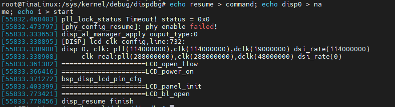

开机过程中在uboot初始化lcd后,kernel是不是走lcd初始化流程的,进入内核后,休眠唤醒一下lcd,看看pin脚状态有没有变化
mount -t debugfs none /sys/kernel/debug
cd /sys/kernel/debug/dispdbg
//休眠
echo suspend > command; echo disp0 > name; echo 1 > start
//唤醒
echo resume > command; echo disp0 > name; echo 1 > start
使用以上指令,lcd部分管脚配置成功了。lcd_gpio_0、lcd_gpio_1、lcd_gpio_2、lcd_gpio_3,这四个gpio没有初始化正常。
以下是执行唤醒lcd的log
lcd的显示情况如下:
### 最终结果
1. 将uboot-board.dts的lcd注释掉,colorbar不在闪屏。
2. lcd_gpio_0、lcd_gpio_1、lcd_gpio_2、lcd_gpio_3,依旧没能初始化。原因未知。

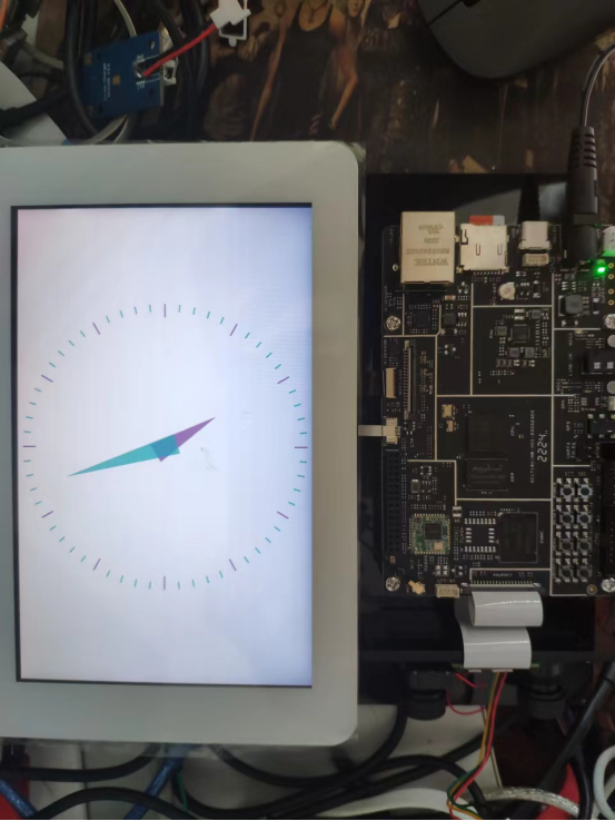

目前显示效果如下:
以下是完整的patch, 在tina v2.0验证成功。
 	gmac_pins_b: gmac@1 {
 		pins = "PE0", "PE1", "PE2", "PE3",
-		       "PE4", "PE5", "PE6", "PE7",
-		       "PE8", "PE9", "PE10", "PE11",
-		       "PE12", "PE13", "PE14", "PE15";
+				"PE4", "PE5", "PE6", "PE7",
+				"PE8", "PE9";
 	dmic_pins_a: dmic@0 {
 		/* DMIC_PIN: CLK, DATA0, DATA1, DATA2 */
-		pins = "PE17", "PB11", "PB10", "PD17";
+		pins = "PE17", "PB11";
 		function = "dmic";
 		drive-strength = <20>;

+	rgb18_20_pins_a: rgb18_20@0 {
+		pins = "PD0", "PD1", "PD2", "PD3", "PD4", "PD5", \
+				"PD6", "PD7", "PD8", "PD9", "PD10", "PD11", \
+				"PD12", "PD13", "PD14", "PD15", "PD16", "PD17", \
+				"PD18", "PD19", "PD20", "PD21";
+		function = "lcd0";
+		drive-strength = <20>;
+		bias-disable;
+	rgb18_20_pins_b: rgb18_20@1 {
+		function = "io_disabled";
+		bias-disable;
+	rgb18_10_pins_a: rgb18_10@0 {
+		drive-strength = <10>;
+		bias-disable;
+	rgb18_10_pins_b: rgb18_10@1 {
+		bias-disable;

 &lcd0 {
-	lcd_used            = <1>;
+	lcd_used             = <1>;
+	lcd_if               = <0>;
+	lcd_hv_if            = <0>;
-	lcd_if              = <4>;
-	lcd_x               = <800>;
-	lcd_y               = <1280>;
-	lcd_width           = <52>;
-	lcd_pwm_ch          = <2>;
-	lcd_hbp             = <32>;
-	lcd_ht              = <868>;
-	lcd_hspw            = <4>;
-	lcd_vbp             = <12>;
-	lcd_vt              = <1311>;
-	lcd_vspw            = <4>;
-	lcd_dsi_if          = <0>;
-	lcd_frm             = <0>;
-	lcd_bright_curve_en = <0>;
-	deu_mode            = <0>;
+	lcd_width            = <70>;
+	lcd_x                = <480>;
+	lcd_y                = <480>;
+	lcd_hbp              = <60>;
+	lcd_ht               = <612>;
+	lcd_hspw             = <12>;
+	lcd_vbp              = <18>;
+	lcd_vt               = <520>;
+	lcd_vspw             = <4>;
+	lcd_pwm_ch           = <7>;
+	lcd_gpio_0           = <&pio PG 13 1 1 1 1>;
+	lcd_gpio_1           = <&pio PE 14 1 1 1 1>;
+	lcd_gpio_2           = <&pio PE 12 1 1 1 1>;
+	lcd_gpio_3           = <&pio PE 15 1 1 1 1>;

+&lcd0 {
+	lcd_used            = <1>;
+	lcd_backlight       = <100>;
+	lcd_if              = <2>;
+	lcd_x               = <480>;
+	lcd_y               = <480>;
+	lcd_width           = <70>;
+	lcd_dclk_freq       = <30>;
+	lcd_pwm_ch          = <7>;
+	lcd_pwm_freq        = <19000>;
+	lcd_pwm_pol         = <0>;
+	lcd_pwm_max_limit   = <255>;
+	lcd_hbp             = <60>;
+	lcd_ht              = <612>;
+	lcd_hspw            = <12>;
+	lcd_vbp             = <18>;
+	lcd_vt              = <520>;
+	lcd_vspw            = <4>;
+	lcd_dsi_if          = <0>;
+	lcd_dsi_lane        = <4>;
+	lcd_lvds_if         = <0>;
+	lcd_lvds_colordepth = <0>;
+	lcd_lvds_mode       = <0>;
+	lcd_frm             = <0>;
+	lcd_hv_clk_phase    = <0>;
+	lcd_bright_curve_en = <0>;
+	lcd_fsync_en        = <0>;
+	lcd_fsync_act_time  = <1000>;
+	lcd_fsync_dis_time  = <1000>;
+	lcd_fsync_pol       = <0>;
+	deu_mode            = <0>;
+	lcdgamma4iep        = <22>;
+	smart_color         = <90>;
+	lcd_gpio_0 = <&pio PG 13 GPIO_ACTIVE_HIGH>;RST
+	lcd_gpio_1 = <&pio PE 14 GPIO_ACTIVE_HIGH>;CS
+	lcd_gpio_2 = <&pio PE 12 GPIO_ACTIVE_HIGH>;SDA
+	lcd_gpio_3 = <&pio PE 15 GPIO_ACTIVE_HIGH>;SCK
+#include "st7701s_rgb.h"
+#include "default_panel.h"
+//s32 sunxi_lcd_gpio_set_value(u32 screen_id, u32 io_index, u32 value)
+#define st7701s_spi_scl_1   sunxi_lcd_gpio_set_value(0, 3, 1)
+#define st7701s_spi_scl_0   sunxi_lcd_gpio_set_value(0, 3, 0)
+#define st7701s_spi_sdi_1   sunxi_lcd_gpio_set_value(0, 2, 1)
+#define st7701s_spi_sdi_0   sunxi_lcd_gpio_set_value(0, 2, 0)
+#define st7701s_spi_cs_1    sunxi_lcd_gpio_set_value(0, 1, 1)
+#define st7701s_spi_cs_0    sunxi_lcd_gpio_set_value(0, 1, 0)
+#define st7701s_spi_reset_1 sunxi_lcd_gpio_set_value(0, 0, 1)
+#define st7701s_spi_reset_0 sunxi_lcd_gpio_set_value(0, 0, 0)

+static s32 LCD_open_flow(u32 sel)
+    printk("=====================LCD_open_flow\n");
+	/* open lcd power, and delay 50ms */
+	LCD_OPEN_FUNC(sel, LCD_power_on, 20);
+	/* open lcd power, than delay 200ms */
+	LCD_OPEN_FUNC(sel, LCD_panel_init, 20);
+	/* open lcd controller, and delay 100ms */
+	LCD_OPEN_FUNC(sel, sunxi_lcd_tcon_enable, 100);
+	/* open lcd backlight, and delay 0ms */
+	LCD_OPEN_FUNC(sel, LCD_bl_open, 0);
+	return 0;
+static s32 LCD_close_flow(u32 sel)
+	/* close lcd backlight, and delay 0ms */
+	LCD_CLOSE_FUNC(sel, LCD_bl_close, 0);
+	/* close lcd controller, and delay 0ms */
+	LCD_CLOSE_FUNC(sel, sunxi_lcd_tcon_disable, 0);
+	LCD_CLOSE_FUNC(sel, LCD_panel_exit, 200);
+	/* close lcd power, and delay 500ms */
+	LCD_CLOSE_FUNC(sel, LCD_power_off, 500);
+	return 0;

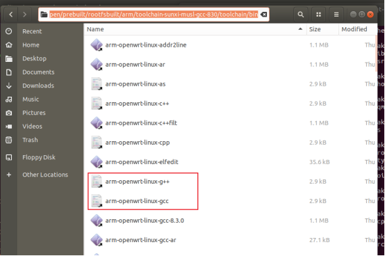

记录一下自己交叉编译QT的过程,目前来说再体验了初次编译镜像之后,编译这个QT还是算比较快捷的,因为该有的库都安装完成了。
首先就是我需要找到我们的交叉编译器安装位置,这个在下载了Tina之后还是很好找的。

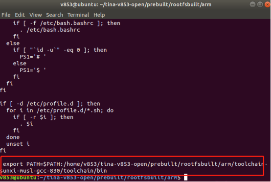

tina-v853-open/prebuilt/rootfsbuilt/arm/toolchain-sunxi-musl-gcc-830/toolchain/bin
如上路径。
我们用的一般就是这个,我们可以把其路径加到我们系统的环境中,这样在编译QT的时候就比较简单了。
一般我是直接加到/etc/profile下的,这样重启后就有了。

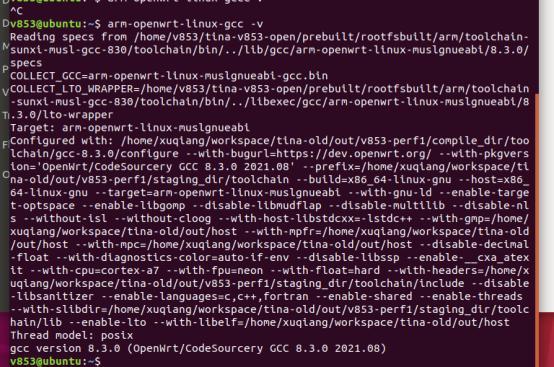

敲一下arm-openwrt-linux-gcc -v这样就能出现如上提示就OK了。

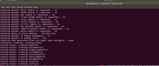

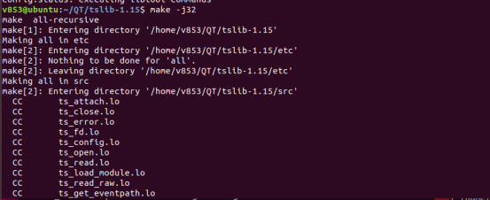

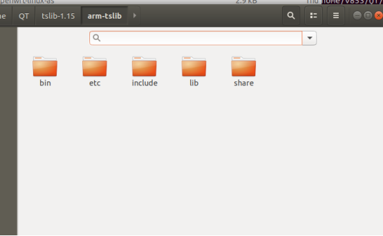

接下来我们准备下编译QT前先编译tslib这个在底层使用触摸屏的时候比较方便。
这里我选择的1.15版本的,这个都可以,本身Tina再构建的时候好像就带了tslib。
export STAGING_DIR=/home/v853/tina-v853-open/prebuilt/rootfsbuilt/arm/toolchain-sunxi-musl-gcc-830/toolchain/arm-openwrt-linux-muslgnueabi
这段要再配置前执行,这段是为了找交叉编译器的库文件,头文件的。
./configure --host=arm-openwrt-linux ac_cv_func_malloc_0_nonnull=yes--cache-file=arm-linux.cache -prefix=/home/v853/QT/tslib-1.15/arm-tslib
进行配置生成makefile文件。
然后直接make,make结束之后就是make install,这样就会在我们配置的文件夹中生成我们的arm-tslib。

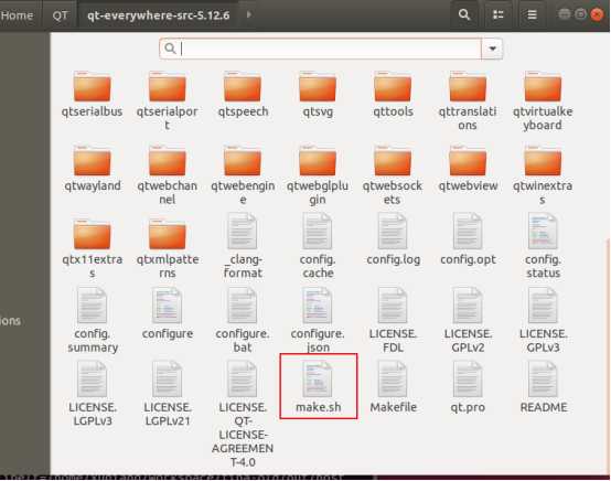

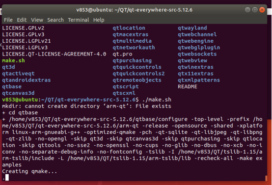

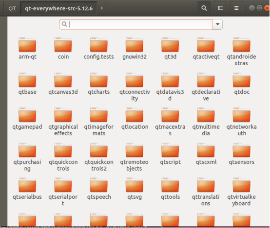

然后我们选择一个QT5版本,这里我选择了QT5.12.6。然后新建一个装交叉编译完成的文件夹我命名为arm-qt。之后我们一般选择构建一个脚本。
这里我建了一个叫make.sh的。这样在这里面我们完成所以QT的配置工作,具体如下:
#!/bin/sh
PWD=`pwd`
    mkdir arm-qt
    ./configure \
    -prefix $PWD/arm-qt \
    -release \
    -opensource \
    -shared \
    -xplatform linux-arm-gnueabi-g++ \
    -optimized-qmake \
    -pch \
    -qt-sqlite \
    -qt-libjpeg \
    -qt-libpng \
    -qt-zlib \
    -no-opengl \
    -skip qt3d \
    -skip qtcanvas3d \
    -skip qtpurchasing \
    -skip qtlocation \
    -skip qttools \
    -no-sse2 \
    -no-openssl \
    -no-cups \
    -no-glib \
    -no-dbus \
    -no-xcb \
    -no-iconv \
    -no-separate-debug-info \
    -no-fontconfig \
    -tslib \
    -I /home/v853/QT/tslib-1.15/arm-tslib/include \
    -L /home/v853/QT/tslib-1.15/arm-tslib/lib \
    -recheck-all \
    -make examples
    make -j16
    make install
结尾就是直接构建然后安装。

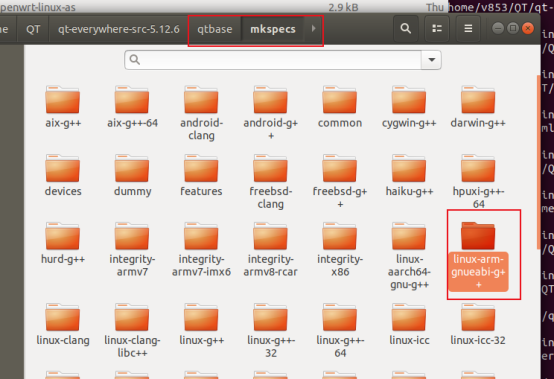

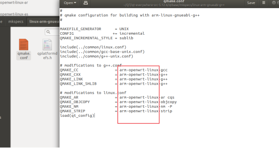

中间我们注意这个配置,这个配置是要对应上我们交叉编译器的。
0a3fc40d-7416-43b3-b134-b31eb15ad0e1-image.pngfd911a34-13dc-445f-b191-6a474439a649-image.png

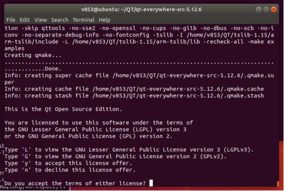

把上面文件里面内容全部替换成我们的交叉编译器的名字。然后执行脚本即可。

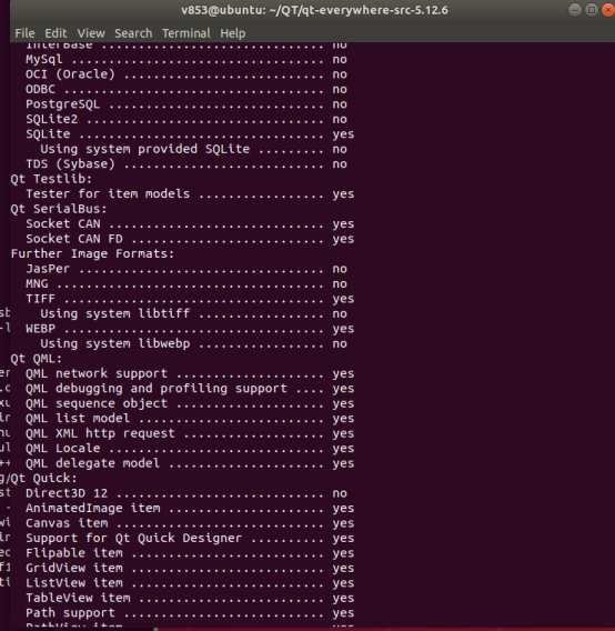

9dbf6215-1ea2-4623-b2a6-d61c67f7af67-image.png1d2175ae-a616-4d38-a4b4-8238cb370587-image.png

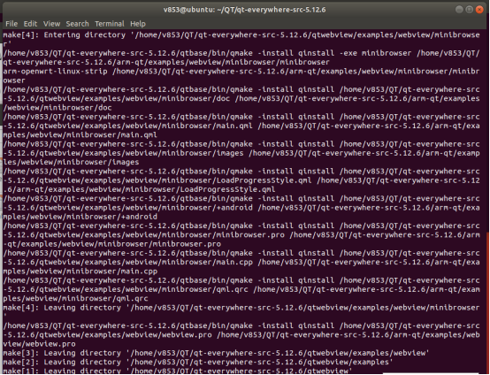

确定一下我们的是否同意其license。输入yes即可,中间无报错直接就会构建完安装完。
这是我们配置的一些组件,可以自己选择性的安装。也就是修改脚本即可。

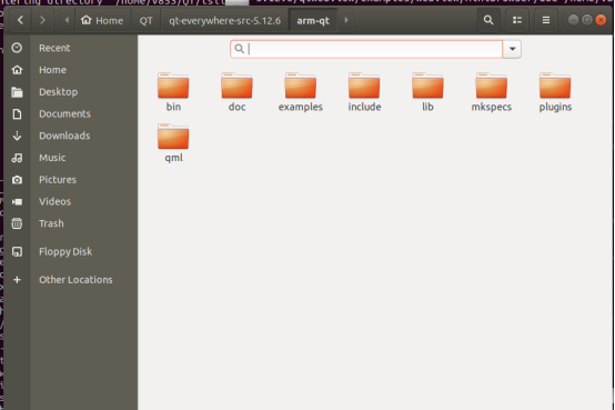

这里就是编译完成了,中间大概等了半小时,看个人虚拟机配置情况。
在路径下生成了很多文件,我们放到arm开发板上也就是lib,和plugins这里面还没有字体文件,可以自己添加。

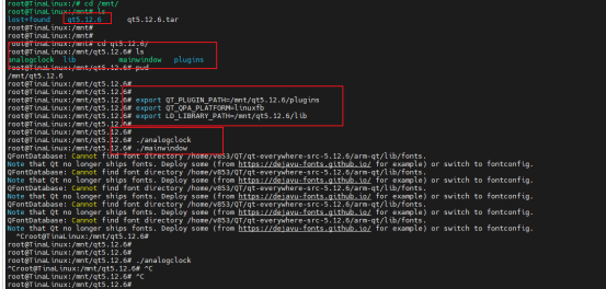

export QT_PLUGIN_PATH=/mnt/qt5.12.6/plugins
export QT_QPA_PLATFORM=linuxfb
export LD_LIBRARY_PATH=/mnt/qt5.12.6/lib

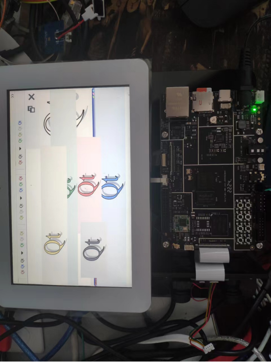

然后初始化一下我们的库路径,这样就能运行QT了,效果如下:
dbd794f4-c66f-4eea-9a95-922cbcb454e7-image.pngeafd34f3-13c1-4792-9a2c-2c1e94cb61ba-image.png
