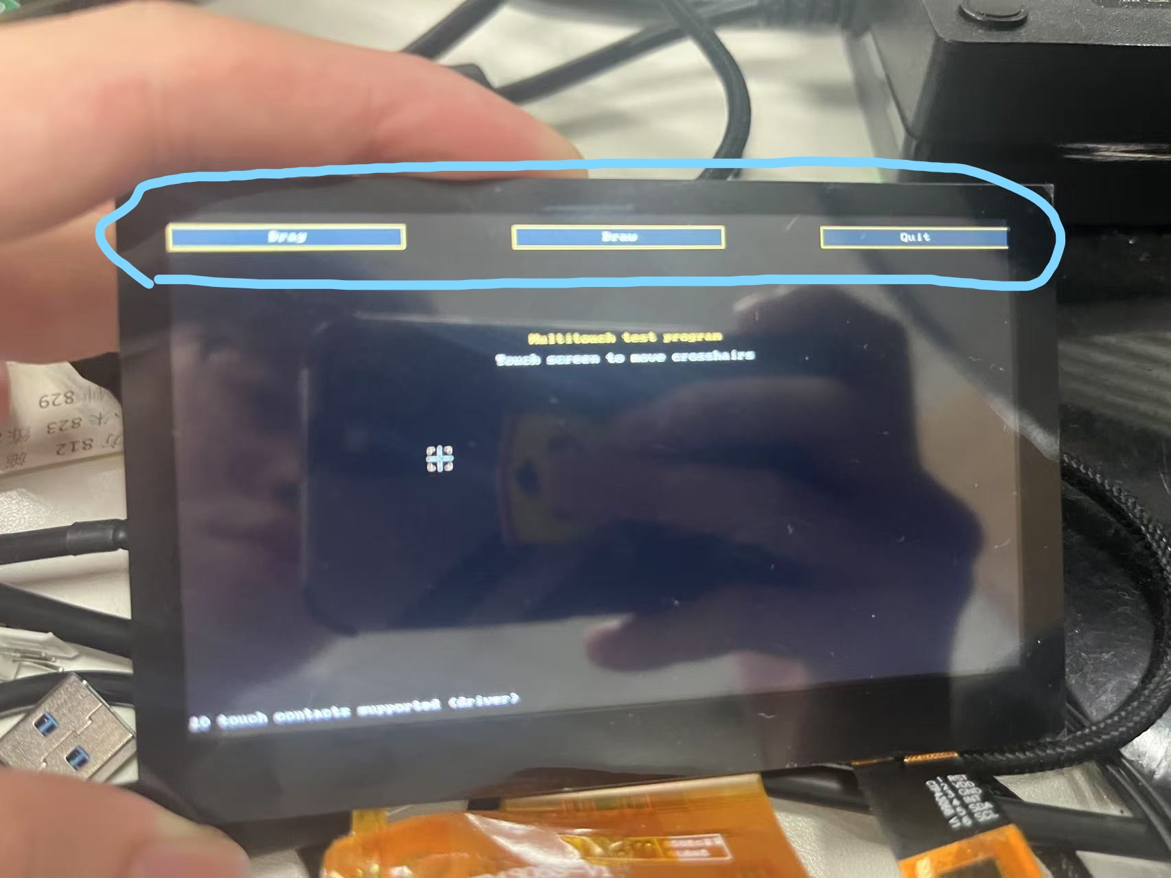

#1 Re: 全志 SOC » F1C200s 800*480 4.3寸电容触摸屏 屏幕顶部无法触摸 » 2025-06-05 09:55:41
最后如同楼上的老哥说的一样,重新写一下GT911的寄存器就行了,参考这个https://wiki.sipeed.com/soft/Lichee/zh/Nano-Doc-Backup/driver/touchscreen.html
#2 Re: 全志 SOC » F1C200s 800*480 4.3寸电容触摸屏 屏幕顶部无法触摸 » 2025-06-03 22:58:56
nlive 说:
linux写入错误导致的,CFG data错误,需要重新写入 gt11 0x8047-0x8100 186个寄存器。
参考裸机烧录例子:
https://gitee.com/dmcus/F1C200S/tree/master/sources/examples/gt911_4.3_800x480
修改  gt911_4.3.h #define GT9XX_SEND_CFG 1 。
看了下,裸机烧录超级麻烦呀,佬有没有Linux方面的 解决办法
#3 Re: 全志 SOC » F1C200s 800*480 4.3寸电容触摸屏 屏幕顶部无法触摸 » 2025-06-03 15:56:03
补充一下I2C 扫描出来的结果
# i2cdetect -y -r 0
     0  1  2  3  4  5  6  7  8  9  a  b  c  d  e  f

#4 全志 SOC » F1C200s 800*480 4.3寸电容触摸屏 屏幕顶部无法触摸 » 2025-06-03 15:47:44
89399074
回复: 5
板子:LCPI F1C200S Nand Flash
屏幕: 4.3 寸 电容触摸屏 分辨率 800*480
触摸: GT911
使用的SDK是https://github.com/aodzip/buildroot-tiny200的开发板
启动log:

[    1.346143] Goodix-TS 0-0014: ID 911, version: 1060
[    1.352141] sun4i-csi 1cb0000.csi: Packed (RAW) format enabled.
[    1.359057] Goodix-TS 0-0014: Direct firmware load for goodix_911_cfg.bin failed with error -2

佬们,请帮我看看,为啥我的屏幕顶部有一部分区域是无法触摸的,点击屏幕 没有反应,点击其它区域倒是有反应
 4.3寸触摸屏
设备树文件
pinctrl-names = "default";
    pinctrl-0 = <&i2c0_pd_pins>;
    ctp@5d {
        compatible = "goodix,gt911";
        reg = <0x14>;//0x5d也试过了,但是也没有用
        interrupt-parent = <&pio>;
        interrupts = <4 12 IRQ_TYPE_EDGE_FALLING>; // PE12
        irq-gpios = <&pio 4 12 GPIO_ACTIVE_HIGH>; // PE12
        reset-gpios = <&pio 0 0 GPIO_ACTIVE_HIGH>; // PA0
        touchscreen-size-x = <800>;
        touchscreen-size-y = <480>;
        touchscreen-inverted-x;
        touchscreen-inverted-y;
        goodix,cfg-data = [82 00 04 58 02 05 3D 20 22 08 28 08 5F 41 03 05 00 00 00 00 00 00 00 17 1A 1E 14 8C 2E 0E 99 9B B2 04 00 00 00 22 01 1D 00 01 00 00 00 00 00 00 00 00 00 82 B4 9E D5 F4 07 00 00 04 89 86 00 84 8F 00 7F 99 00 7B A3 00 77 AE 00 77 00 00 00 00 00 00 00 00 00 00 00 00 00 00 00 00 00 00 00 00 00 00 00 00 00 00 00 00 00 00 00 00 00 00 00 00 00 00 00 00 00 00 00 00 00 00 02 04 06 08 0A 0C 0E 10 12 14 16 18 1A 1C 00 00 00 00 00 00 00 00 00 00 00 00 00 00 00 00 00 02 04 06 08 0A 0C 0F 10 12 13 14 16 18 1C 1D 1E 1F 20 21 22 24 26 28 29 2A 00 00 00 00 00 00 00 00 00 00 00 00 00 00 00 00 AA 01];//这里是商家给的cfg文件提取出来的,填上去依然没有用
