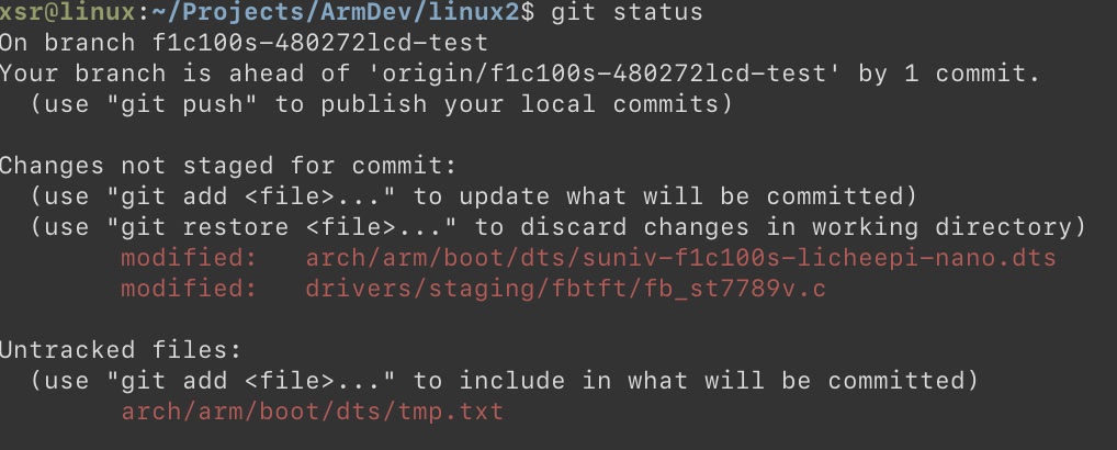

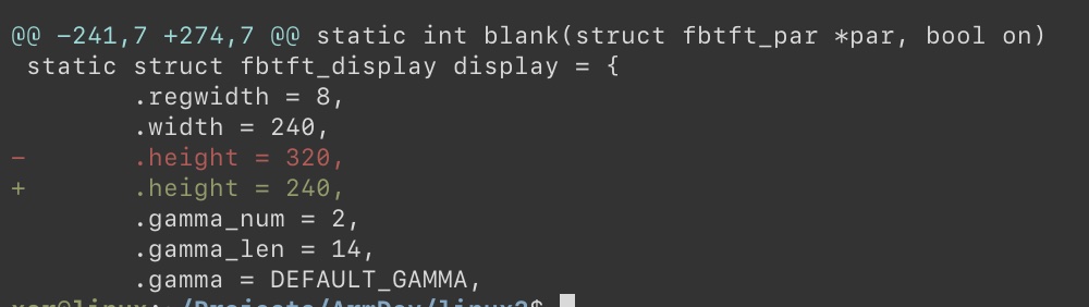

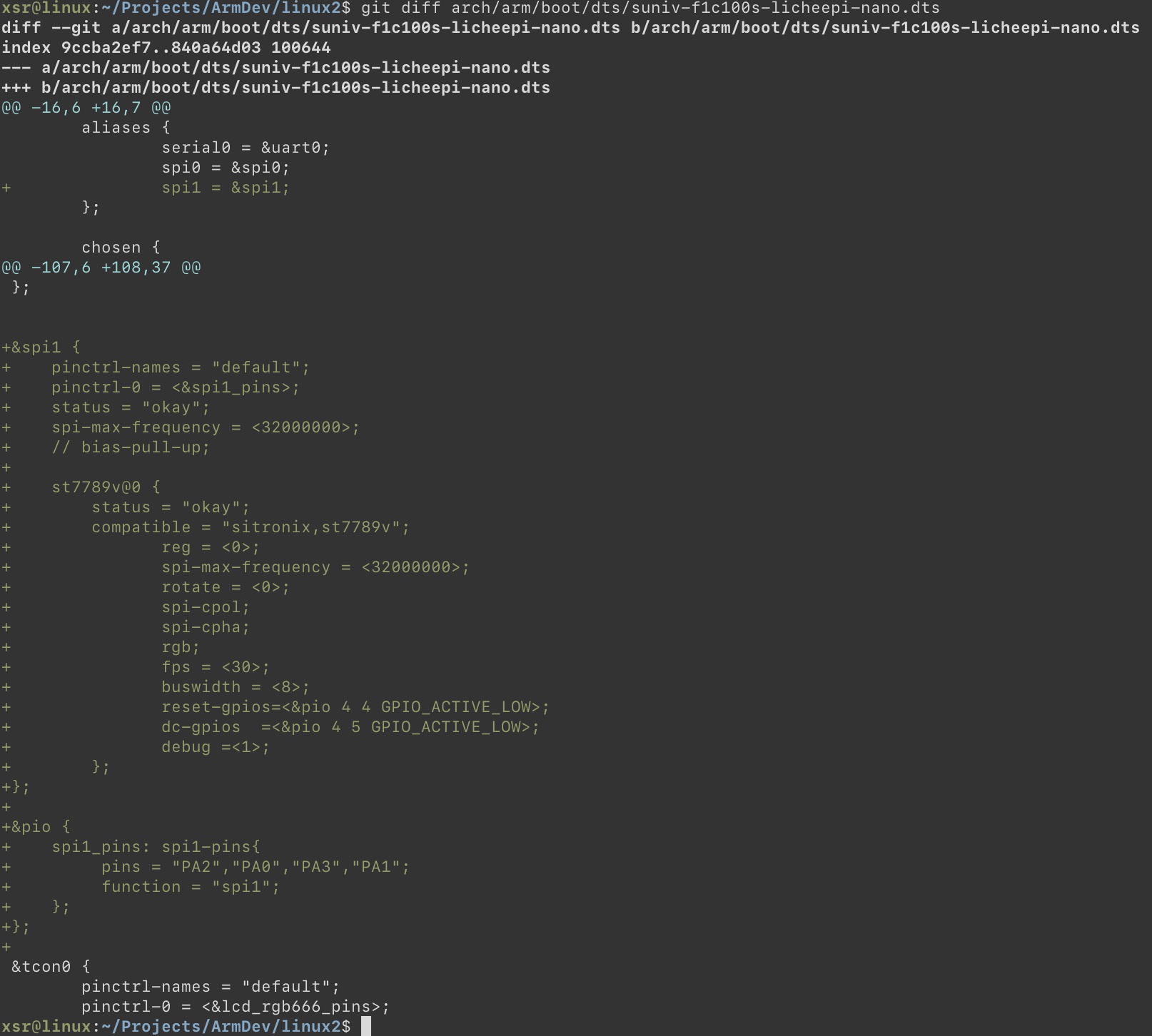

#5 全志 SOC » 请教一下f1c100s 外接st7789 但是驱动不生效的问题 » 2022-04-23 15:54:29
xsran
回复: 4
大家好,我在尝试给f1c100s外接一个st7789的屏幕,修改了设备树和驱动文件,但是感觉驱动并没有跑起来,请求大家帮忙看看。
linux源码修改了2个文件:
分别修改如下:
dmesg:

查看设备树:
完整设备树:
/dts-v1/;
#include "suniv-f1c100s.dtsi"
        model = "Lichee Pi Nano";
        compatible = "licheepi,licheepi-nano", "allwinner,suniv-f1c100s",
                     "allwinner,suniv";
        aliases {
                serial0 = &uart0;
                spi0 = &spi0;
                spi1 = &spi1;
        chosen {
        panel: panel {
                compatible = "lg,lb070wv8", "simple-panel";
                #address-cells = <1>;
                #size-cells = <0>;
                enable-gpios = <&pio 4 6 GPIO_ACTIVE_HIGH>;
                port@0 {
                        reg = <0>;
                        #size-cells = <0>;
                        panel_input: endpoint@0 {
                                reg = <0>;
        reg_vcc3v3: vcc3v3 {
                regulator-name = "vcc3v3";
&de {
&mmc0 {
        vmmc-supply = <&reg_vcc3v3>;
        bus-width = <4>;
        broken-cd;
&otg_sram {
&spi0 {
        pinctrl-names = "default";
        pinctrl-0 = <&spi0_pins_a>;
        flash: w25q128@0 {
        #size-cells = <1>;
        compatible = "winbond,xt25f128b", "jedec,spi-nor";
        reg = <0>;
        partitions {
            #size-cells = <1>;
            partition@0 {
                label = "u-boot";
                reg = <0x000000 0x100000>;
                read-only;
            partition@100000 {
                label = "dtb";
                reg = <0x100000 0x10000>;
                read-only;
            partition@110000 {
                label = "kernel";
                reg = <0x110000 0x400000>;
                read-only;
            partition@510000 {
                label = "rootfs";
                reg = <0x510000 0xAF0000>;
&spi1 {
    pinctrl-0 = <&spi1_pins>;
    spi-max-frequency = <32000000>;
    // bias-pull-up;
    st7789v@0 {
               reg = <0>;
               rotate = <0>;
               spi-cpol;
               spi-cpha;
               rgb;
               fps = <30>;
               buswidth = <8>;
               reset-gpios=<&pio 4 4 GPIO_ACTIVE_LOW>;
               dc-gpios  =<&pio 4 5 GPIO_ACTIVE_LOW>;
               debug =<1>;
&pio {
    spi1_pins: spi1-pins{
         pins = "PA2","PA0","PA3","PA1";
         function = "spi1";
&tcon0 {
        pinctrl-0 = <&lcd_rgb666_pins>;
&tcon0_out {
        tcon0_out_lcd: endpoint@0 {
                reg = <0>;
&uart0 {
        pinctrl-0 = <&uart0_pins_a>;
&usb_otg {
        dr_mode = "otg";
&usbphy {
        usb0_id_det-gpio = <&pio 4 2 GPIO_ACTIVE_HIGH>; /* PE2 */
请大家帮我看看这个问题,谢谢。
以及,我有几个疑问:
1.我看别的帖子里面日志是有很多详细信息的,我该如何打开更加详细的日志呢
2.我的驱动本身已经有荔枝派nano的RGB接口的屏幕的frame buffer驱动,这个驱动和st7789的驱动能否共存?
3.有没有可能是硬件接线的问题,硬件接线不对,会不会也会导致这里出问题,谢谢
