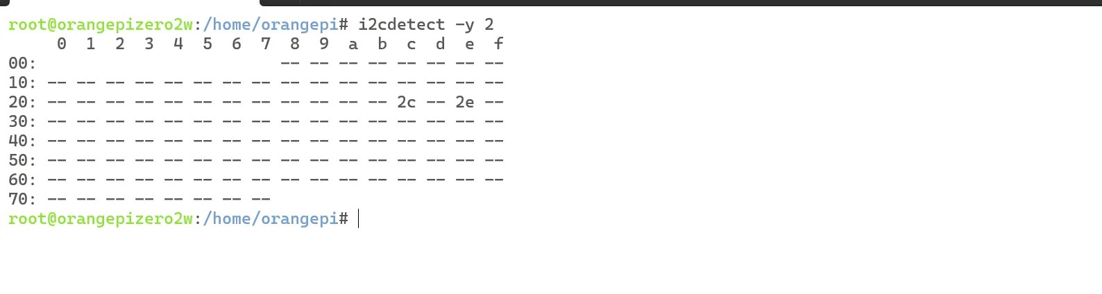

#3 Re: 全志 SOC » H616 orangepi zero 2w touch_driver 移植过程设备树设置问题请教 » 2024-03-11 16:58:34
硬件连接后使用 i2cdetect 来进行确认硬件连接是正常的

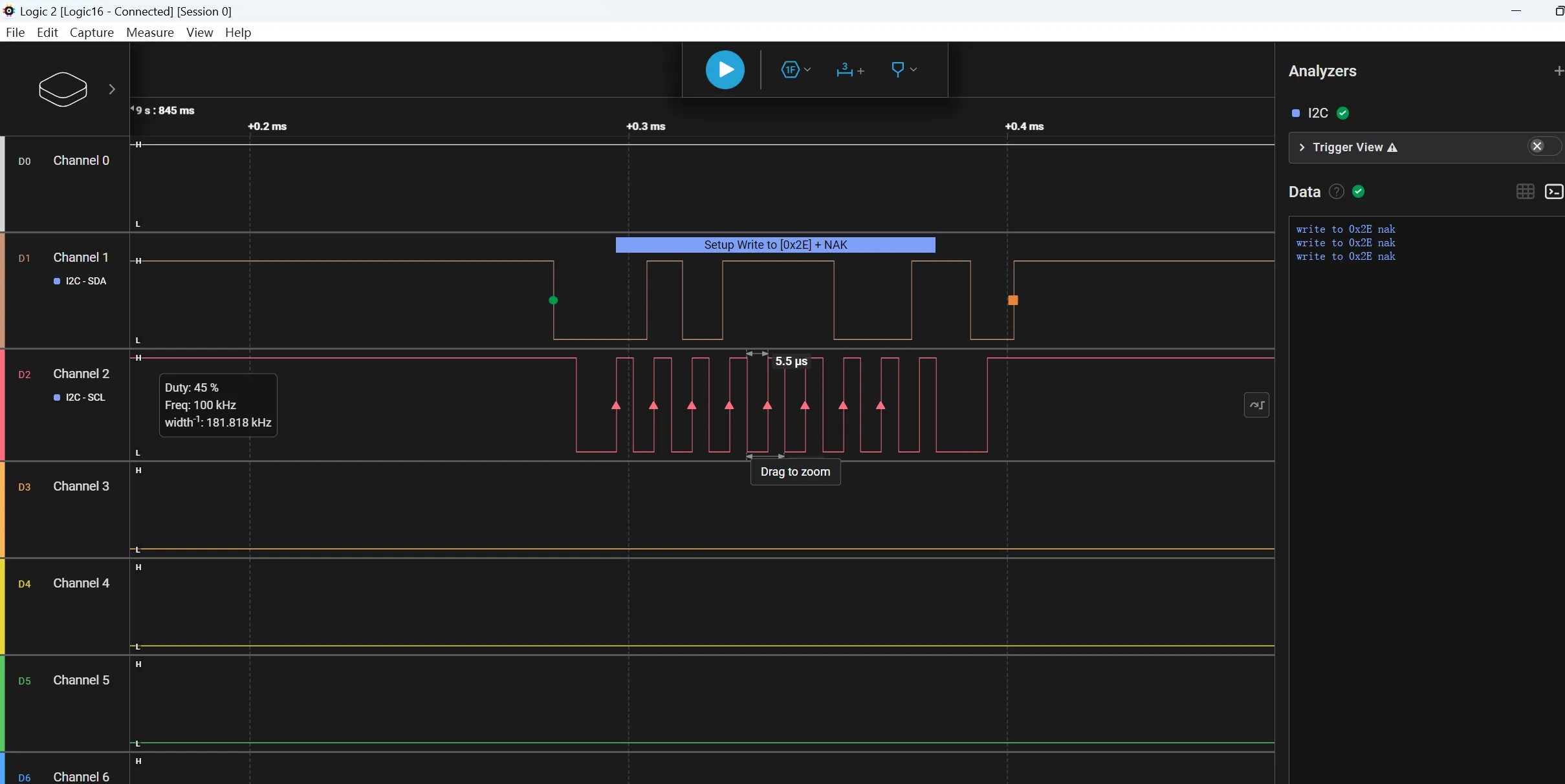

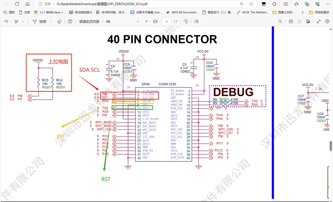

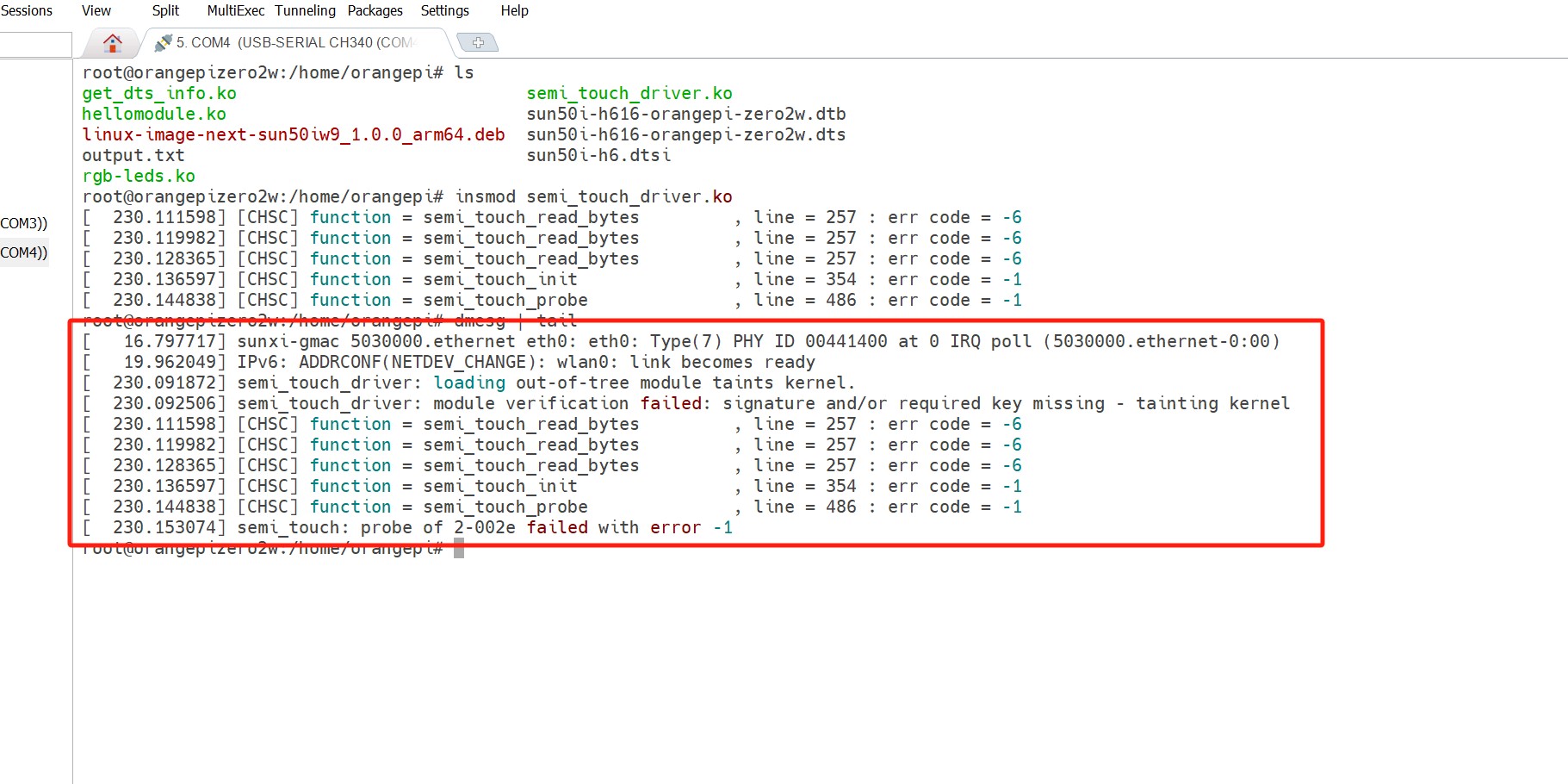

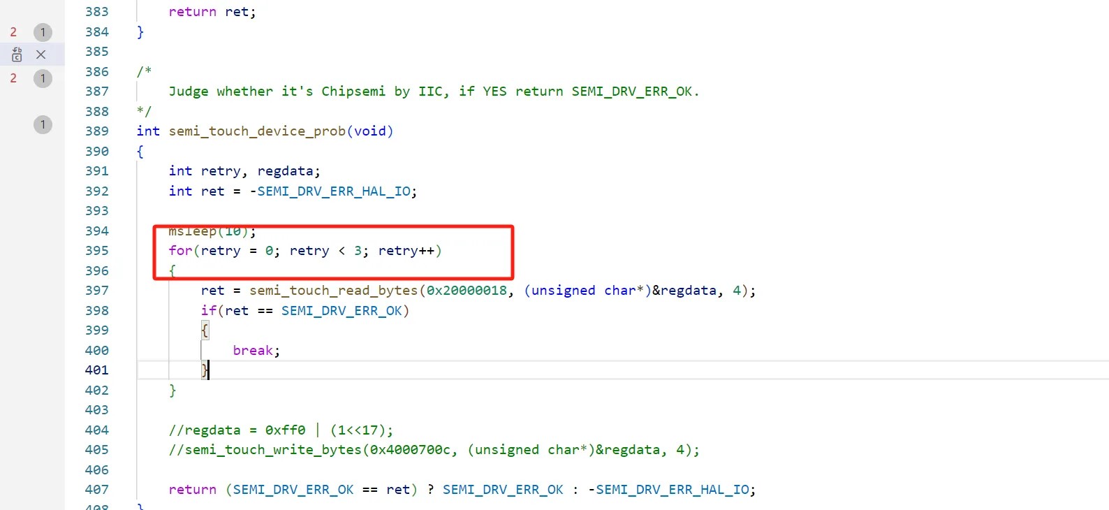

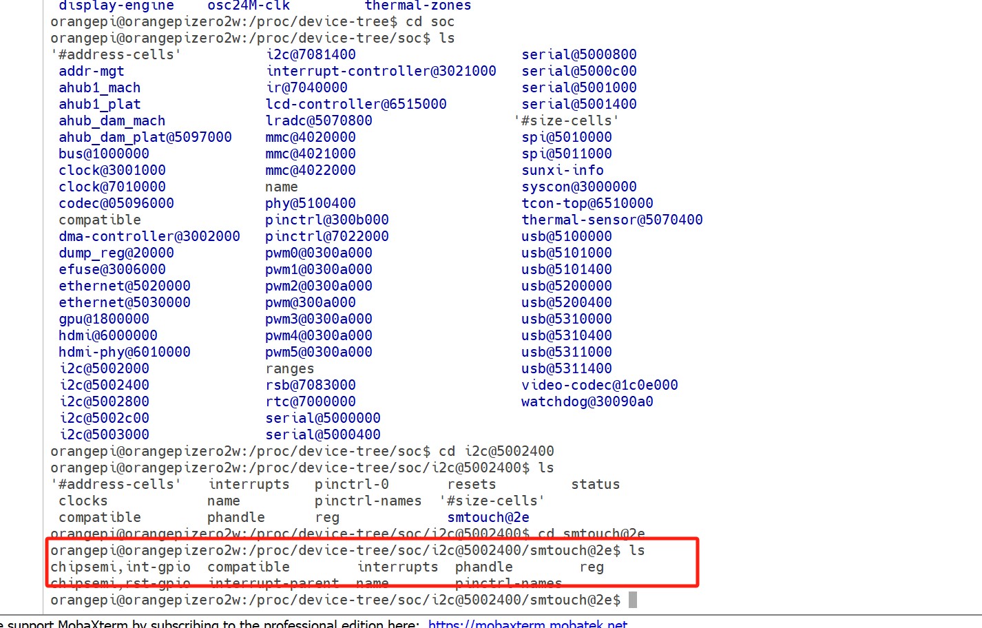

#5 全志 SOC » H616 orangepi zero 2w touch_driver 移植过程设备树设置问题请教 » 2024-03-09 22:59:49
Goku
回复: 5
生成orangepi zero 2w 移植 touch_driver 移植过程问题:主要是对全志设备树的修改不熟悉
    求指导全志的h616移植驱动设备树设置
[*]linux 6.1内核版本链接[/*]
https://github.com/orangepi-xunlong/linux-orangepi/tree/orange-pi-6.1-sun50iw9
  • 硬件引脚选取
    根据原理图选择引脚
    SDA : PI8
    SCL : PI7
    INT : PI13
    RST : TX5 -> B15->PH2
  • 设备树修改点:sun50i-h616.dtsi

  • 驱动加载报错log,目前没有进行实际硬件链接
  • 驱动加载后i2c设备树信息

    [  230.091872] semi_touch_driver: loading out-of-tree module taints kernel.
    [  230.092506] semi_touch_driver: module verification failed: signature and/or required key missing - tainting kernel
    [  230.111598] [CHSC] function = semi_touch_read_bytes         , line = 257 : err code = -6
    [  230.119982] [CHSC] function = semi_touch_read_bytes         , line = 257 : err code = -6
    [  230.128365] [CHSC] function = semi_touch_read_bytes         , line = 257 : err code = -6
    [  230.136597] [CHSC] function = semi_touch_init               , line = 354 : err code = -1
    [  230.144838] [CHSC] function = semi_touch_probe              , line = 486 : err code = -1
    [  230.153074] semi_touch: probe of 2-002e failed with error -1
  • 查看驱动原文件
    https://whycan.com/files/members/9467/chct_touch.zip
