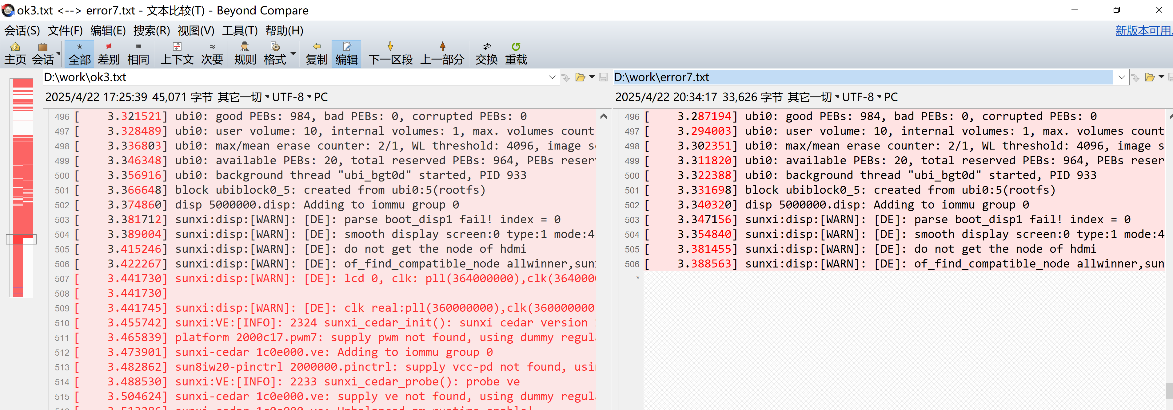

[    2.763967] Loading compiled-in X.509 certificates
[    2.789854] sunxi-twi 2502800.twi: 2502800.twi supply twi not found, using dummy regulator
[    2.800643] sunxi:i2c_sunxi@2502800.twi[INFO]: v2.6.5 probe success
[    2.809517] sunxi-thermal 2009400.ths: sun8iw20 chip id: 13312
[    2.816062] sunxi-thermal 2009400.ths: sun8iw20 t1: 3000
[    2.822188] sunxi-thermal 2009400.ths: sun8iw20 cp version:15
[    2.868512] ubi0: attaching mtd3
[    3.221604] ubi0: scanning is finished
[    3.225851] ubi0 error: ubi_read_volume_table: the layout volume was not found
[    3.234179] ubi0 error: ubi_attach_mtd_dev: failed to attach mtd3, error -22
[    3.242140] UBI error: cannot attach mtd3
[    3.246635] UBI: block: can't open volume on ubi0_-1, err=-19
[    3.253648] otg manager soc@3000000:usbc0@0: soc@3000000:usbc0@0 supply usbc not found, using dummy regulator
[    3.265866] get ctp_power is fail, -22
[    3.270116] get ctp_power_ldo_vol is fail, -22
[    3.275108] sunxi_ctp_startup: ctp_power_io is invalid.
[    3.281028] get ctp_gesture_wakeup fail, no gesture wakeup
[    3.287219] gt9xxnew_ts 2-0014: 2-0014 supply ctp not found, using dummy regulator
[    3.447136] sunxi:i2c_sunxi@2502800.twi[ERR]: drv-mode: Address + Write bit transmitted,ACK not received
[    3.457768] sunxi:i2c_sunxi@2502800.twi[ERR]: drv mode: TWI BUS error state is 0x20
[    3.466371] sunxi:i2c_sunxi@2502800.twi[ERR]: drv-mode: xfer failed (dev addr:0x14)
[    3.475030] sunxi:i2c_sunxi@2502800.twi[ERR]: drv-mode: Address + Write bit transmitted,ACK not received
[    3.485659] sunxi:i2c_sunxi@2502800.twi[ERR]: drv mode: TWI BUS error state is 0x20
[    3.494258] sunxi:i2c_sunxi@2502800.twi[ERR]: drv-mode: xfer failed (dev addr:0x14)
[    3.502911] sunxi:i2c_sunxi@2502800.twi[ERR]: drv-mode: Address + Write bit transmitted,ACK not received
[    3.513540] sunxi:i2c_sunxi@2502800.twi[ERR]: drv mode: TWI BUS error state is 0x20
[    3.522138] sunxi:i2c_sunxi@2502800.twi[ERR]: drv-mode: xfer failed (dev addr:0x14)
[    3.530800] sunxi:i2c_sunxi@2502800.twi[ERR]: drv-mode: Address + Write bit transmitted,ACK not received
[    3.541429] sunxi:i2c_sunxi@2502800.twi[ERR]: drv mode: TWI BUS error state is 0x20
[    3.550027] sunxi:i2c_sunxi@2502800.twi[ERR]: drv-mode: xfer failed (dev addr:0x14)
[    3.558681] sunxi:i2c_sunxi@2502800.twi[ERR]: drv-mode: Address + Write bit transmitted,ACK not received
[    3.569309] sunxi:i2c_sunxi@2502800.twi[ERR]: drv mode: TWI BUS error state is 0x20
[    3.577906] sunxi:i2c_sunxi@2502800.twi[ERR]: drv-mode: xfer failed (dev addr:0x14)
[    3.586503] <<-GTP-ERROR->> I2C Read: 0x8047, 1 bytes failed, errcode: -22! Process reset.
[    3.747071] <<-GTP-ERROR->> GTP i2c test failed time 1.
[    3.777116] sunxi:i2c_sunxi@2502800.twi[ERR]: drv-mode: Address + Write bit transmitted,ACK not received
[    3.787745] sunxi:i2c_sunxi@2502800.twi[ERR]: drv mode: TWI BUS error state is 0x20
[    3.796342] sunxi:i2c_sunxi@2502800.twi[ERR]: drv-mode: xfer failed (dev addr:0x14)
[    3.804996] sunxi:i2c_sunxi@2502800.twi[ERR]: drv-mode: Address + Write bit transmitted,ACK not received
[    3.815621] sunxi:i2c_sunxi@2502800.twi[ERR]: drv mode: TWI BUS error state is 0x20
[    3.824219] sunxi:i2c_sunxi@2502800.twi[ERR]: drv-mode: xfer failed (dev addr:0x14)
[    3.832875] sunxi:i2c_sunxi@2502800.twi[ERR]: drv-mode: Address + Write bit transmitted,ACK not received
[    3.843504] sunxi:i2c_sunxi@2502800.twi[ERR]: drv mode: TWI BUS error state is 0x20
[    3.852102] sunxi:i2c_sunxi@2502800.twi[ERR]: drv-mode: xfer failed (dev addr:0x14)
[    3.860753] sunxi:i2c_sunxi@2502800.twi[ERR]: drv-mode: Address + Write bit transmitted,ACK not received
[    3.871381] sunxi:i2c_sunxi@2502800.twi[ERR]: drv mode: TWI BUS error state is 0x20
[    3.879977] sunxi:i2c_sunxi@2502800.twi[ERR]: drv-mode: xfer failed (dev addr:0x14)
[    3.888637] sunxi:i2c_sunxi@2502800.twi[ERR]: drv-mode: Address + Write bit transmitted,ACK not received
[    3.899266] sunxi:i2c_sunxi@2502800.twi[ERR]: drv mode: TWI BUS error state is 0x20
[    3.907862] sunxi:i2c_sunxi@2502800.twi[ERR]: drv-mode: xfer failed (dev addr:0x14)
[    3.916456] <<-GTP-ERROR->> I2C Read: 0x8047, 1 bytes failed, errcode: -22! Process reset.
[    4.077069] <<-GTP-ERROR->> GTP i2c test failed time 2.
[    4.107136] sunxi:i2c_sunxi@2502800.twi[ERR]: drv-mode: Address + Write bit transmitted,ACK not received
[    4.117762] sunxi:i2c_sunxi@2502800.twi[ERR]: drv mode: TWI BUS error state is 0x20
[    4.126362] sunxi:i2c_sunxi@2502800.twi[ERR]: drv-mode: xfer failed (dev addr:0x14)
[    4.135016] sunxi:i2c_sunxi@2502800.twi[ERR]: drv-mode: Address + Write bit transmitted,ACK not received
[    4.145645] sunxi:i2c_sunxi@2502800.twi[ERR]: drv mode: TWI BUS error state is 0x20
[    4.154243] sunxi:i2c_sunxi@2502800.twi[ERR]: drv-mode: xfer failed (dev addr:0x14)
[    4.162895] sunxi:i2c_sunxi@2502800.twi[ERR]: drv-mode: Address + Write bit transmitted,ACK not received
[    4.173523] sunxi:i2c_sunxi@2502800.twi[ERR]: drv mode: TWI BUS error state is 0x20
[    4.182119] sunxi:i2c_sunxi@2502800.twi[ERR]: drv-mode: xfer failed (dev addr:0x14)
[    4.190777] sunxi:i2c_sunxi@2502800.twi[ERR]: drv-mode: Address + Write bit transmitted,ACK not received
[    4.201406] sunxi:i2c_sunxi@2502800.twi[ERR]: drv mode: TWI BUS error state is 0x20
[    4.210002] sunxi:i2c_sunxi@2502800.twi[ERR]: drv-mode: xfer failed (dev addr:0x14)
[    4.218654] sunxi:i2c_sunxi@2502800.twi[ERR]: drv-mode: Address + Write bit transmitted,ACK not received
[    4.229283] sunxi:i2c_sunxi@2502800.twi[ERR]: drv mode: TWI BUS error state is 0x20
[    4.237878] sunxi:i2c_sunxi@2502800.twi[ERR]: drv-mode: xfer failed (dev addr:0x14)
[    4.246476] <<-GTP-ERROR->> I2C Read: 0x8047, 1 bytes failed, errcode: -22! Process reset.
[    4.407070] <<-GTP-ERROR->> GTP i2c test failed time 3.
[    4.437115] sunxi:i2c_sunxi@2502800.twi[ERR]: drv-mode: Address + Write bit transmitted,ACK not received
[    4.447744] sunxi:i2c_sunxi@2502800.twi[ERR]: drv mode: TWI BUS error state is 0x20
[    4.456343] sunxi:i2c_sunxi@2502800.twi[ERR]: drv-mode: xfer failed (dev addr:0x14)
[    4.464994] sunxi:i2c_sunxi@2502800.twi[ERR]: drv-mode: Address + Write bit transmitted,ACK not received
[    4.475623] sunxi:i2c_sunxi@2502800.twi[ERR]: drv mode: TWI BUS error state is 0x20
[    4.484221] sunxi:i2c_sunxi@2502800.twi[ERR]: drv-mode: xfer failed (dev addr:0x14)
[    4.492874] sunxi:i2c_sunxi@2502800.twi[ERR]: drv-mode: Address + Write bit transmitted,ACK not received
[    4.503503] sunxi:i2c_sunxi@2502800.twi[ERR]: drv mode: TWI BUS error state is 0x20
[    4.512100] sunxi:i2c_sunxi@2502800.twi[ERR]: drv-mode: xfer failed (dev addr:0x14)
[    4.520752] sunxi:i2c_sunxi@2502800.twi[ERR]: drv-mode: Address + Write bit transmitted,ACK not received
[    4.531380] sunxi:i2c_sunxi@2502800.twi[ERR]: drv mode: TWI BUS error state is 0x20
[    4.539976] sunxi:i2c_sunxi@2502800.twi[ERR]: drv-mode: xfer failed (dev addr:0x14)
[    4.548632] sunxi:i2c_sunxi@2502800.twi[ERR]: drv-mode: Address + Write bit transmitted,ACK not received
[    4.559260] sunxi:i2c_sunxi@2502800.twi[ERR]: drv mode: TWI BUS error state is 0x20
[    4.567856] sunxi:i2c_sunxi@2502800.twi[ERR]: drv-mode: xfer failed (dev addr:0x14)
[    4.576451] <<-GTP-ERROR->> I2C Read: 0x8047, 1 bytes failed, errcode: -22! Process reset.
[    4.737069] <<-GTP-ERROR->> GTP i2c test failed time 4.
[    4.767115] sunxi:i2c_sunxi@2502800.twi[ERR]: drv-mode: Address + Write bit transmitted,ACK not received
[    4.777744] sunxi:i2c_sunxi@2502800.twi[ERR]: drv mode: TWI BUS error state is 0x20
[    4.786342] sunxi:i2c_sunxi@2502800.twi[ERR]: drv-mode: xfer failed (dev addr:0x14)
[    4.795000] sunxi:i2c_sunxi@2502800.twi[ERR]: drv-mode: Address + Write bit transmitted,ACK not received
[    4.805629] sunxi:i2c_sunxi@2502800.twi[ERR]: drv mode: TWI BUS error state is 0x20
[    4.814225] sunxi:i2c_sunxi@2502800.twi[ERR]: drv-mode: xfer failed (dev addr:0x14)
[    4.822878] sunxi:i2c_sunxi@2502800.twi[ERR]: drv-mode: Address + Write bit transmitted,ACK not received
[    4.833507] sunxi:i2c_sunxi@2502800.twi[ERR]: drv mode: TWI BUS error state is 0x20
[    4.842105] sunxi:i2c_sunxi@2502800.twi[ERR]: drv-mode: xfer failed (dev addr:0x14)
[    4.850761] sunxi:i2c_sunxi@2502800.twi[ERR]: drv-mode: Address + Write bit transmitted,ACK not received
[    4.861390] sunxi:i2c_sunxi@2502800.twi[ERR]: drv mode: TWI BUS error state is 0x20
[    4.869986] sunxi:i2c_sunxi@2502800.twi[ERR]: drv-mode: xfer failed (dev addr:0x14)
[    4.878642] sunxi:i2c_sunxi@2502800.twi[ERR]: drv-mode: Address + Write bit transmitted,ACK not received
[    4.889270] sunxi:i2c_sunxi@2502800.twi[ERR]: drv mode: TWI BUS error state is 0x20
[    4.897868] sunxi:i2c_sunxi@2502800.twi[ERR]: drv-mode: xfer failed (dev addr:0x14)
[    4.906466] <<-GTP-ERROR->> I2C Read: 0x8047, 1 bytes failed, errcode: -22! Process reset.
[    5.067084] <<-GTP-ERROR->> GTP i2c test failed time 5.
[    5.097068] I2C communication ERROR!
[    5.097097] regulator-dummy: Underflow of regulator enable count
[    5.097323] gt9xxnew_ts: probe of 2-0014 failed with error -1
[    5.117192] sunxi-vin-core 5809000.vinc: Adding to iommu group 0
[    5.124293] sunxi-vin-core 5809200.vinc: Adding to iommu group 0
[    5.132021] sun8iw20-pinctrl pio: pin PE13 already requested by 4500000.gmac0; cannot claim for pio:141
[    5.142650] sun8iw20-pinctrl pio: pin-141 (pio:141) status -22
[    5.149532] [VIN_WARN]get csi isp clk fail
[    5.154128] [VIN_WARN]get csi isp src clk fail
[    5.159152] [VIN_WARN]get csi mipi clk fail
[    5.159158] [VIN_WARN]get csi mipi src clk fail
[    5.159188] [VIN_WARN]get csi isp mbus clk fail
[    5.174024] [VIN_WARN]Get isp reset control fail
[    5.179419] [VIN_ERR]n5 request i2c1 adapter failed!
[    5.187542] cfg80211: Loading compiled-in X.509 certificates for regulatory database
[    5.198748] cfg80211: Loaded X.509 cert 'sforshee: 00b28ddf47aef9cea7'
[    5.206095] clk: Not disabling unused clocks
[    5.211026] platform regulatory.0: Direct firmware load for regulatory.db failed with error -2
[    5.217091] ALSA device list:
[    5.220734] cfg80211: failed to load regulatory.db
[    5.224019]   No soundcards found.
[    5.233331] alloc_fd: slot 0 not NULL!
[    5.237965] /dev/root: Can't open blockdev
[    5.242576] VFS: Cannot open root device "ubiblock0_5" or unknown-block(0,0): error -6
[    5.251480] Please append a correct "root=" boot option; here are the available partitions:
[    5.260938] 1f00            1024 mtdblock0
[    5.260941]  (driver?)
[    5.268310] 1f01            3072 mtdblock1
[    5.268313]  (driver?)
[    5.275655] 1f02            1024 mtdblock2
[    5.275657]  (driver?)
[    5.283033] 1f03          125952 mtdblock3
[    5.283036]  (driver?)
[    5.290395] Kernel panic - not syncing: VFS: Unable to mount root fs on unknown-block(0,0)
[    5.299661] CPU: 0 PID: 1 Comm: swapper/0 Not tainted 5.4.61 #1
[    5.306293] Hardware name: Generic DT based system
[    5.311682] [<c010e390>] (unwind_backtrace) from [<c010a934>] (show_stack+0x10/0x14)
[    5.320368] [<c010a934>] (show_stack) from [<c07a0498>] (dump_stack+0x7c/0x98)
[    5.328469] [<c07a0498>] (dump_stack) from [<c0119e08>] (panic+0x100/0x3d4)
[    5.336280] [<c0119e08>] (panic) from [<c0b01288>] (mount_block_root+0x260/0x304)
[    5.344670] [<c0b01288>] (mount_block_root) from [<c0b014c8>] (prepare_namespace+0x118/0x178)
[    5.354229] [<c0b014c8>] (prepare_namespace) from [<c07b4cb8>] (kernel_init+0x8/0x118)
[    5.363110] [<c07b4cb8>] (kernel_init) from [<c01010e8>] (ret_from_fork+0x14/0x2c)
[    5.371592] Exception stack(0xef079fb0 to 0xef079ff8)
[    5.377253] 9fa0:                                     00000000 00000000 00000000 00000000
[    5.386419] 9fc0: 00000000 00000000 00000000 00000000 00000000 00000000 00000000 00000000
[    5.395584] 9fe0: 00000000 00000000 00000000 00000000 00000013 00000000
[    5.403004] CPU1: stopping
[    5.406037] CPU: 1 PID: 0 Comm: swapper/1 Not tainted 5.4.61 #1
[    5.412667] Hardware name: Generic DT based system
[    5.418040] [<c010e390>] (unwind_backtrace) from [<c010a934>] (show_stack+0x10/0x14)
[    5.426722] [<c010a934>] (show_stack) from [<c07a0498>] (dump_stack+0x7c/0x98)
[    5.434820] [<c07a0498>] (dump_stack) from [<c010c730>] (handle_IPI+0xc0/0x168)
[    5.443018] [<c010c730>] (handle_IPI) from [<c03a9d60>] (gic_handle_irq+0x70/0x78)
[    5.451505] [<c03a9d60>] (gic_handle_irq) from [<c01021cc>] (__irq_svc+0x6c/0xa8)
[    5.459889] Exception stack(0xef09bf80 to 0xef09bfc8)
[    5.465553] bf80: 000084b4 ef7c7574 00000000 c0115320 00000002 ef09a000 c0c03e24 c0c03e60
[    5.474720] bfa0: 4000406a 410fc075 00000000 00000000 c0c828b0 ef09bfd0 c0108040 c0108044
[    5.483887] bfc0: 60000113 ffffffff
[    5.487799] [<c01021cc>] (__irq_svc) from [<c0108044>] (arch_cpu_idle+0x2c/0x38)
[    5.496092] [<c0108044>] (arch_cpu_idle) from [<c013eb70>] (do_idle+0xb8/0x120)
[    5.504287] [<c013eb70>] (do_idle) from [<c013ee6c>] (cpu_startup_entry+0x18/0x1c)
[    5.512773] [<c013ee6c>] (cpu_startup_entry) from [<40102c0c>] (0x40102c0c)
[    5.520578] invalid reason or reasonbase NULL
[    5.525469] rtc set bootreason panic reboot fail
[    5.530660] ---[ end Kernel panic - not syncing: VFS: Unable to mount root fs on unknown-block(0,0) ]---
楼主 #26 2025-08-15 11:15:24
memory
注册时间: 2021-08-11
已发帖子: 656
积分: 628
Re: 全志 T113 SDK V1.2 学习记录
搞定,从uboot把W25N02KVZEIR支持的代码偷过来搞定!
楼主 #27 2025-08-15 15:17:17
memory
注册时间: 2021-08-11
已发帖子: 656
积分: 628
感觉这块 W25N02KVZEIR 彻底坏了,烧录出错:
[1552]fes begin commit:2386bdb825
