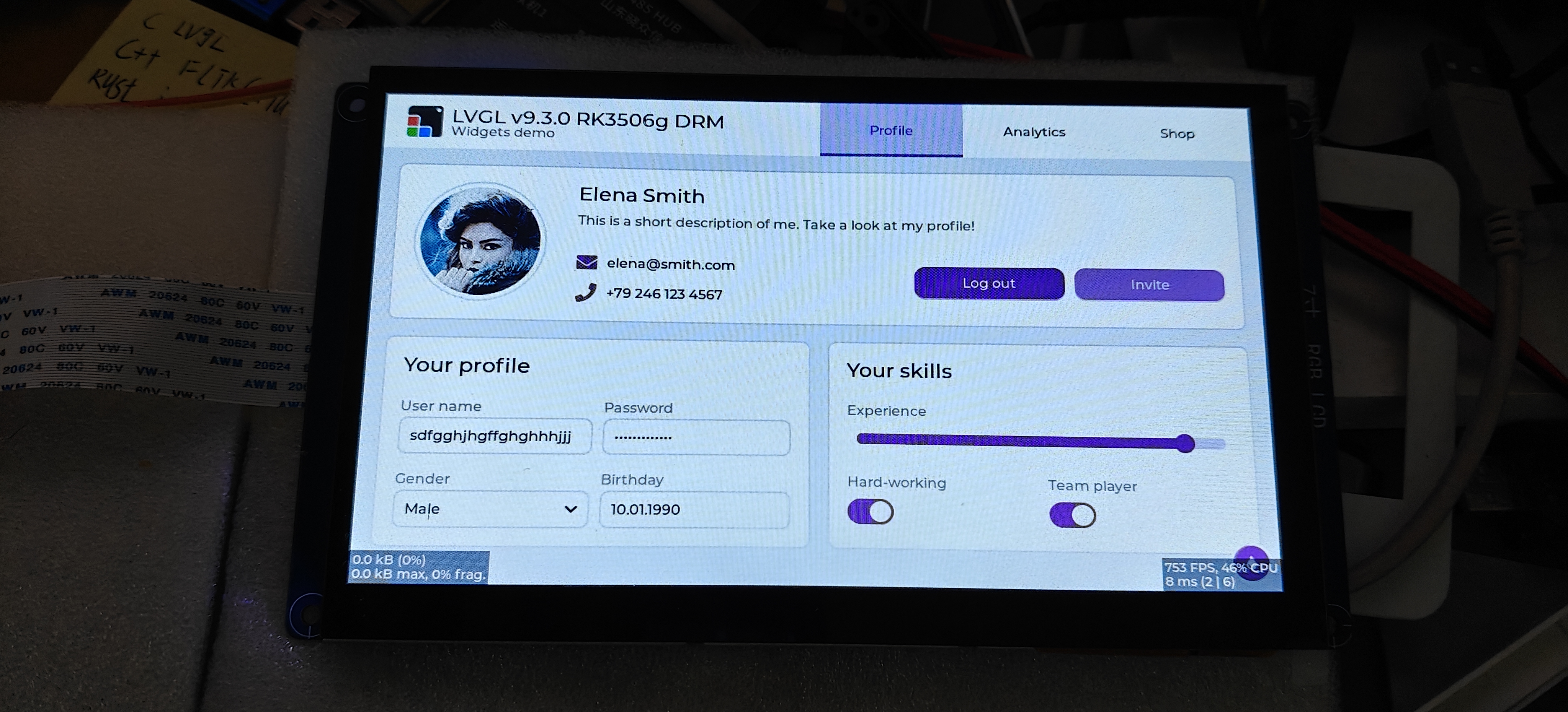

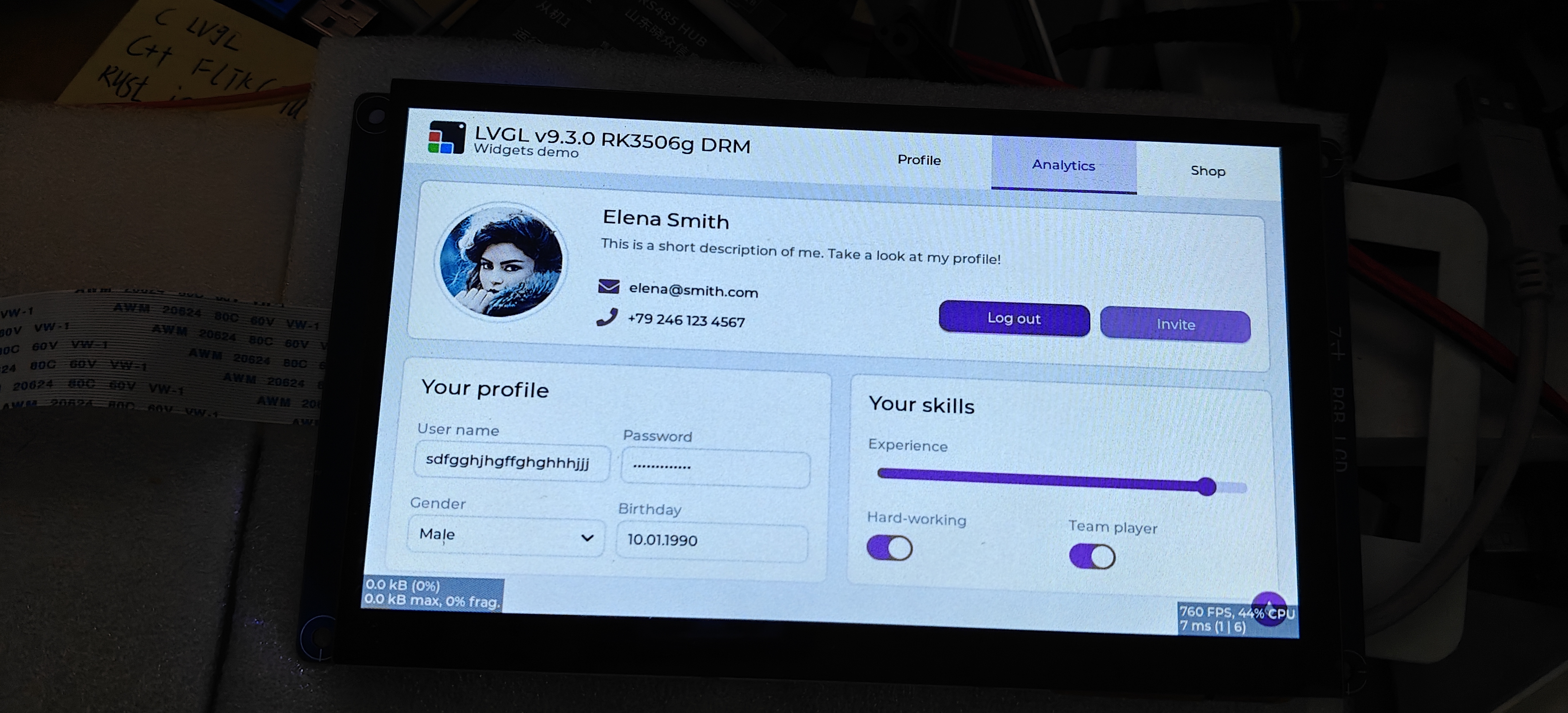

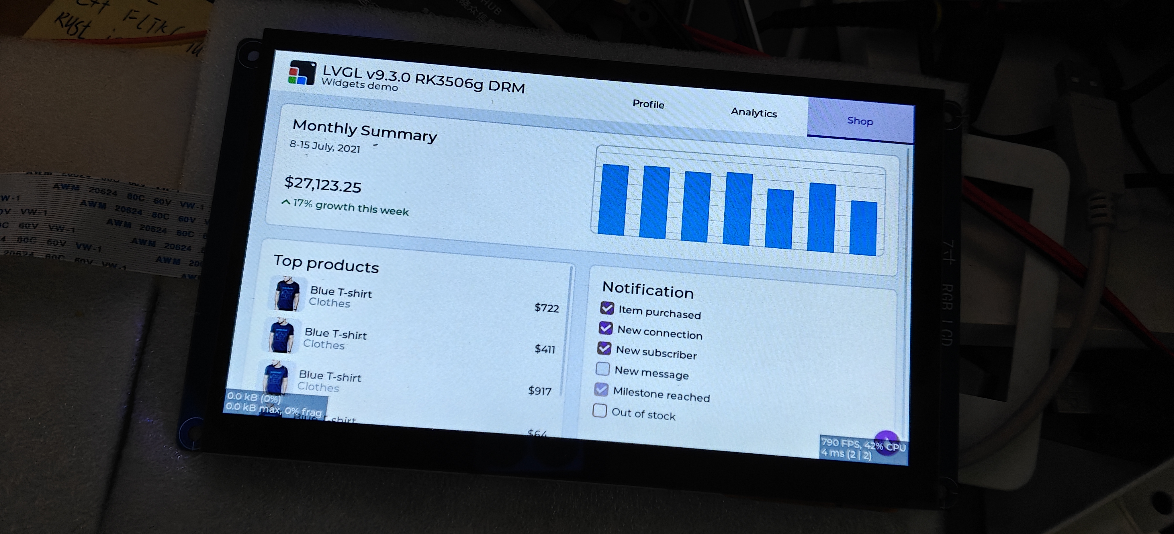

rk3506G从入门到放弃
事情从某多买了一个rk3506开始,参考链接https://whycan.com/t_12088.html
修改设备树驱动屏幕参考上面链接修改就行了,关于上面的报错信息,不需要修改Build options–>Mirrors and Download locations改一下路由器的DNS或者重启一下就好了

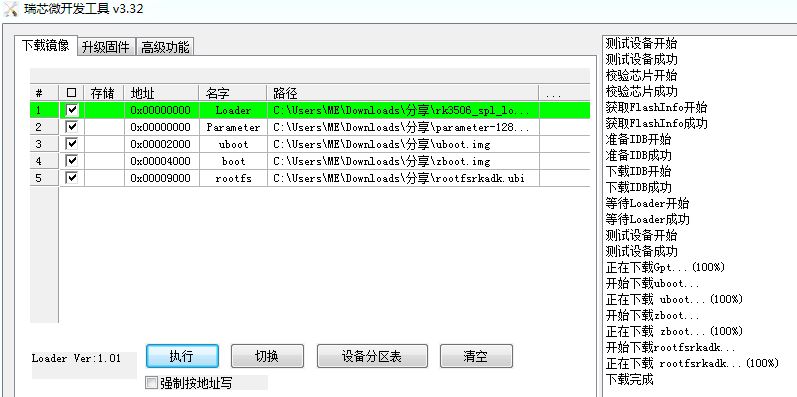

然后你想传输一下文件或者放个qt.你会发现打包失败,就是超过了尺寸
这时候需要修改分区表删除一些分区,修改设备树的启动参数
分区表rk3506_linux6.1_sdk/device/rockchip/.chips/rk3506/parameter-128M.txt
FIRMWARE_VER:8.1
MACHINE_MODEL:RK3506
MACHINE_ID:007
MANUFACTURER: RK3506
MAGIC: 0x5041524B
ATAG: 0x00200800
MACHINE: 3506
CHECK_MASK: 0x80
PWR_HLD: 0,0,A,0,1
TYPE: GPT
GROW_ALIGN: 0
CMDLINE:mtdparts=:0x00002000@0x00002000(uboot),0x00005000@0x00004000(boot),-@0x00009000(rootfs:grow)
uuid:rootfs=614e0000-0000-4b53-8000-1d28000054a9
只保留了必须的分区

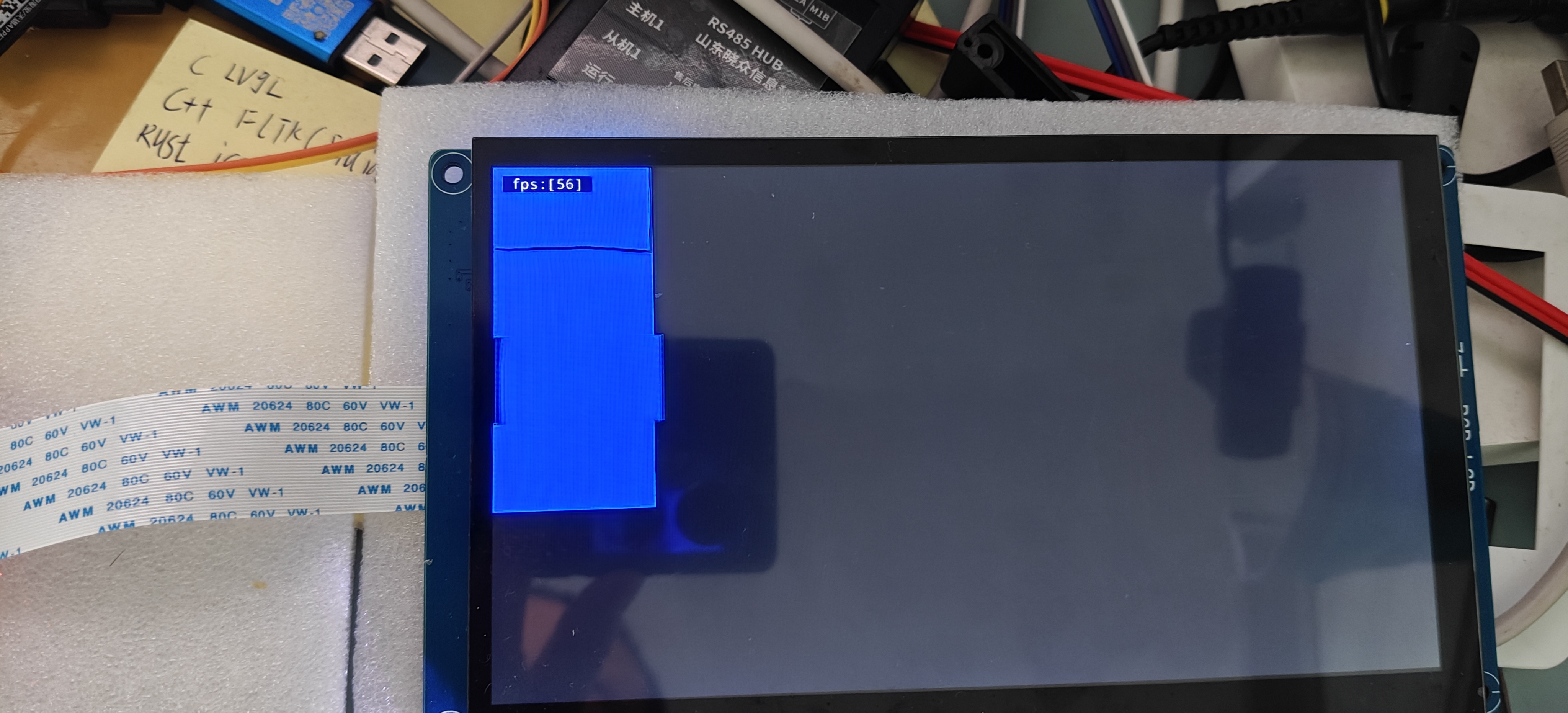

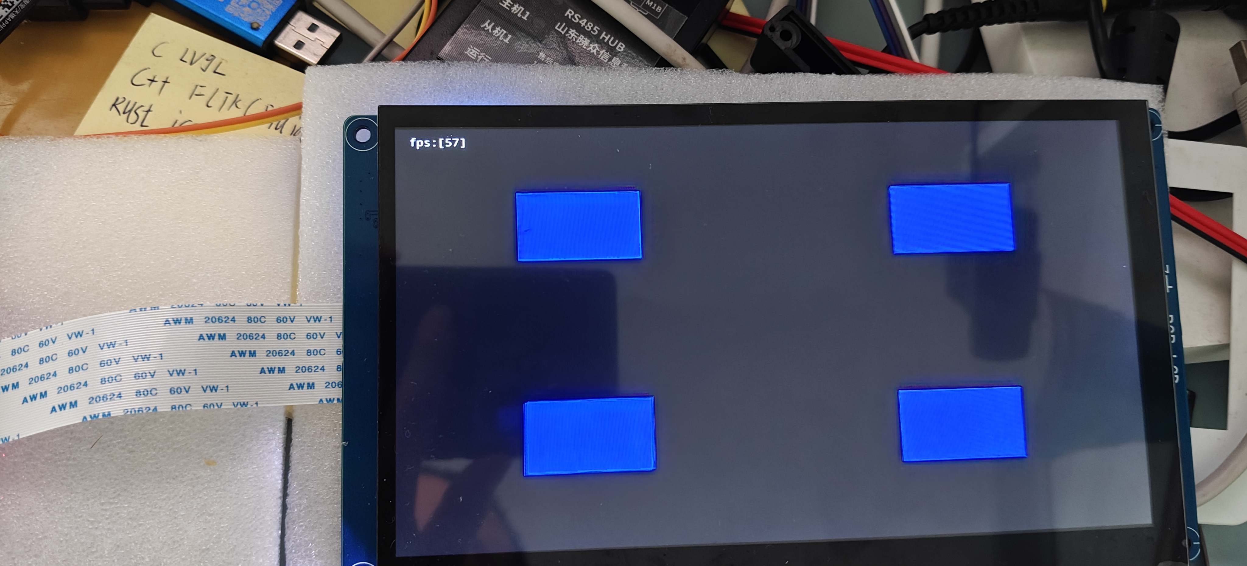

那啥顺手修改一下屏幕
修改rk3506g-mini-v10-rgb.dtsi,display-timings {
            native-mode = <&rgb_timing>;
            rgb_timing: timing0 {
                clock-frequency = <51200000>;
                hactive = <1024>;
                vactive = <600>;
                hback-porch = <160>;
                hfront-porch = <160>;
                vback-porch = <23>;
                vfront-porch = <12>;
                hsync-len = <20>;
                vsync-len = <10>;
                hsync-active = <0>;
                vsync-active = <0>;
                de-active = <0>;
                pixelclk-active = <0>;
修改触摸

这时候编译完烧录会挂载文件系统失败,这时候需要修改buildroot里面文件系统的配置
/rk3506_linux6.1_sdk/buildroot/configs/rockchip_rk3506_defconfig
#include "base/base.config"
#include "chips/rk3506_arm.config"
#include "fs/vfat.config"
#include "wifibt/bt.config"
#include "wifibt/wireless.config"
#include "bus/can.config"
#include "lvgl/lvgl_rkadk.config"
#include "lvgl/rk_demo.config"
BR2_LV_CALENDAR_WEEK_STARTS_MONDAY=y
BR2_LV_DEMO_MUSIC_AUTO_PLAY=y
BR2_LV_DEMO_MUSIC_LANDSCAPE=y
BR2_LV_DEMO_MUSIC_LARGE=y
BR2_LV_DEMO_MUSIC_ROUND=y
BR2_LV_DEMO_MUSIC_SQUARE=y
BR2_LV_DEMO_WIDGETS_SLIDESHOW=y
BR2_LV_DISP_DEF_REFR_PERIOD=5
BR2_LV_INDEV_DEF_READ_PERIOD=10
BR2_LV_THEME_DEFAULT_DARK=y
BR2_LV_USE_DEMO_BENCHMARK=y
BR2_LV_USE_DEMO_KEYPAD_AND_ENCODER=y
BR2_LV_USE_DEMO_MUSIC=y
BR2_LV_USE_DEMO_WIDGETS=y
BR2_LV_USE_GRIDNAV=y
BR2_LV_USE_IME_PINYIN=y
BR2_LV_USE_PERF_MONITOR=y
BR2_LV_USE_QRCODE=y
# BR2_PACKAGE_CHRONY is reset to default
BR2_PACKAGE_COREUTILS=y
# BR2_PACKAGE_DNSMASQ is reset to default
# BR2_PACKAGE_DROPBEAR is reset to default
BR2_PACKAGE_EVTEST=y
BR2_PACKAGE_GDB=y
BR2_PACKAGE_GDB_DEBUGGER=y
BR2_PACKAGE_GDB_SERVER=y
BR2_PACKAGE_HOST_LINUX_HEADERS_CUSTOM_6_1=y
BR2_PACKAGE_LIBCAP=y
BR2_PACKAGE_LIBGPIOD=y
BR2_PACKAGE_LIBGPIOD_TOOLS=y
BR2_PACKAGE_LIBRSYNC=y
BR2_PACKAGE_MHZ=y
BR2_PACKAGE_MTD=y
BR2_PACKAGE_OPENSSH=y
BR2_PACKAGE_OPENSSH_GEN_KEYS=y
BR2_PACKAGE_RECOVERY=y
BR2_PACKAGE_RECOVERY_NO_UI=y
BR2_PACKAGE_RECOVERY_USE_UPDATEENGINE=y
BR2_PACKAGE_RIPGREP=y
BR2_PACKAGE_RKADK_EXAMPLES=y
BR2_PACKAGE_ROCKCHIP_RGA=y
BR2_PACKAGE_ROCKCHIP_TEST=y
BR2_PACKAGE_RSYNC=y
BR2_PACKAGE_START_STOP_DAEMON=y
BR2_PACKAGE_TSLIB=y
BR2_ROOTFS_OVERLAY+="board/rockchip/rk3506/fast-display-overlay/"
BR2_ROOTFS_POST_BUILD_SCRIPT+="board/rockchip/rk3506/post-build-fast-display.sh"
# BR2_TARGET_GENERIC_REMOUNT_ROOTFS_RW is not set
BR2_TARGET_ROOTFS_SQUASHFS4_ZSTD=y
BR2_TARGET_ROOTFS_TAR_ZSTD=y
BR2_TARGET_ROOTFS_UBI=y
BR2_TARGET_ROOTFS_UBIFS_LEBSIZE=0x1f000
BR2_TARGET_ROOTFS_UBIFS_MAX_SIZE=1024
BR2_TARGET_ROOTFS_UBIFS_OPTS="-F -v"
BR2_TARGET_ROOTFS_UBI_OPTS="-v"
BR2_TARGET_ROOTFS_UBI_SUBSIZE=2048
BR2_TIME_BITS_64=y

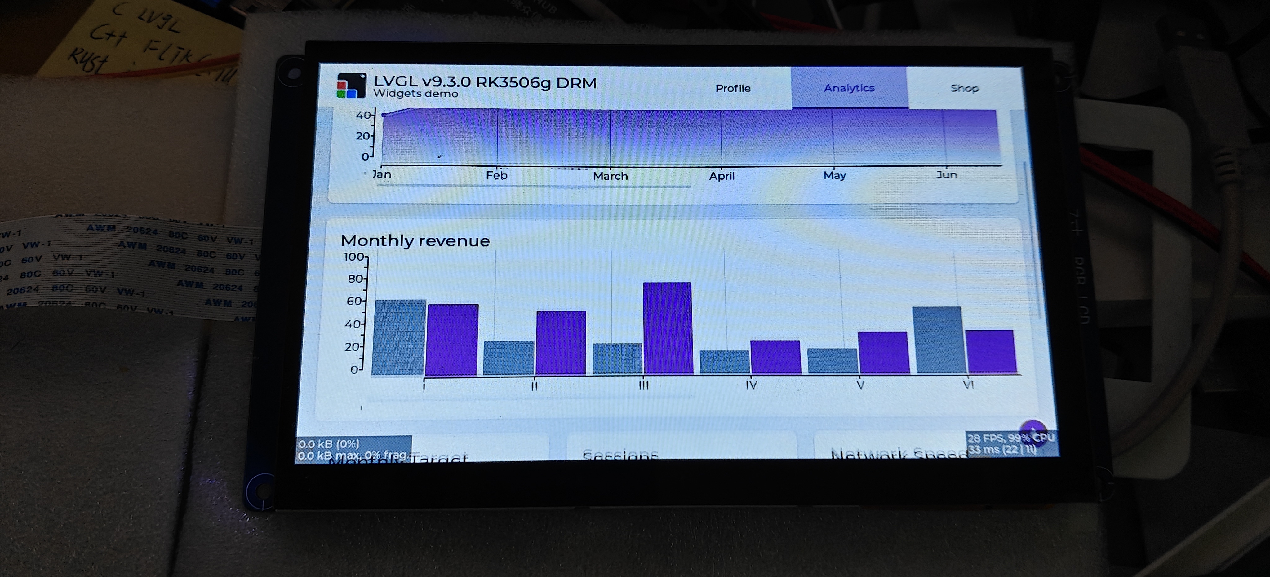

或者./build.sh buildroot-config进入配置
一定注意UBIFS_LEBSIZE=0x1f000默认是UBIFS_LEBSIZE=0x1f800需要修改,不然也会挂载失败,顺便加一下其它软件比如tslib,gdbserver等等
这样内核文件系统修改完毕下面是qt和lvgl

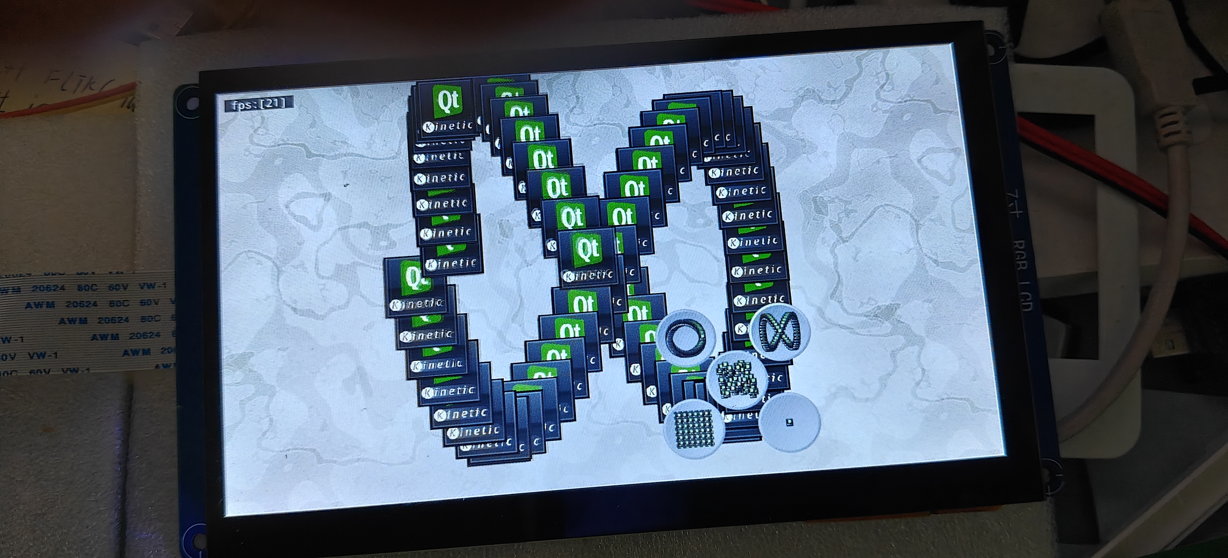

关于Qt修改qt-everywhere-src-5.15.17/qtbase/mkspecs/linux-arm-gnueabi-g++/qmake.conf
# qmake configuration for building with arm-linux-gnueabi-g++
MAKEFILE_GENERATOR      = UNIX
CONFIG                 += incremental
QMAKE_INCREMENTAL_STYLE = sublib
QMAKE_CFLAGS_RELEASE += -O2 -march=armv7-a -mfpu=neon -mfloat-abi=hard
QMAKE_CXXFLAGS_RELEASE += -O2 -march=armv7-a -mfpu=neon -mfloat-abi=hard
include(../common/linux.conf)
include(../common/gcc-base-unix.conf)
include(../common/g++-unix.conf)
QMAKE_LFLAGS += -Wl,-rpath-link,/home/work/work/rk3506g/hdrk3506mini/rk3506_linux6.1_sdk/buildroot/output/rockchip_rk3506/host/arm-buildroot-linux-gnueabihf/sysroot/usr/lib
# modifications to g++.conf
QMAKE_CC                = /home/work/work/rk3506g/hdrk3506mini/rk3506_linux6.1_sdk/buildroot/output/rockchip_rk3506/host/bin/arm-buildroot-linux-gnueabihf-gcc
QMAKE_CXX               = /home/work/work/rk3506g/hdrk3506mini/rk3506_linux6.1_sdk/buildroot/output/rockchip_rk3506/host/bin/arm-buildroot-linux-gnueabihf-g++
QMAKE_LINK              = /home/work/work/rk3506g/hdrk3506mini/rk3506_linux6.1_sdk/buildroot/output/rockchip_rk3506/host/bin/arm-buildroot-linux-gnueabihf-g++
QMAKE_LINK_SHLIB        = /home/work/work/rk3506g/hdrk3506mini/rk3506_linux6.1_sdk/buildroot/output/rockchip_rk3506/host/bin/arm-buildroot-linux-gnueabihf-g++
# modifications to linux.conf
QMAKE_AR                = /home/work/work/rk3506g/hdrk3506mini/rk3506_linux6.1_sdk/buildroot/output/rockchip_rk3506/host/bin/arm-buildroot-linux-gnueabihf-ar cqs
QMAKE_OBJCOPY           = /home/work/work/rk3506g/hdrk3506mini/rk3506_linux6.1_sdk/buildroot/output/rockchip_rk3506/host/bin/arm-buildroot-linux-gnueabihf-objcopy
QMAKE_NM                = /home/work/work/rk3506g/hdrk3506mini/rk3506_linux6.1_sdk/buildroot/output/rockchip_rk3506/host/bin/arm-buildroot-linux-gnueabihf-nm -P
QMAKE_STRIP             = /home/work/work/rk3506g/hdrk3506mini/rk3506_linux6.1_sdk/buildroot/output/rockchip_rk3506/host/bin/arm-buildroot-linux-gnueabihf-strip
load(qt_config)
使用如下配置
../qt-everywhere-src-5.15.17/configure \
-prefix /opt/qt5.15.17arm \
-extprefix /home/work/work/rk3506g/hdrk3506mini/rk3506_linux6.1_sdk/buildroot/output/rockchip_rk3506/target/opt/qt5.15.17arm   \
-hostprefix /home/work/work/rk3506g/qt/hostqt5.15.17arm    \
-sysroot /home/work/work/rk3506g/hdrk3506mini/rk3506_linux6.1_sdk/buildroot/output/rockchip_rk3506/host/arm-buildroot-linux-gnueabihf/sysroot  \
-I /home/work/work/rk3506g/hdrk3506mini/rk3506_linux6.1_sdk/buildroot/output/rockchip_rk3506/host/arm-buildroot-linux-gnueabihf/sysroot/usr/include/libdrm  \
-L /home/work/work/rk3506g/hdrk3506mini/rk3506_linux6.1_sdk/buildroot/output/rockchip_rk3506/host/arm-buildroot-linux-gnueabihf/sysroot/usr/lib \
-confirm-license -opensource \
-release -shared  \
-xplatform linux-arm-gnueabi-g++ \
-qpa linuxfb \
-make libs  \
-pch \
-qt-libjpeg \
-qt-libpng \
-qt-zlib \
-qt-freetype  \
-qt-harfbuzz  \
-qt-pcre  \
-qt-sqlite  \
-alsa \
-gui \
-widgets \
-kms \
-dbus-runtime \
-accessibility \
-nomake examples  -nomake tests  \
-no-sse2 \
-no-cups \
-no-separate-debug-info \
-no-iconv \
-no-opengl \
-no-glib \
-no-pkg-config  \
-no-compile-examples \
-no-xcb \
-no-eglfs \
-skip qtwayland \
-skip qtdoc  \
-skip qttools \
-skip qtwayland \
-skip qtwebengine \
-skip qtwebview \
-skip qtwinextras \
-skip qtx11extras \
-v \
这时候就可以make -j5 ,make install -j5

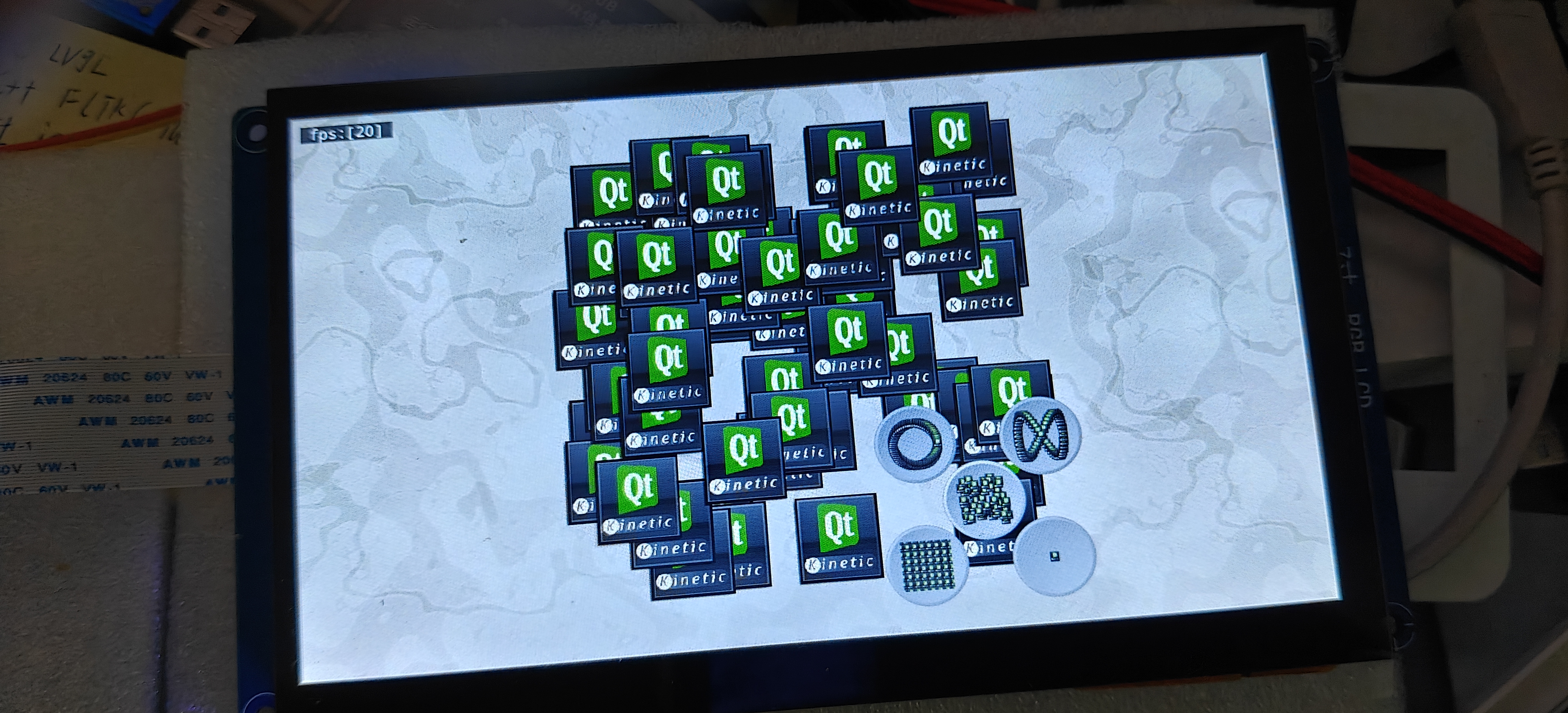

完成之后复制rk3506_linux6.1_sdk/buildroot/output/rockchip_rk3506/target/opt/qt5.15.17arm到/home/work/work/rk3506g/qt/hostqt5.15.17arm
顺便写个qt.conf
[Paths]
Prefix=../qt5.15.17arm
HostPrefix = ..
Sysroot =/home/work/work/rk3506g/hdrk3506mini/rk3506_linux6.1_sdk/buildroot/output/rockchip_rk3506/host/arm-buildroot-linux-gnueabihf/sysroot
# 关键平台插件设置
[Platforms]
LinuxFB = drm
EGLFS = disable
QPA = linuxfb:drm
# DRM专用参数(RK3506优化)
[Drm]
Device = /dev/dri/card0
Atomic = 1
SwapBuffersWait = 1
ForceMultiPlane = 1
顺便删了/home/work/work/rk3506g/hdrk3506mini/rk3506_linux6.1_sdk/buildroot/output/rockchip_rk3506/target/opt/qt5.15.17arm文件夹下的doc,include的文件
顺便写个arm下环境变量设置的shell文件rk3506_linux6.1_sdk/buildroot/output/rockchip_rk3506/target/opt/qt5.15.17arm/
qtsetdrmenv.sh使用drm
#! /bin/bash
# 导出qtdemo的安装目录
export APP_DIR=/opt/qt5.15.17arm
# 指定qt库路径
export LD_LIBRARY_PATH=/opt/qt5.15.17arm/lib:$LD_LIBRARY_PATH
# 指定qt插件路径
export QT_QPA_PLATFORM_PLUGIN_PATH=/opt/qt5.15.17arm/plugins
# 指定显示平台插件,通过QT_QPA_PLATFORM 或者-platform命令行选项指定其他设置
export QT_QPA_PLATFORM=LINUXFB
export QT_QPA_FB_DRM=1
# 鼠标设备
#export QT_QPA_FB_HIDECURSOR=1
# 键盘设备
#export QT_QPA_EVDEV_KEYBOARD_PARAMETERS
# 触摸配置
#export QT_QPA_FB_TSLIB=1
#export QT_QPA_EVDEV_TOUCHSCREEN_PARAMETERS=/dev/input/$eventx
# 字体库
#指定字体库
export QT_QPA_FONTDIR=/opt/fonts
# 屏幕旋转
#rotation=0
#export QT_QPA_PLATFORM=linuxfb:fb=/dev/fb0:rotation=$rotation
#export QT_QPA_FB_FORCE_FULLSCREEN=0
qtsetfbenv.sh使用FB
#! /bin/bash
# 导出qtdemo的安装目录
# 指定qt库路径
# 指定qt插件路径
export QT_QPA_FB_DRM=0
# 鼠标设备
# 键盘设备
# 触摸配置
# 字体库
#指定字体库
# 屏幕旋转
#rotation=0
再去修改rk3506_linux6.1_sdk/buildroot/output/rockchip_rk3506/target/etc/profile
添加
if [ "$USER" = "root" ]; then
    echo "Running as root"
    source /opt/qt5.15.17arm/qtsetdrmenv.sh
fi

关于qt如何显示fps
主窗口中添加
void paintEvent(QPaintEvent *event) override {
        frameCount++;
        QGraphicsView::paintEvent(event);
开个定时器进行计算
void timerOutFPSUI()
        if (etimer.elapsed()  >= 500) {  // 每秒更新
            fps = (frameCount*1000)/etimer.elapsed();
            frameCount = 0;
            etimer.restart();
        if(oldfps!=fps)
            mlable->setText(QString(" fps:[%1] ")
                                    .arg(fps));
            mlable->adjustSize();
            oldfps=fps;
            update();
这样基本其它就完成了,既能fb,也能drm,DRM的cpu使用率竟然比FB下低帧率也就是20到30左右

widget demo下profile帧率700多,analytics帧率只有28

楼主 #4 2025-06-24 16:42:55

CPU占用高,应该是G2D没有搞起来;Qt那个示图跑的QML吧,没有GPU跑QML神仙CPU也吃力,所以帧率低。

搜索了一下,rk的G2D的加速为DRM+RGA ,其中RGA  为2D加速,启用之后拖动视频那个界面CPU使用率90以上,FPS90多,复杂界面还是掉到FPS4到10
好像这个G2D加速很弱

qt那俩不是QML 是QtWidgets,官方的例程

关于QT的帧率,你不操作界面,直接降到0,你操作一下才会马上升高,应该和lvgl的处理方式不一样,这个moveblocks方块的动画可以50多帧,另外一个animatedtiles,qt图标的界面,是0到20多帧,不操作界面就是0帧。

感谢老哥,正常烧录update.img这一个文件就够了,分散烧录很多文件,还不知道咋操作,我烧录update.img这一个,lgvl那些放进SD卡,从SD卡运行应该就可以了吧
