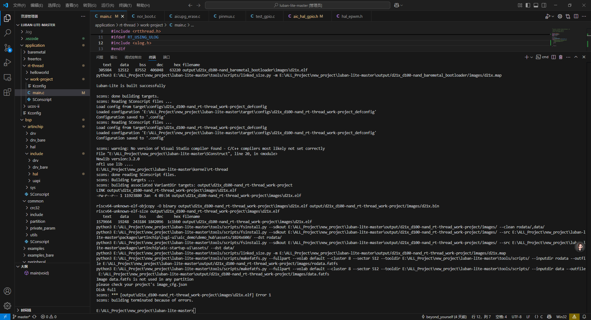

根据help去处理,切换存储工作完成,但是编译出现了以下问题:
scons: warning: No version of Visual Studio compiler found - C/C++ compilers most likely not set correctly
File "E:\ALL_Project\new_project\luban-lite-master\SConstruct", line 20, in <module>
Newlib version:3.2.0
nftl use lib ....
E:\ALL_Project\new_project\luban-lite-master\kernel\rt-thread
scons: done reading SConscript files.
scons: Building targets ...
scons: building associated VariantDir targets: output\d21x_d100-nand_rt-thread_work-project
LINK output\d21x_d100-nand_rt-thread_work-project\images\d21x.elf
-rw-r--r-- 1 11923880 Jan  4 09:34 output\d21x_d100-nand_rt-thread_work-project\images\d21x.elf
riscv64-unknown-elf-objcopy -O binary output\d21x_d100-nand_rt-thread_work-project\images\d21x.elf output/d21x_d100-nand_rt-thread_work-project/images/d21x.bin
riscv64-unknown-elf-size output\d21x_d100-nand_rt-thread_work-project\images\d21x.elf
   text    data     bss     dec     hex filename
1579664   19248  243184 1842096  1c1bb0 output\d21x_d100-nand_rt-thread_work-project\images\d21x.elf
python3 E:\ALL_Project\new_project\luban-lite-master\tools/scripts/fsinstall.py --sdkout E:\ALL_Project\new_project\luban-lite-master\output/d21x_d100-nand_rt-thread_work-project/images/ --clean rodata/,data/
python3 E:\ALL_Project\new_project\luban-lite-master\tools/scripts/fsinstall.py --sdkout E:\ALL_Project\new_project\luban-lite-master\output/d21x_d100-nand_rt-thread_work-project/images/ --src E:\ALL_Project\new_project\luban-lite-master\packages\artinchip\lvgl-ui\aic_demo\demo_hub\assets/1024x600/ --dst rodata/
python3 E:\ALL_Project\new_project\luban-lite-master\tools/scripts/fsinstall.py --sdkout E:\ALL_Project\new_project\luban-lite-master\output/d21x_d100-nand_rt-thread_work-project/images/ --src E:\ALL_Project\new_project\luban-lite-master\packages\artinchip\aic-startup-ui\assets/ --dst data/
python3 E:\ALL_Project\new_project\luban-lite-master\tools/scripts/linked_size.py -m E:\ALL_Project\new_project\luban-lite-master\output/d21x_d100-nand_rt-thread_work-project/images/d21x.map
python3 E:\ALL_Project\new_project\luban-lite-master\tools/scripts/makefatfs.py --fullpart --volab default --cluster 8 --sector 512 --tooldir E:\ALL_Project\new_project\luban-lite-master\tools/scripts/ --inputdir rodata --outfile E:\ALL_Project\new_project\luban-lite-master\output/d21x_d100-nand_rt-thread_work-project/images/rodata.fatfs
python3 E:\ALL_Project\new_project\luban-lite-master\tools/scripts/makefatfs.py --fullpart --volab default --cluster 8 --sector 512 --tooldir E:\ALL_Project\new_project\luban-lite-master\tools/scripts/ --inputdir data --outfile E:\ALL_Project\new_project\luban-lite-master\output/d21x_d100-nand_rt-thread_work-project/images/data.fatfs
Image data.fatfs is not used in any partition
please check your project's image_cfg.json
Disk full
scons: *** [output\d21x_d100-nand_rt-thread_work-project\images\d21x.elf] Error 1
楼主 #4 2026-01-04 09:39:47

#5 2026-01-08 11:14:28
五花肉
注册时间: 2025-02-21
积分: 57
Re: menuconfig的热键以及选项问题
可能是menuconfig 配置的application1 是FATFS 格式,生成的镜像是data.fatfs; 而image_cfg.json 指定data分区烧录文件是data.lfs 二者不匹配导致编译检查生成的data.fatfs 没人使用从而报错。
如果是这个原因的话可以修改menuconfig application1 为LITTLEFS  data.lfs
