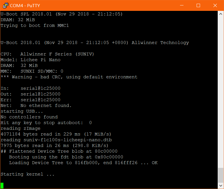

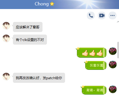

网友 @chong 大神提供的f1c100s mainline linux usb 补丁包,支持usb otg(host & device)
本站下载地址: f1c100s_linux_4_19_patch_by_chong.7z
git clone https://github.com/torvalds/linux.git
cd linux
git reset --hard5e335542de83558e46d28de1008a1c37d5d6679a
patch -p1 < lichee_nano_upstream_patch.patch
ARCH=arm CROSS_COMPILE=arm-linux-gnueabi- make
2018-10-22 更新
大神的补丁下载: lichee_pi_nano_usbok_patch_5e335542de83558e46d.7z
操作步骤:
cd linux
7z x lichee_pi_nano_usbok_patch_5e335542de83558e46d.7z
git reset --hard 5e335542de83558e46d28de1008a1c37d5d6679a
patch -p1 < lichee_pi_nano_usbok_patch_5e335542de83558e46d.patch

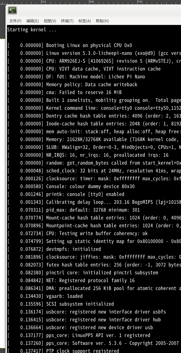

   Loading Device Tree to 816fb000, end 816ffd8e ... OK
[    0.000000] Linux version 4.19.0-rc3-licheepi-nano+ (chong@chong-ThinkPad-X230) (gcc version 7.2.1 20171011 (Linaro GCC 7.2-2017.11)) #14 Wed Sep 12 22:21:00 CST 2018
[    0.000000] random: get_random_bytes called from start_kernel+0x84/0x3f8 with crng_init=0
[    0.000000] Kernel command line: console=ttyS0,115200 root=/dev/mmcblk0p2 rootwait
[    0.000000] Memory: 22676K/32768K available (6144K kernel code, 248K rwdata, 1516K rodata, 1024K init, 239K bss, 10092K reserved, 0K cma-reserved, 0K highmem)

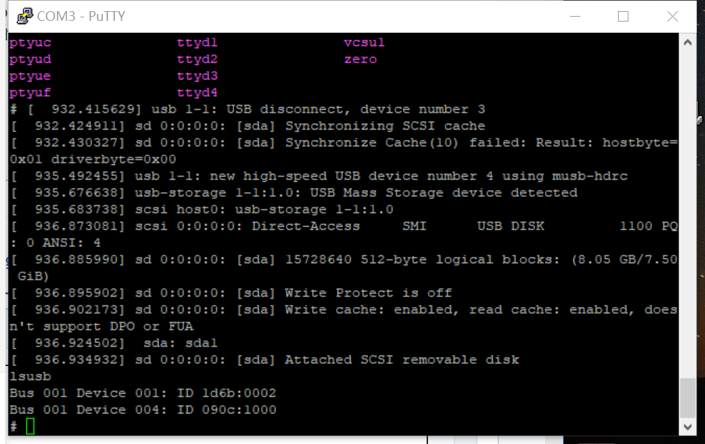

[    1.317842] usb_phy_generic usb_phy_generic.0.auto: usb_phy_generic.0.auto supply vcc not found, using dummy regulator
[    1.328886] usb_phy_generic usb_phy_generic.0.auto: Linked as a consumer to regulator.0
[    1.337872] musb-hdrc musb-hdrc.1.auto: MUSB HDRC host driver
[    1.343802] musb-hdrc musb-hdrc.1.auto: new USB bus registered, assigned bus number 1
[    1.354120] hub 1-0:1.0: USB hub found
[    1.358103] hub 1-0:1.0: 1 port detected

晕哥,问一下@chong大神,帮忙看看C100s usb驱动的问题。
楼主 #20 2018-10-08 09:53:34
已发帖子: 9,423
Re: 网友 @chong 大神提供的f1c100s mainline linux usb 补丁包,支持usb otg(host & device)
在线
楼主 #21 2018-10-08 09:55:33
已发帖子: 9,423

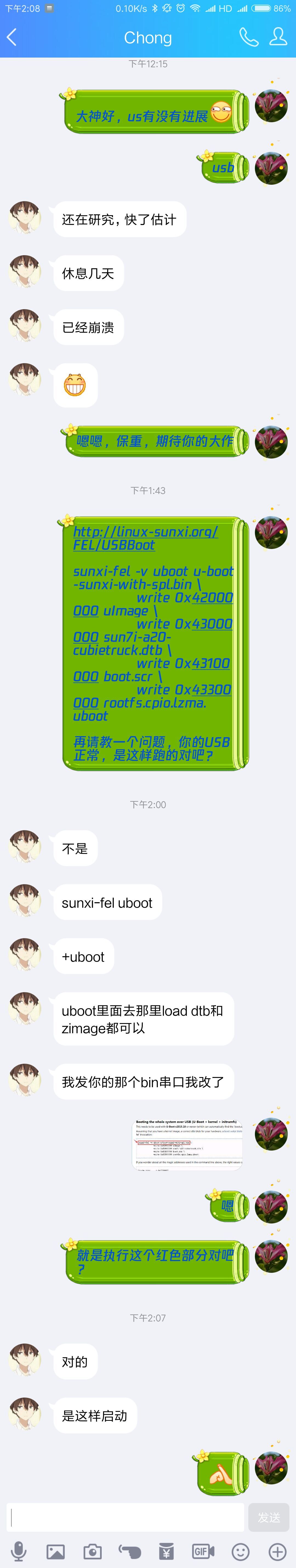

他直接烧到FLASH也不行, 他原来用 sunxi-fel 的 uboot 命令启动系统了,直接绕开了 BROM的 USB初始化.
@ippen 你也试一试这样启动,看USB是否正常.
在线
#22 2018-10-08 10:18:27
ippen
注册时间: 2018-07-22
已发帖子: 345
积分: 339.5
晕倒了,这样没法做产品啊,难道要换芯片?
我试了用 sunxi-fel uboot 方式启动,但到了starting kernel就停住了,不知道@chong是如何操作的

楼主 #38 2018-10-21 22:13:32
已发帖子: 9,423
一个重磅好消息砸来了。
如果 linux 4.19 在 f1c100s 搞定了, 那么 spi nand 也不是问题了,因为已经4.19集成了。

积分: 339.5
最快速的测试报告
打了新的补丁包,4.19的内核启动后,usb device模式直接可用

积分: 339.5
试了usb host,插进U盘,有提示,并且正确显示U盘型号,不过/dev下没找到设备,可能是我编译内核参数的有问题

积分: 339.5
https://whycan.cn/files/members/1028/suniv-f1c100s-licheepi-nano.rar
压缩包里面有dtb,zImage,config三个文件,能识别u盘,插入电脑,会识别为网卡

注册时间: 2018-10-22
已发帖子: 21
十分感谢ippen网友,我刚试过了,可以识别USB设备。下面我将重点检查一下,我以前的工作差在什么地方。

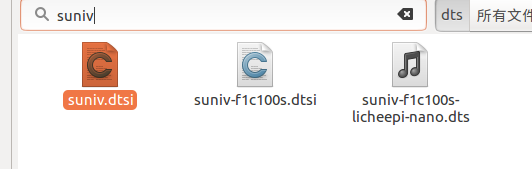

#74 2018-11-29 16:01:56
这是从https://www.kernel.org/下载的4.19.5稳定版。
在arch/arm/boot/dts目录搜到的
文件存在,就是说明提交到主线内核了??
这个.5版的源码是在本帖patch发布之后出的。
我一样打上了patch和config。
编译出来的无法生成dtb,已经确认。
翻了翻上面,看到53楼一样的效果。
不懂得小白都会照着命令输,
本来挺好的.config,搞个make sunxi_defconfig
会不会把配置好的配置给弄不对了....
最近编辑记录 迪卡 (2018-11-29 16:04:26)

问题已解决,开始编译的zimage有5.7M,重新下载又编译一边2.8M,USB正常(device和host),但是在dev/,没有发现设备,正在找原因。15471952191.png

按照上面的补丁说明,将8改成1.果然,
运行的linux4.15.0 在dev下有bus,里面有usb 里面有001.
也就是说usb可以使用。
那么内核编译没啥问题了。接下来,开始调各种io和接口还有usb

jiangming1399 说:
Peter 说:
jiangming1399 说:
花了一点时间对Icenowy的patch和chong的patch进行了比较,结果发现chong的patch包基本上就是在Icenowy的基础上更改了下面的这个文件:
--- ../linux/drivers/clk/sunxi-ng/ccu-suniv.c    2019-01-15 22:48:18.824587965 +0800
+++ drivers/clk/sunxi-ng/ccu-suniv.c    2019-01-23 09:05:17.959348454 +0800
@@ -238,7 +238,7 @@
/* The BSP header file has a CIR_CFG, but no mod clock uses this definition */
static SUNXI_CCU_GATE(usb_phy0_clk,    "usb-phy0",    "osc24M",
-              0x0cc, BIT(8), 0);
+              0x0cc, BIT(1), 0);
static SUNXI_CCU_GATE(dram_ve_clk,    "dram-ve",    "pll-ddr",
               0x100, BIT(0), 0);
理论上将上面这个patch应用到Icenowy的4.14内核中,USB应该也就能跑了。
@jiangming1399 我的4.14内核只修改此处,USB没办法正常运行,请问你用的哪个内核?
内核:https://github.com/Lichee-Pi/linux/tree/nano-4.14-exp
