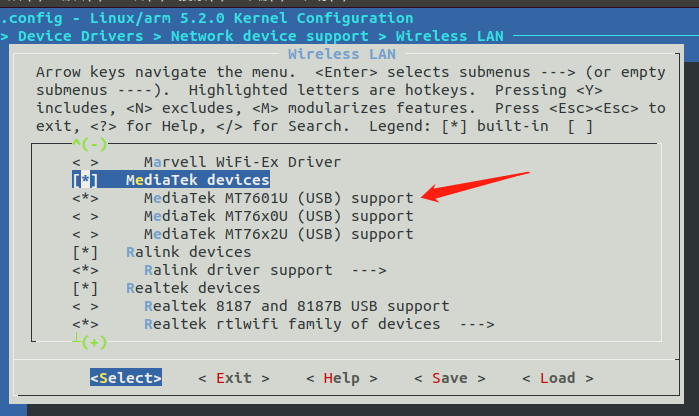

F1C100s USB WLan mt7601u 无法使用
内核版本5.2,Usb Hub可正常使用,U盘可正常读写,但MT7601U无法使用,如下:
[ 303.078266] usb 1-1: new high-speed USB device number 2 using musb-hdrc
[ 303.538247] usb 1-1: reset high-speed USB device number 2 using musb-hdrc
[ 303.721225] mt7601u 1-1:1.0: ASIC revision: 76010001 MAC revision: 76010500
[ 303.729766] mt7601u 1-1:1.0: Direct firmware load for mt7601u.bin failed with error -2
[ 303.739783] mt7601u: probe of 1-1:1.0 failed with error -2
如果网上下载的mt7601u.bin放在/lib/firmware下,效果如下:
[ 15.398106] usb 1-1: new high-speed USB device number 2 using musb-hdrc
[ 15.858130] usb 1-1: reset high-speed USB device number 2 using musb-hdrc
[ 16.041016] mt7601u 1-1:1.0: ASIC revision: 76010001 MAC revision: 76010500
[ 16.056134] mt7601u 1-1:1.0: Firmware Version: 0.1.00 Build: 7640 Build time: 201302052146____
[ 16.487139] mt7601u 1-1:1.0: EEPROM ver:0c fae:00
[ 16.661569] musb-hdrc musb-hdrc.1.auto: Babble
[ 16.968392] mt7601u 1-1:1.0: Warning: mt7601u_mcu_wait_resp retrying
[ 17.278177] mt7601u 1-1:1.0: Warning: mt7601u_mcu_wait_resp retrying
[ 17.588129] mt7601u 1-1:1.0: Warning: mt7601u_mcu_wait_resp retrying
[ 17.898136] mt7601u 1-1:1.0: Warning: mt7601u_mcu_wait_resp retrying
[ 18.208111] mt7601u 1-1:1.0: Warning: mt7601u_mcu_wait_resp retrying
[ 18.214487] mt7601u 1-1:1.0: Error: mt7601u_mcu_wait_resp timed out
[ 21.618099] mt7601u 1-1:1.0: Vendor request req:07 off:0080 failed:-110
[ 25.018103] mt7601u 1-1:1.0: Vendor request req:02 off:0080 failed:-110
[ 28.418132] mt7601u 1-1:1.0: Vendor request req:02 off:0080 failed:-110
[ 28.424933] mt7601u: probe of 1-1:1.0 failed with error -110
[ 28.434376] usb 1-1: USB disconnect, device number 2
内核config的配置如下:
MT7601U_Driver_Config
不知哪里配置不对,请各位大神指教。
隐隐赶脚你的usb走线受干扰了.
楼主 #3 2019-12-27 00:00:21
weilianyg
注册时间: 2019-11-20
Re: F1C100s USB WLan mt7601u 无法使用
隐隐赶脚你的usb走线受干扰了.
确实是板子问题,遇到了几个问题,都是硬件问题,崩溃。
