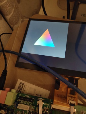

A33主线Linux跑起OpenGL/ES
A33的GPU有两个方向,开源的Lima和非开源的全志OpenGL库
Lima+Mesa3D
LIMA只需要在内核选上LIMA和SUN4I的DRM驱动即可
Mesa3D可以在buildroot选上
不过最后我运行mesa的demo直接出错也找不到问题就放弃了,不知道是哪里的问题,网上教程太少不会玩。
这时候我切到第二个方案:
其实教程就是 https://github.com/mripard/sunxi-mali
但是这里有个坑(我选的fbdev的库),导致一运行malitest就出错(malitest可以自己编一个 https://github.com/linux-sunxi/sunxi-mali/tree/master/test
查资料得到了信息
  1. Must enable DRM_FBDEV_LEAK_PHYS_SMEM from kernel
  2. set drm_leak_fbdev_smem on compile time (for some reason, passing in command line did not help) in drm_fb_helper.c
  3. use latest r8p1
这回终于跑起来了

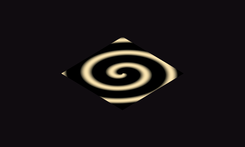

malitest和QT的OpenGL例子都运行正常
对了,最好在buildroot里选上sunxi-mali-mainline,这样它会自动给你生成一个启动时加载mali.ko的脚本。
当然,自己modprobe也是可以的

运行malitest的结果,可以验证是否正确
EGL Version: "1.4 Linux-r8p1-00rel0"
EGL Vendor: "ARM"
EGL Extensions: "EGL_KHR_image EGL_KHR_image_base EGL_KHR_image_pixmap EGL_KHR_gl_texture_2D_image EGL_KHR_gl_texture_cubemap_image EGL_KHR_gl_renderbuffer_image EGL_KHR_reusable_sync EGL_KHR_fence_sync EGL_KHR_lock_surface EGL_KHR_lock_surface2 EGL_EXT_create_context_robustness EGL_ANDROID_blob_cache EGL_KHR_create_context EGL_KHR_partial_update EGL_KHR_create_context_no_error "
Surface size: 1024x600
GL Vendor: "ARM"
GL Renderer: "Mali-400 MP"
GL Version: "OpenGL ES 2.0 "mali450-r5p1-01rel0-lollipop-233-g52c929d""
GL Extensions: "GL_OES_texture_npot GL_OES_vertex_array_object GL_OES_compressed_ETC1_RGB8_texture GL_EXT_compressed_ETC1_RGB8_sub_texture GL_OES_standard_derivatives GL_OES_EGL_image GL_OES_depth24 GL_ARM_rgba8 GL_ARM_mali_shader_binary GL_OES_depth_texture GL_OES_packed_depth_stencil GL_EXT_texture_format_BGRA8888 GL_OES_vertex_half_float GL_EXT_blend_minmax GL_OES_EGL_image_external GL_OES_EGL_sync GL_OES_rgb8_rgba8 GL_EXT_multisampled_render_to_texture GL_EXT_discard_framebuffer GL_OES_get_program_binary GL_ARM_mali_program_binary GL_EXT_shader_texture_lod GL_EXT_robustness GL_OES_depth_texture_cube_map GL_KHR_debug GL_ARM_shader_framebuffer_fetch GL_ARM_shader_framebuffer_fetch_depth_stencil GL_OES_mapbuffer GL_KHR_no_error"

https://wiki.maemo.org/SimpleGL_example
/* Created by exoticorn ( http://talk.maemo.org/showthread.php?t=37356 )
 * edited and commented by André Bergner [endboss]
 * libraries needed:   libx11-dev, libgles2-dev
 * compile with:   g++  -lX11 -lEGL -lGLESv2  egl-example.cpp
#include  <iostream>
#include  <cstdlib>
#include  <cstring>
using namespace std;
#include  <cmath>
#include  <sys/time.h>
#include  <X11/Xlib.h>
#include  <X11/Xatom.h>
#include  <X11/Xutil.h>
#include  <GLES2/gl2.h>
#include  <EGL/egl.h>
const char vertex_src [] =
   attribute vec4        position;       \
   varying mediump vec2  pos;            \
   uniform vec4          offset;         \
   void main()                           \
      gl_Position = position + offset;   \
      pos = position.xy;                 \
const char fragment_src [] =
   uniform mediump float   phase;                      \
   void  main()                                        \
      gl_FragColor  =  vec4( 1., 0.9, 0.7, 1.0 ) *     \
        cos( 30.*sqrt(pos.x*pos.x + 1.5*pos.y*pos.y)   \
             + atan(pos.y,pos.x) - phase );            \
//  some more formulas to play with...
//      cos( 20.*(pos.x*pos.x + pos.y*pos.y) - phase );
//      cos( 20.*sqrt(pos.x*pos.x + pos.y*pos.y) + atan(pos.y,pos.x) - phase );
//      cos( 30.*sqrt(pos.x*pos.x + 1.5*pos.y*pos.y - 1.8*pos.x*pos.y*pos.y)
//            + atan(pos.y,pos.x) - phase );
void
print_shader_info_log (
   GLuint  shader      // handle to the shader
   GLint  length;
   glGetShaderiv ( shader , GL_INFO_LOG_LENGTH , &length );
   if ( length ) {
      char* buffer  =  new char [ length ];
      glGetShaderInfoLog ( shader , length , NULL , buffer );
      cout << "shader info: " <<  buffer << flush;
      delete [] buffer;
      GLint success;
      glGetShaderiv( shader, GL_COMPILE_STATUS, &success );
      if ( success != GL_TRUE )   exit ( 1 );
GLuint
load_shader (
   const char  *shader_source,
   GLenum       type
   GLuint  shader = glCreateShader( type );
   glShaderSource  ( shader , 1 , &shader_source , NULL );
   glCompileShader ( shader );
   print_shader_info_log ( shader );
   return shader;
Display    *x_display;
Window      win;
EGLDisplay  egl_display;
EGLContext  egl_context;
EGLSurface  egl_surface;
GLfloat
   norm_x    =  0.0,
   norm_y    =  0.0,
   offset_x  =  0.0,
   offset_y  =  0.0,
   p1_pos_x  =  0.0,
   p1_pos_y  =  0.0;
GLint
   phase_loc,
   offset_loc,
   position_loc;
bool        update_pos = false;
const float vertexArray[] = {
   0.0,  0.5,  0.0,
  -0.5,  0.0,  0.0,
   0.0, -0.5,  0.0,
   0.5,  0.0,  0.0,
   0.0,  0.5,  0.0
void  render()
   static float  phase = 0;
   static int    donesetup = 0;
   static XWindowAttributes gwa;
   //// draw
   if ( !donesetup ) {
      XGetWindowAttributes ( x_display , win , &gwa );
      glViewport ( 0 , 0 , gwa.width , gwa.height );
      glClearColor ( 0.08 , 0.06 , 0.07 , 1.);    // background color
      donesetup = 1;
   glClear ( GL_COLOR_BUFFER_BIT );
   glUniform1f ( phase_loc , phase );  // write the value of phase to the shaders phase
   phase  =  fmodf ( phase + 0.5f , 2.f * 3.141f );    // and update the local variable
   if ( update_pos ) {  // if the position of the texture has changed due to user action
      GLfloat old_offset_x  =  offset_x;
      GLfloat old_offset_y  =  offset_y;
      offset_x  =  norm_x - p1_pos_x;
      offset_y  =  norm_y - p1_pos_y;
      p1_pos_x  =  norm_x;
      p1_pos_y  =  norm_y;
      offset_x  +=  old_offset_x;
      offset_y  +=  old_offset_y;
      update_pos = false;
   glUniform4f ( offset_loc  ,  offset_x , offset_y , 0.0 , 0.0 );
   glVertexAttribPointer ( position_loc, 3, GL_FLOAT, false, 0, vertexArray );
   glEnableVertexAttribArray ( position_loc );
   glDrawArrays ( GL_TRIANGLE_STRIP, 0, 5 );
   eglSwapBuffers ( egl_display, egl_surface );  // get the rendered buffer to the screen
int  main()
   ///////  the X11 part  //////////////////////////////////////////////////////////////////
   // in the first part the program opens a connection to the X11 window manager
   x_display = XOpenDisplay ( NULL );   // open the standard display (the primary screen)
   if ( x_display == NULL ) {
      cerr << "cannot connect to X server" << endl;
      return 1;
   Window root  =  DefaultRootWindow( x_display );   // get the root window (usually the whole screen)
   XSetWindowAttributes  swa;
   swa.event_mask  =  ExposureMask | PointerMotionMask | KeyPressMask;
   win  =  XCreateWindow (   // create a window with the provided parameters
              x_display, root,
              0, 0, 800, 480,   0,
              CopyFromParent, InputOutput,
              CopyFromParent, CWEventMask,
              &swa );
   XSetWindowAttributes  xattr;
   Atom  atom;
   int   one = 1;
   xattr.override_redirect = False;
   XChangeWindowAttributes ( x_display, win, CWOverrideRedirect, &xattr );
   atom = XInternAtom ( x_display, "_NET_WM_STATE_FULLSCREEN", True );
   XChangeProperty (
      x_display, win,
      XInternAtom ( x_display, "_NET_WM_STATE", True ),
      XA_ATOM,  32,  PropModeReplace,
      (unsigned char*) &atom,  1 );
   XChangeProperty (
      x_display, win,
      XInternAtom ( x_display, "_HILDON_NON_COMPOSITED_WINDOW", False ),
      XA_INTEGER,  32,  PropModeReplace,
      (unsigned char*) &one,  1);
   XWMHints hints;
   hints.input = True;
   hints.flags = InputHint;
   XSetWMHints(x_display, win, &hints);
   XMapWindow ( x_display , win );             // make the window visible on the screen
   XStoreName ( x_display , win , "GL test" ); // give the window a name
   //// get identifiers for the provided atom name strings
   Atom wm_state   = XInternAtom ( x_display, "_NET_WM_STATE", False );
   Atom fullscreen = XInternAtom ( x_display, "_NET_WM_STATE_FULLSCREEN", False );
   XEvent xev;
   memset ( &xev, 0, sizeof(xev) );
   xev.type                 = ClientMessage;
   xev.xclient.window       = win;
   xev.xclient.message_type = wm_state;
   xev.xclient.format       = 32;
   xev.xclient.data.l[0]    = 1;
   xev.xclient.data.l[1]    = fullscreen;
   XSendEvent (                // send an event mask to the X-server
      x_display,
      DefaultRootWindow ( x_display ),
      False,
      SubstructureNotifyMask,
      &xev );
   ///////  the egl part  //////////////////////////////////////////////////////////////////
   //  egl provides an interface to connect the graphics related functionality of openGL ES
   //  with the windowing interface and functionality of the native operation system (X11
   //  in our case.
   egl_display  =  eglGetDisplay( (EGLNativeDisplayType) x_display );
   if ( egl_display == EGL_NO_DISPLAY ) {
      cerr << "Got no EGL display." << endl;
      return 1;
   if ( !eglInitialize( egl_display, NULL, NULL ) ) {
      cerr << "Unable to initialize EGL" << endl;
      return 1;
   EGLint attr[] = {       // some attributes to set up our egl-interface
      EGL_BUFFER_SIZE, 16,
      EGL_RENDERABLE_TYPE,
      EGL_OPENGL_ES2_BIT,
      EGL_NONE
   EGLConfig  ecfg;
   EGLint     num_config;
   if ( !eglChooseConfig( egl_display, attr, &ecfg, 1, &num_config ) ) {
      cerr << "Failed to choose config (eglError: " << eglGetError() << ")" << endl;
      return 1;
   if ( num_config != 1 ) {
      cerr << "Didn't get exactly one config, but " << num_config << endl;
      return 1;
   egl_surface = eglCreateWindowSurface ( egl_display, ecfg, win, NULL );
   if ( egl_surface == EGL_NO_SURFACE ) {
      cerr << "Unable to create EGL surface (eglError: " << eglGetError() << ")" << endl;
      return 1;
   //// egl-contexts collect all state descriptions needed required for operation
   EGLint ctxattr[] = {
      EGL_CONTEXT_CLIENT_VERSION, 2,
      EGL_NONE
   egl_context = eglCreateContext ( egl_display, ecfg, EGL_NO_CONTEXT, ctxattr );
   if ( egl_context == EGL_NO_CONTEXT ) {
      cerr << "Unable to create EGL context (eglError: " << eglGetError() << ")" << endl;
      return 1;
   //// associate the egl-context with the egl-surface
   eglMakeCurrent( egl_display, egl_surface, egl_surface, egl_context );
   ///////  the openGL part  ///////////////////////////////////////////////////////////////
   GLuint vertexShader   = load_shader ( vertex_src , GL_VERTEX_SHADER  );     // load vertex shader
   GLuint fragmentShader = load_shader ( fragment_src , GL_FRAGMENT_SHADER );  // load fragment shader
   GLuint shaderProgram  = glCreateProgram ();                 // create program object
   glAttachShader ( shaderProgram, vertexShader );             // and attach both...
   glAttachShader ( shaderProgram, fragmentShader );           // ... shaders to it
   glLinkProgram ( shaderProgram );    // link the program
   glUseProgram  ( shaderProgram );    // and select it for usage
   //// now get the locations (kind of handle) of the shaders variables
   position_loc  = glGetAttribLocation  ( shaderProgram , "position" );
   phase_loc     = glGetUniformLocation ( shaderProgram , "phase"    );
   offset_loc    = glGetUniformLocation ( shaderProgram , "offset"   );
   if ( position_loc < 0  ||  phase_loc < 0  ||  offset_loc < 0 ) {
      cerr << "Unable to get uniform location" << endl;
      return 1;
   const float
      window_width  = 800.0,
      window_height = 480.0;
   //// this is needed for time measuring  -->  frames per second
   struct  timezone  tz;
   timeval  t1, t2;
   gettimeofday ( &t1 , &tz );
   int  num_frames = 0;
   bool quit = false;
   while ( !quit ) {    // the main loop
      while ( XPending ( x_display ) ) {   // check for events from the x-server
         XEvent  xev;
         XNextEvent( x_display, &xev );
         if ( xev.type == MotionNotify ) {  // if mouse has moved
//            cout << "move to: << xev.xmotion.x << "," << xev.xmotion.y << endl;
            GLfloat window_y  =  (window_height - xev.xmotion.y) - window_height / 2.0;
            norm_y            =  window_y / (window_height / 2.0);
            GLfloat window_x  =  xev.xmotion.x - window_width / 2.0;
            norm_x            =  window_x / (window_width / 2.0);
            update_pos = true;
         if ( xev.type == KeyPress )   quit = true;
      render();   // now we finally put something on the screen
      if ( ++num_frames % 100 == 0 ) {
         gettimeofday( &t2, &tz );
         float dt  =  t2.tv_sec - t1.tv_sec + (t2.tv_usec - t1.tv_usec) * 1e-6;
         cout << "fps: " << num_frames / dt << endl;
         num_frames = 0;
         t1 = t2;
//      usleep( 1000*10 );
   ////  cleaning up...
   eglDestroyContext ( egl_display, egl_context );
   eglDestroySurface ( egl_display, egl_surface );
   eglTerminate      ( egl_display );
   XDestroyWindow    ( x_display, win );
   XCloseDisplay     ( x_display );
编译指令:
g++ -o test4 test4.c -lX11 -lGL -lEGL
