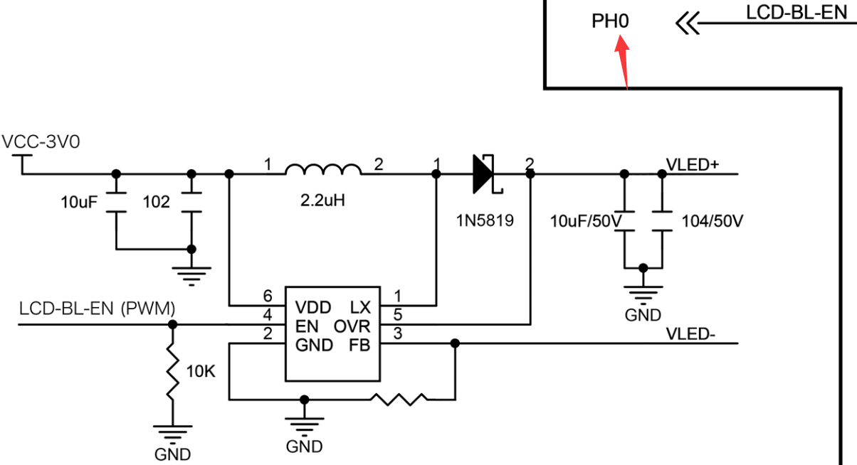

A33/X3 Linux 5.0 控制 LCD 背光
硬件上 PWM0 PH0 控制 LCD 背光
楼主 #2 2020-04-13 19:48:38
X3
注册时间: 2020-04-08
已发帖子: 85
积分: 68.5
Re: A33/X3 Linux 5.0 控制 LCD 背光
ARCH=arm make memuconfig 开启以下配置:
CONFIG_BACKLIGHT_LCD_SUPPORT=y
CONFIG_BACKLIGHT_PWM=y
楼主 #3 2020-04-13 19:55:08
X3
注册时间: 2020-04-08
已发帖子: 85
积分: 68.5
dts 修改:
        backlight: backlight {
                compatible = "pwm-backlight";
                pwms = <&pwm 0 50000 PWM_POLARITY_INVERTED>;
                brightness-levels = <0 1 2 4 8 16 32 64 128 255>;
                default-brightness-level = <9>;
&pwm {
        pinctrl-names = "default";
        pinctrl-0 = <&pwm0_pin>;
楼主 #4 2020-04-13 19:57:55
X3
注册时间: 2020-04-08
已发帖子: 85
积分: 68.5
用户层控制亮度:
echo 0 > /sys/class/backlight/backlight/brightness
echo 1 > /sys/class/backlight/backlight/brightness
echo 9 > /sys/class/backlight/backlight/brightness
