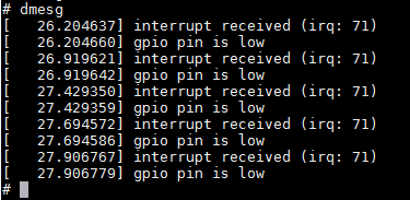

dmesg
[ 26.204637] interrupt received (irq: 71)
[ 26.204660] gpio pin is low
[ 26.919621] interrupt received (irq: 71)
[ 26.919642] gpio pin is low
[ 27.429350] interrupt received (irq: 71)
[ 27.429359] gpio pin is low
[ 27.694572] interrupt received (irq: 71)
[ 27.694586] gpio pin is low
[ 27.906767] interrupt received (irq: 71)
[ 27.906779] gpio pin is low
把PG0 IO脚下拉就会进入中断, 输出上面的信息.
