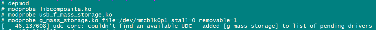

F1C100S TF启动,能否再使用USB虚拟U盘功能
电脑复制图片到板子虚拟的U盘,即TF卡的一个分区

肯定是可以的,地址不要有重叠

不知道哪里的问题

[22:49:52:591]# modprobe libcomposite.ko
[22:49:52:592][ 77.033133] libcomposite: exports duplicate symbol usb_os_desc_prepare_interf_dir (owned by kernel)
[22:49:52:598][ 77.048711] libcomposite: exports duplicate symbol usb_os_desc_prepare_interf_dir (owned by kernel)
[22:49:52:623]modprobe: can't load module libcomposite.ko (libcomposite.ko): invalid module format
[22:50:47:285]# modprobe usb_f_mass_storage.ko
[22:50:47:285][ 131.726289] libcomposite: exports duplicate symbol usb_os_desc_prepare_interf_dir (owned by kernel)
[22:50:47:294][ 131.740730] libcomposite: exports duplicate symbol usb_os_desc_prepare_interf_dir (owned by kernel)
[22:50:47:326]modprobe: can't load module libcomposite (libcomposite.ko): invalid module format
[22:51:07:690]# modprobe g_mass_storage.ko file=/dev/mmcblk0p1 stall=0 removable=1
[22:51:07:690][ 152.134244] libcomposite: exports duplicate symbol usb_os_desc_prepare_interf_dir (owned by kernel)
[22:51:07:702][ 152.149863] libcomposite: exports duplicate symbol usb_os_desc_prepare_interf_dir (owned by kernel)
[22:51:07:730]modprobe: can't load module libcomposite (libcomposite.ko): invalid module format
[22:51:19:891]# [ 164.325223] random: crng init done
