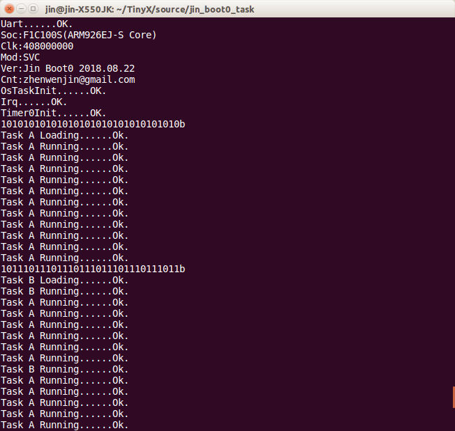

100s自己写的boot程序fel加载到sram正常运行,烧到flash不正常

利用下面fel命令或者jlink加载到sram正常运行:
        sudo sunxi-fel -p write 0 jin_boot0.bin
        sudo sunxi-fel exec 0x00000000
loadbin jin_boot0.bin,0
setpc 0
然后利用mksunxi加入全志头部
mksunxi/mksunxi jin_boot0.bin
bootloader size= e59ff200
The bootloader head has been fixed
烧写到flash
sunxi-fel -p spiflash-write 0 jin_boot0.bin
100% [================================================]     6 kB,   77.5 kB/s
重启brom跑到fel模式了
